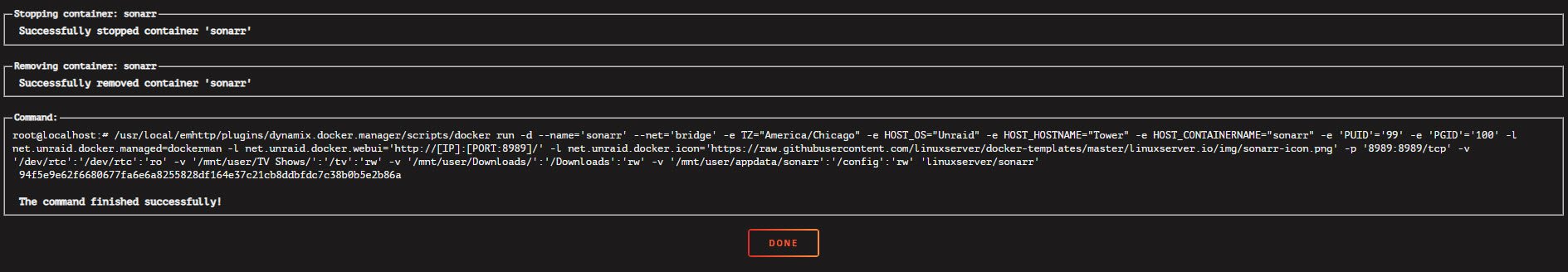

1 hour ago, Squid said:
The docker run command will show exactly what is wrong
root@localhost:# /usr/local/emhttp/plugins/dynamix.docker.manager/scripts/docker run -d --name='binhex-sonarr' --net='bridge' -e TZ="Europe/London" -e HOST_OS="Unraid" -e 'UMASK'='000' -e 'PUID'='99' -e 'PGID'='100' -p '9897:9897/tcp' -p '8989:8989/tcp' -v '/mnt/user/Downloads/':'/data':'rw' -v '/mnt/user/Media/TV/':'/media':'rw' -v '/mnt/user/appdata/binhex-sonarr':'/config':'rw' 'binhex/arch-sonarr'
ac4acd4da0a9ffb00b7bb06a7327d16a7a0e15d11ee716eac0230a3a9d9badab
docker: Error response from daemon: driver failed programming external connectivity on endpoint binhex-sonarr (708ec04199f30905cdcdfdf7fb7cba2293aef50da4f9ebc405c4691e0ed73e74): Bind for 0.0.0.0:8989 failed: port is already allocated.
The command failed.
One of your currently running containers is already using port 8989
Ah, I had it running through binhex-deluge for the vpn. I've now removed the port from the setup, but getting the following error now:
root@localhost:# /usr/local/emhttp/plugins/dynamix.docker.manager/scripts/docker create --name='binhex-sonarr' --net='container:binhex-delugevpn' -e TZ="Europe/London" -e HOST_OS="Unraid" -e 'UMASK'='000' -e 'PUID'='99' -e 'PGID'='100' -p '9897:9897/tcp' -v '/mnt/user/Downloads/':'/data':'rw' -v '/mnt/user/Media/TV/':'/media':'rw' -v '/mnt/user/appdata/binhex-sonarr':'/config':'rw' 'binhex/arch-sonarr'
Error response from daemon: conflicting options: port publishing and the container type network mode
The command failed.

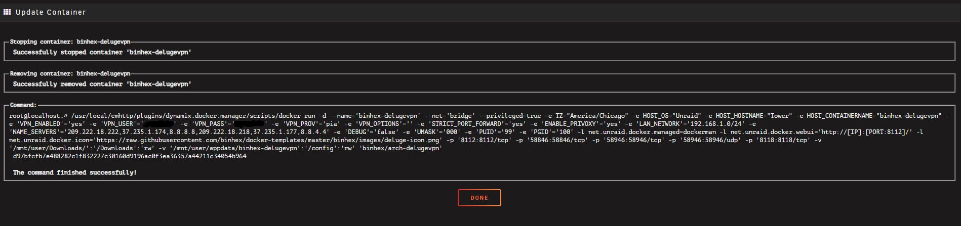

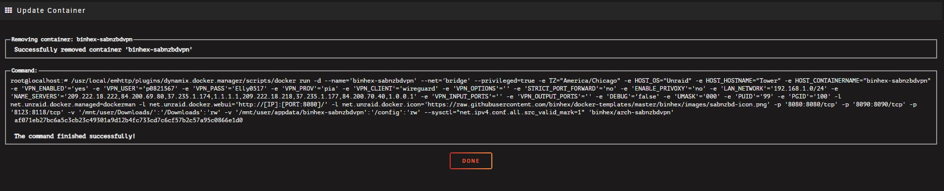

post the docker run command for sonarr, delugevpn, and sabnzbd. Be sure to redact passwords if they show up.
Sorry, here you go.
Thanks!

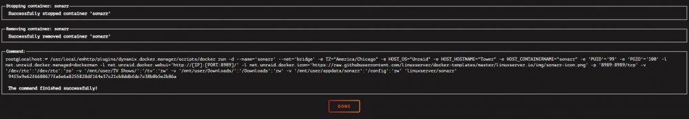

Getting an epic fail with latest sonarr image (3.0.8.1507-1-01)-

Reverting to 3.0.7.1477-1-01 corrects the problem.
Docker run-
root@localhost:# /usr/local/emhttp/plugins/dynamix.docker.manager/scripts/docker run -d --name='binhex-sonarr' --net='bridge' -e TZ="America/New_York" -e HOST_OS="Unraid" -e HOST_HOSTNAME="Brunnhilde" -e HOST_CONTAINERNAME="binhex-sonarr" -e 'UMASK'='000' -e 'PUID'='99' -e 'PGID'='100' -l net.unraid.docker.managed=dockerman -l net.unraid.docker.webui='http://[IP]:[PORT:8989]/' -l net.unraid.docker.icon='https://raw.githubusercontent.com/binhex/docker-templates/master/binhex/images/sonarr-icon.png' -p '8989:8989/tcp' -p '9897:9897/tcp' -v '/mnt/user/qbit/':'/data':'rw' -v '/mnt/user/Media/XBMC/TVTorrents/':'/media':'rw' -v '/mnt/user/Media/XBMC/TVTorrents/.RecycleBin':'/Recycle_Bin':'rw' -v '/mnt/user/appdata/binhex-sonarr-v3':'/config':'rw' 'binhex/arch-sonarr:latest'
a8757f4762952c381937aae30f3b4fa3ecd0debb93e4de312606409d1aad69bf
The command finished successfully!

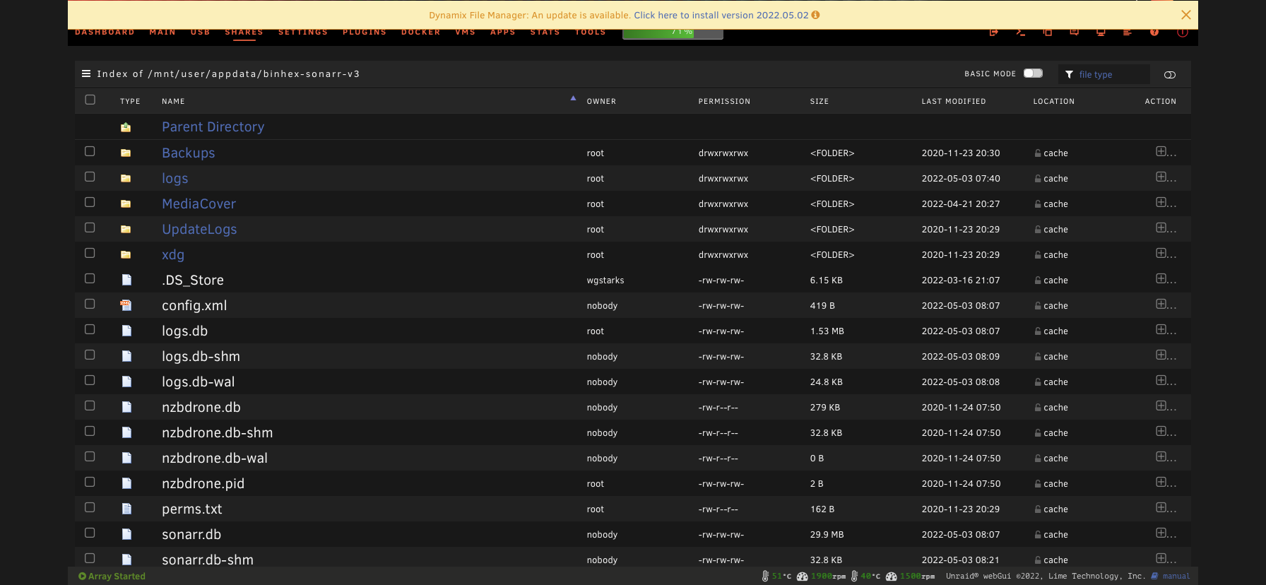

I posted regarding this issue on the Sonarr forum and got a reply back that the Sonarr app was not able to write to logs.db. I changed the permissions for this file and it fixed the issue. The original permissions were owner:read/write group:read only others:read only. New permissions owner:read/write group:read/write and others:read/write. I noticed that logs.db has root as the owner while most of the other files are owned by nobody. This doesn’t seem correct to me and I suspect that that is the real problem since Sonarr is running as nobody.
Shouldn't the owner for logs.db be nobody as well? This is a little outside my experience since I usually avoid making changes to permissions and owners.
Edited by wgstarks
Typo
indeed!, all files and folders in the /config folder should be set to owner nobody group users, the ONLY exception to this is the supervisord.log files, which are written as root, as supervisor is running as root user.
im quite surprised it was file permissions in the end, as it still doesnt explain why it worked on the rollback to the previous version, that makes NO sense to me whatsoever! as you arent rolling back any files in /config, maybe the previous version doesnt need to write to the db and thus doesnt actually care its read only *shrug*.
What about perms.txt and nzbdrone.pid? I see that both those files are also currently owned by root.
