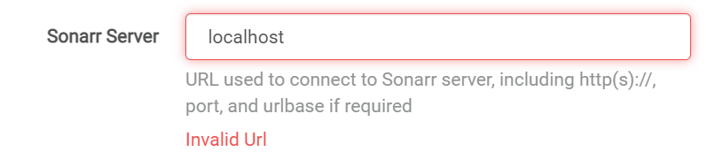

A couple of days ago, something happened and I could no longer access the WebUI for Radarr, Sonarr and Prowler. I had not made any changes to the system, though there were updates. I originally set them up to run through delugeVPN, and I eventually realised that I needed to add the arrs ports to 'VPN_INPUT_PORTS'. So that got me access to the WebUI again.
Now, for some reason, Sonarr (and Radarr) can no longer access the indexers via Prowlarr. The indexers work fine in Prowlarr, but the connection times out when Sonarr and Radarr try to connect. Can anyone advise? As far as I can tell, everything is set up correctly.

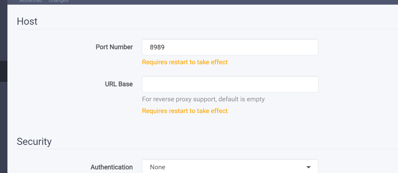

Is that the part about localhost? I dont seem to have a host section in the container config:
It's not defined in the container, it's defined in the application web UI, I e. Sonarr
Sent from my CLT-L09 using Tapatalk
Would that be the 'URL Base'?

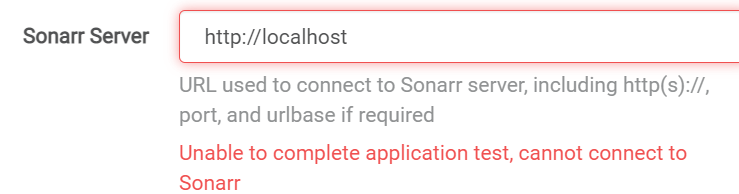

Sorry my bad, I think prowlarr works differently as it connects to sonarr, radarr etc not the other way around. So you need to ensure in prowlarr web UI the settings/apps/sonarr is set to use localhost for the 'sonarr server' field, same for the other arrs.
I'm not having much luck here...
I also tried 'http://localhost:8989' but when pressing the test button, it just ran and never completed and I had to cancel out of the settings.

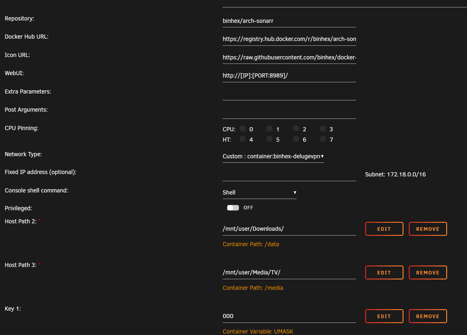

Are you sure Prowlarr and Sonarr are both using delugevpn network? Screenshot please
localhost won't work for docker, use IP:PORT
EDIT: sorry just tracked up and saw its running through deluge-vpn, you have additional config that binhex will help with

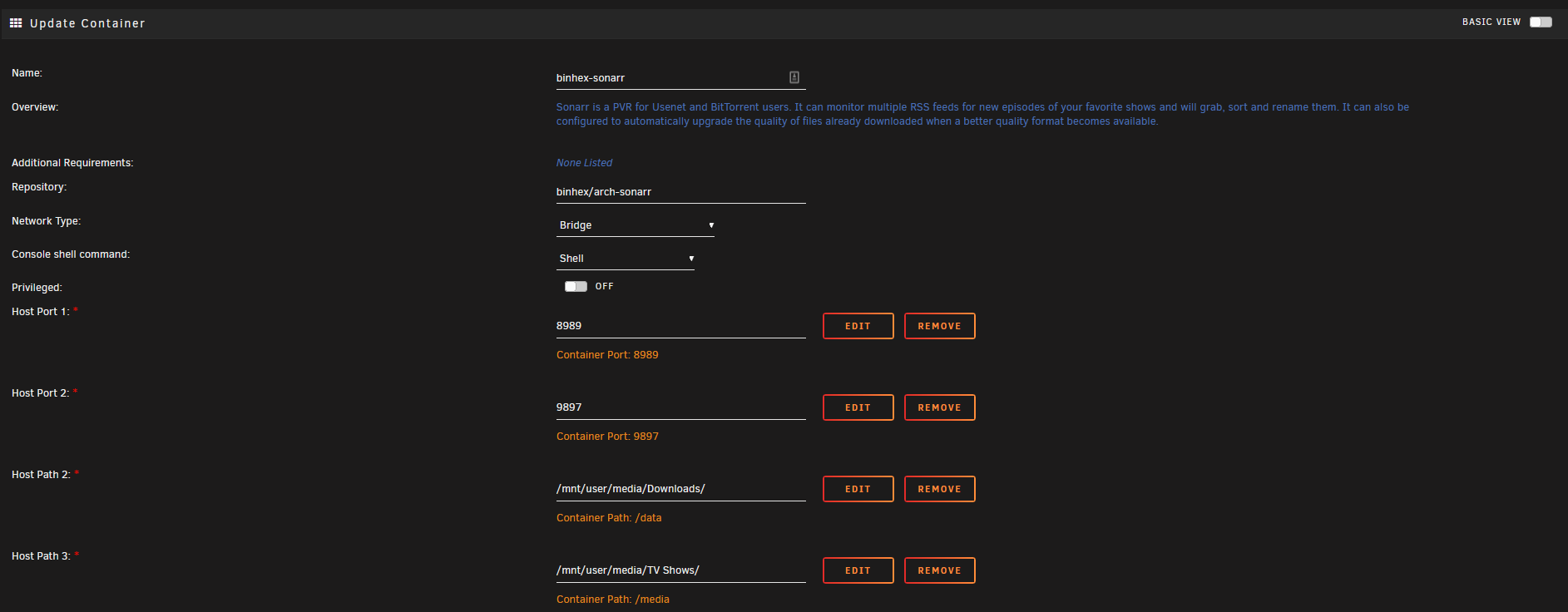

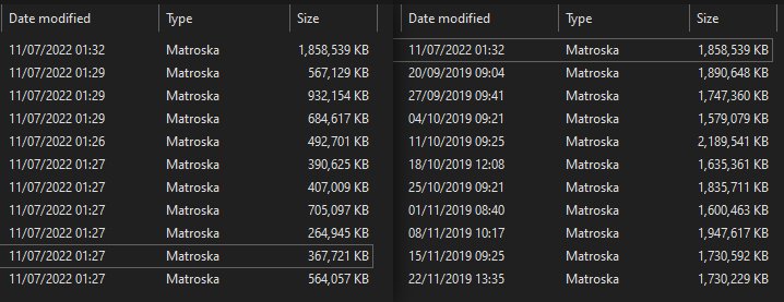

A season of Mr Inbetween had finished downloading with Deluge and then was moved into its season folder. However the files were not fully transferred, only portions of it.
As per screenshot I attached, on the left side is how it was left. Note here is that this wasn't shortly after the download, this was many hours afterwards - my Discord notification already alerted me at that point, also hours ago, that the import had finished.
I moved over the original files left in the downloads folder to fix this, as you can see the files were meant to be a lot larger.
This is now the second time of this happening, I've noticed that 2 days ago with another show and season entirely.
Here's the relevant excerpt from the log:
[v3.0.6.1342] System.IO.IOException: File copy incomplete. [/media/Mr Inbetween/Season 1/Mr Inbetween - S01E03 - Captain Obvious WEBDL-1080p.mkv] was 1034217026 bytes long instead of 1021634114 bytes. at NzbDrone.Common.Disk.DiskTransferService.TryCopyFileVerified (System.String sourcePath, System.String targetPath, System.Int64 originalSize) [0x00047] in M:\BuildAgent\work\63739567f01dbcc2\src\NzbDrone.Common\Disk\DiskTransferService.cs:468 at NzbDrone.Common.Disk.DiskTransferService.TransferFil[...]
From what I gathered updating Mono (whatever that is exactly) might be a fix, however that recommendation is about 3 years old and so I'm not entirely sure it would help, nor do I know how to do that (yet).
Anything i can do to fix this?

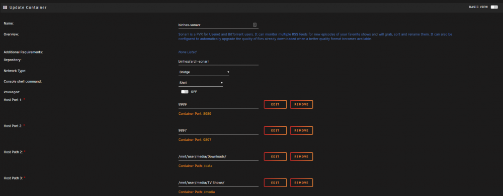

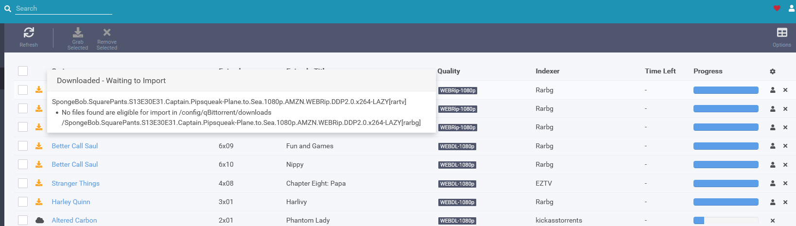

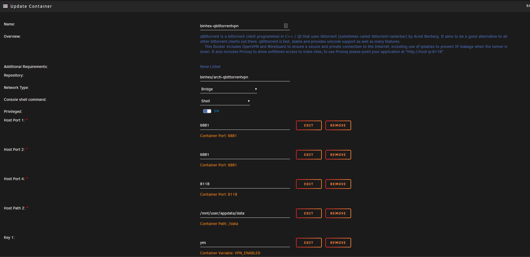

Hey,
I am having an issue with Sonarr accessing the download location, any ideas on how to go about setting the perms so that it can be accessed or moving the downloads folder to a folder that Sonarr can access?
LOGS
Spoiler
[Error] DownloadedEpisodesImportService: Import failed, path does not exist or is not accessible by Sonarr: /config/qBittorrent/downloads/downloads/stranger.things.s04e08.1080p.web.h264-cakes[eztv.re].mkv. Ensure the path exists and the user running Sonarr has the correct permissions to access this file/folder
Host path 2 full path: /mnt/user/appdata/binhex-qbittorrentvpn/qBittorrent/downloads
Default save path for Qbittorent: /config/qBittorrent/config/qBittorrent/downloads
Edited by ArxKnight

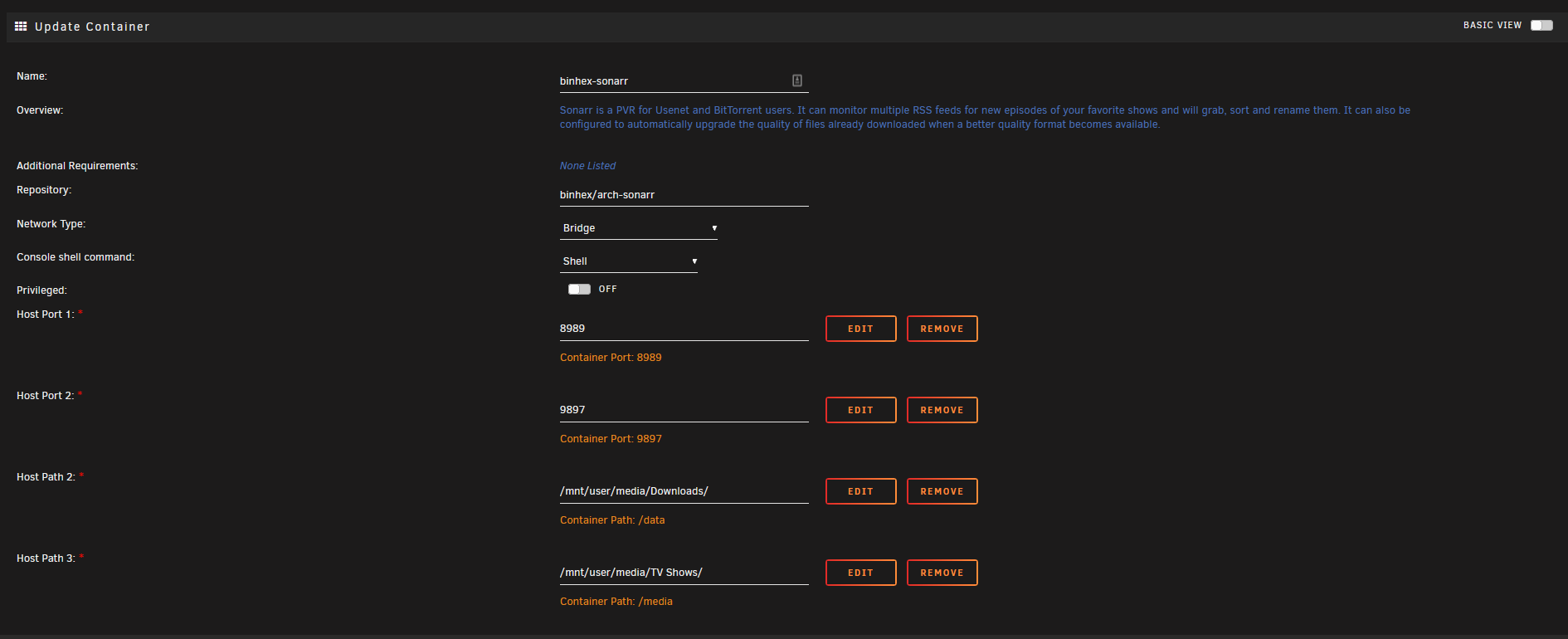

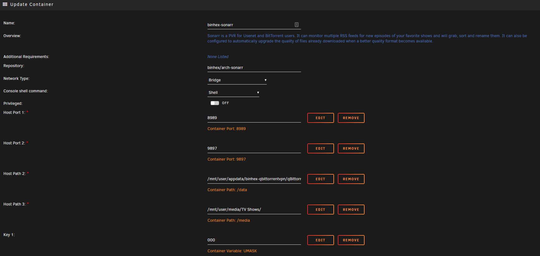

The /data setting must be an exact match between sonarr and qbit. You have it set to 2 different host paths. Both should be set to the root of the qbit download location.
You also want to set qbit to download to /data and not /config. /config is for configuration files. /data is for downloaded torrents. You also may not want to download them to appdata unless you have a large enough cache disk (assuming you're using the default location for appdata).

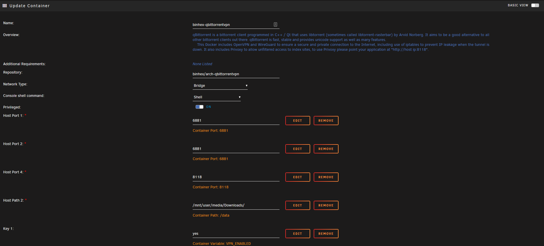

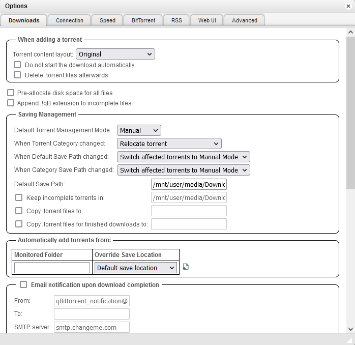

The paths have been changed in the docker settings for both Sonarr and Qbitt to: /mnt/user/media/Downloads/ (This is located on the Array as the Cache is only 1TB)
and I have changed the download folder for Qbitt inside of the UI to /mnt/user/media/Downloads
Edited by ArxKnight

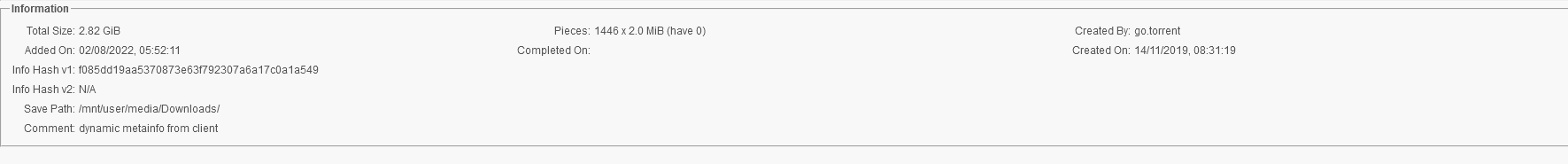

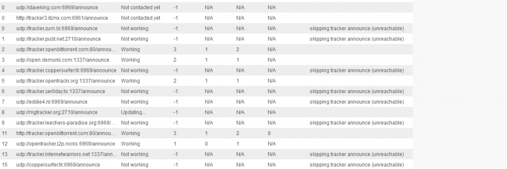

Update,
now that these changes have been made I have deleted any files it started to download due them being in the wrong location however, upon Sonarr adding them back into qBittorent they seem to be getting an error state inside of Qbitt which I can't see anything in the logs but I can see this:
I'm not sure if this is related to the error due to some network access issue somehow caused by moving the download folder or if this is an access issue that Qbitt can't download to /mnt/user/media/Downloads due to a permission issue maybe?
I can see this in the comment of the errored torrents also if this the error code? "Comment:dynamic metainfo from client"
The error in Sonarr is flagging no connections on some of them and just an error state on others
Edited by ArxKnight

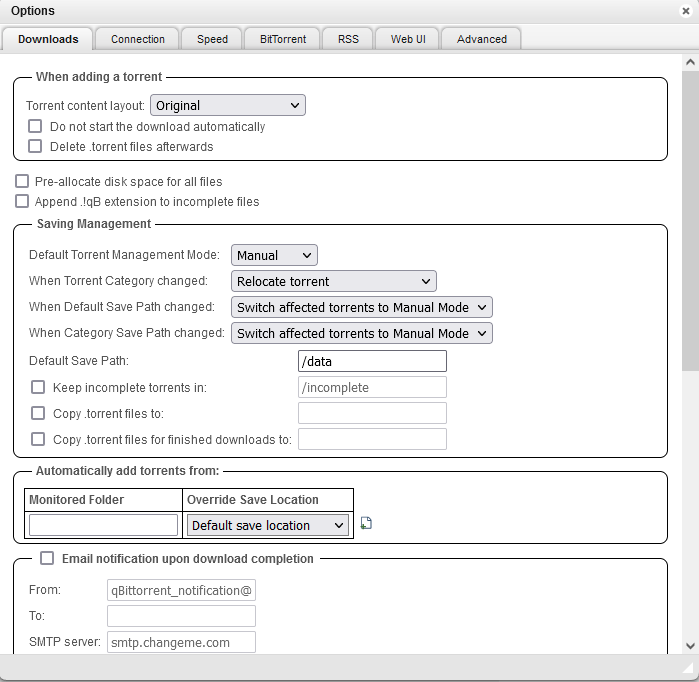

If /data is set to /mnt/user/media/Downloads then you need to set your download location to /data or a sub folder like /data/incomplete. /mnt/user/media/Downloads doesn’t exist within the container. That’s a host location.
Ok, this has been changed.
files now download thank you, just not importing for a diffrent error now:

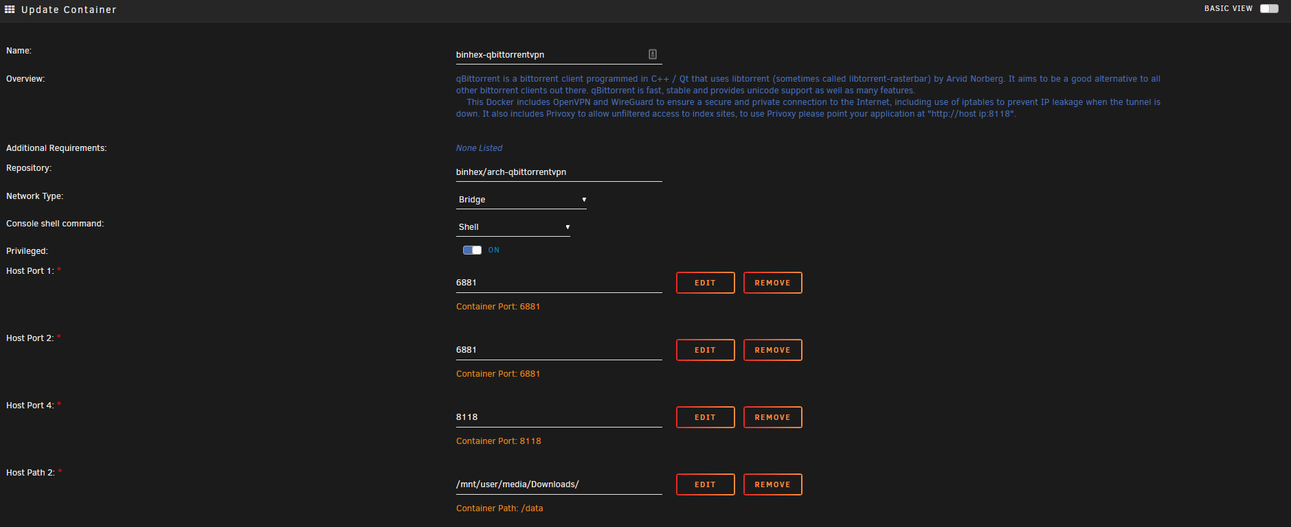

Here are all the current settings for locations
Edited by ArxKnight
Don’t know the answer to that one. You might try rebooting the server and/or running the docker safe new perms tool.
Maybe someone else has a better idea.

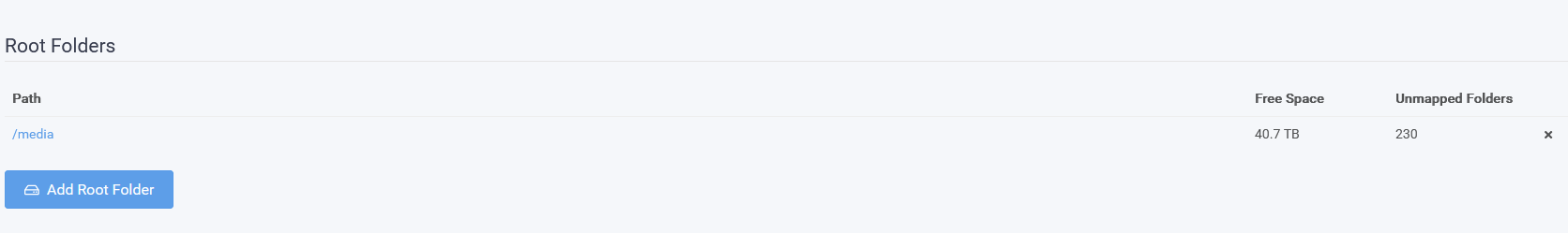

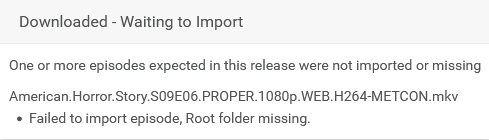

@binhexAny ideas on how to proceed with this error? diesn't seem to say anythig in the help documentation about it.
I did find this is the logs though, my guess is that it can't seem to find the directory to put the files in?
LOGS
Spoiler
2022-08-03 05:32:52,932 DEBG 'sonarr' stdout output:
[Warn] ImportApprovedEpisodes: Couldn't import episode /data/Better.Call.Saul.S06E07.1080p.WEB.H264-CAKES[rarbg]/better.call.saul.s06e07.1080p.web.h264-cakes.mkv
[v3.0.8.1507] NzbDrone.Core.MediaFiles.EpisodeImport.RootFolderNotFoundException: Root folder '/media/media/TV Shows/' was not found.

I checked the docker allocations drop down and only sonarr listed 8989.
Command:root@localhost:# /usr/local/emhttp/plugins/dynamix.docker.manager/scripts/docker run -d --name='binhex-sonarr' --net='host' --cpuset-cpus='0,4' -e TZ="America/Los_Angeles" -e HOST_OS="Unraid" -e 'TCP_PORT_8991'='8991' -e 'TCP_PORT_9897'='9897' -e 'UMASK'='000' -e 'PUID'='99' -e 'PGID'='100' -v '/mnt/user//':'/data':'rw' -v '/mnt/user//tv/':'/media':'rw' -v '/mnt/user/appdata/binhex-sonarr':'/config':'rw' 'binhex/arch-sonarr'
I updated to 8991  per the docker command above. i still see
022-08-12 14:30:05,185 DEBG 'sonarr' stdout output:
[Fatal] ConsoleApp: Address already in use. This can happen if another instance of Sonarr is already running another application is using the same port (default: 8989) or the user has insufficient permissions
I checked docker allocations again and they did not updated to the new port.
binhex-sonarr host [ip] 8989, 9897
my network type is host. not sure if that matters?
nothing loads at 8991.  is it "Host Port 1" correct?
Thanks for the help!
