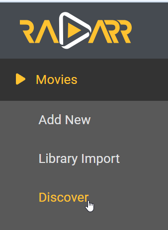

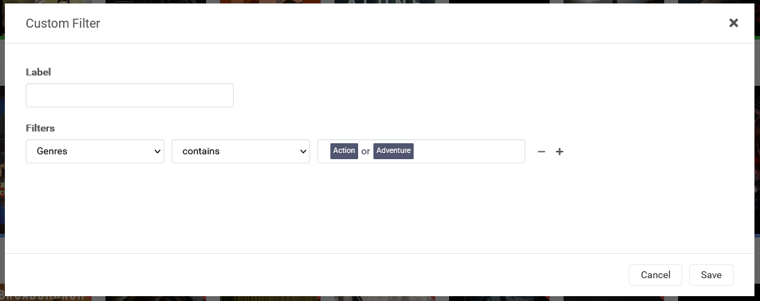

I want to request a "discover new media" for sonarr. And possibly a category/genre too within "filters"

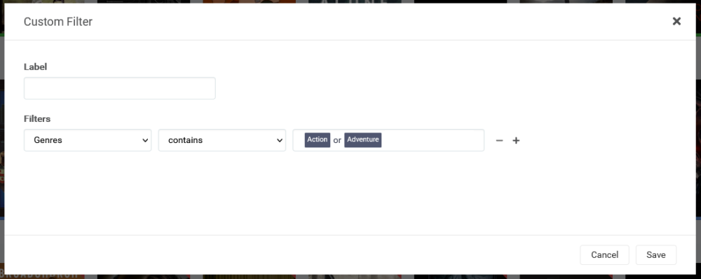

While the first one sounds like a good idea, you need to request that from the app developers, not the container dev. So add your feature request here: https://forums.sonarr.tv/
For the second one, you can do this already with a custom filter
