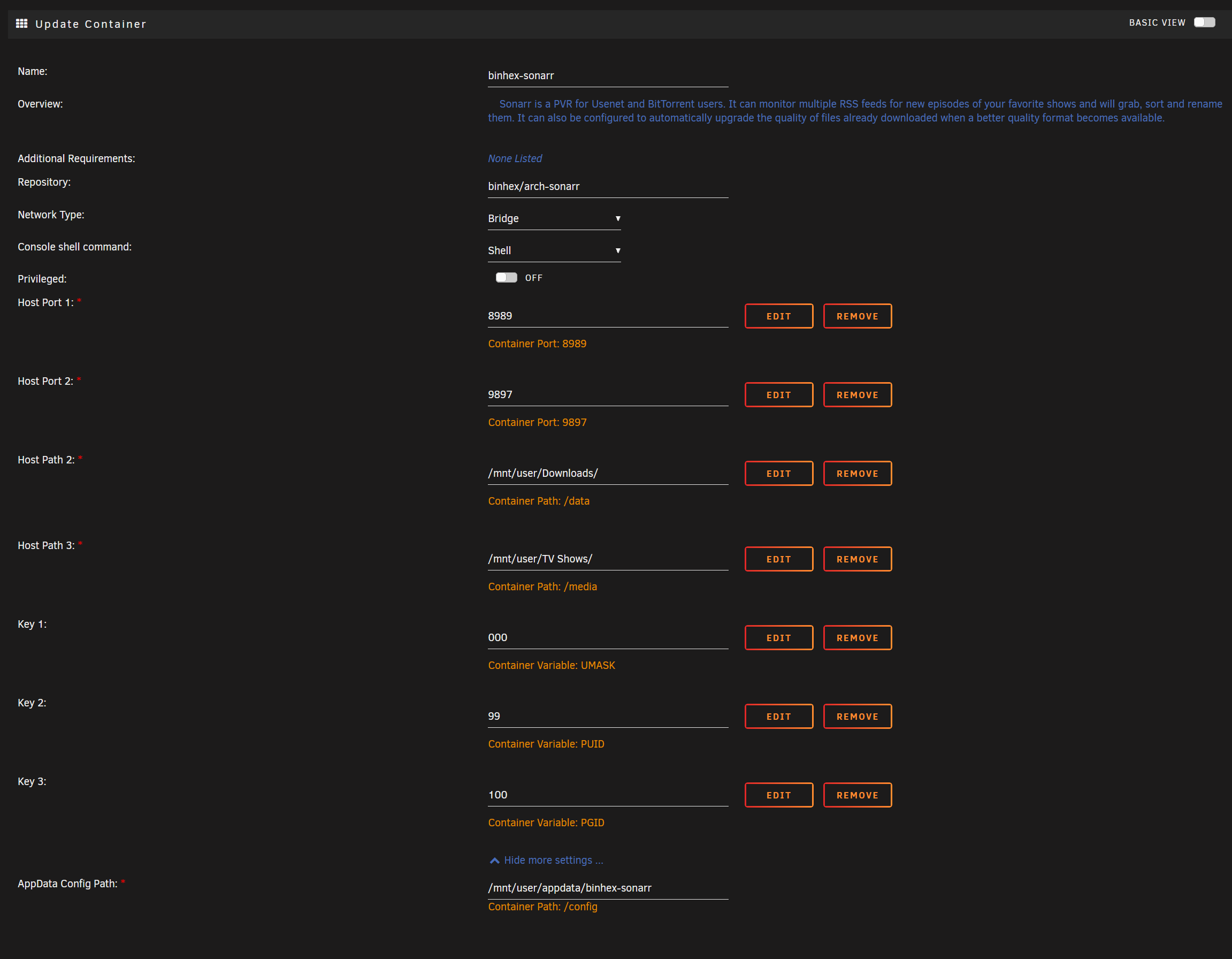

My Sonarr is crashing every 90-110 seconds.
I'm a bit of a newb to troubleshooting containers so apologies in advance. I've attached a cut down container log file and Unraid config with more information but the crash report gives the following error:
Got a SIGABRT while executing native code. This usually indicates
a fatal error in the mono runtime or one of the native libraries
used by your application.
I'm unsure how to proceed in this circumstance to bring stability back to application.
Cut Down Sonarr Log.txt
Edited by EvadingFate
typos
Has it been working but just recently stopped or is this a new install?
Apologies, this has been installed back in 2021 and running like a champ until now.
I was able to make progress (fix the issue 🤞) by restoring a backup from almost a month ago.
System > Backup > Restore Backup
Any insight on the root cause?
You would probably need to post in the Sonarr forum for real insight but my guess would be db corruption of some sort,
