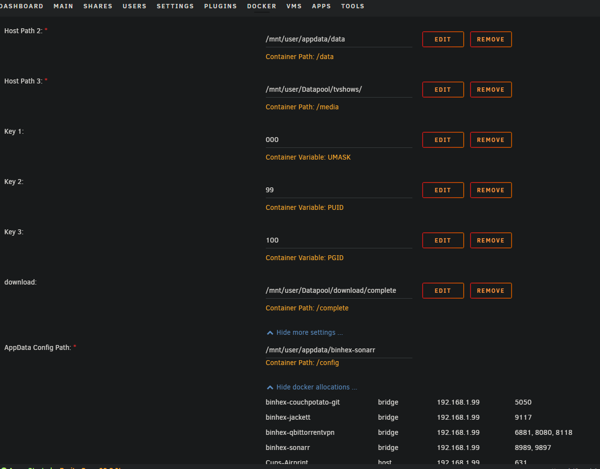

 Import failed, path does not exist or is not accessible by Sonarr:
Except... it dose have access, so I'm not sure what's causing this.
This is keeping it from picking the file and managing QB correctly as well (file is not seeding and is in paused state).
full error:
Import failed, path does not exist or is not accessible by Sonarr: /download/complete/tv-sonarr/American.Dad.S19E10.720p.WEBRip.x264-BAE[eztv.re].mkv. Ensure the path exists and the user running Sonarr has the correct permissions to access this file/folder
Share is public no access restriction
config paths
I changed the data path to match the dl path but I thought same error...
So data is now /mnt/user/Datapool/download/complete/tv-sonarr/ but same error. I browse to the file fine.
Edited by Bushibot

Tried again resetting back the /appdata/data default structures for both sonar and qb. Same error different file attempt.
2023-09-05 00:09:50,843 DEBG 'sonarr' stdout output:
[Error] DownloadedEpisodesImportService: Import failed, path does not exist or is not accessible by Sonarr: /download/complete/Futurama.S08E07.Rage.Against.the.Vaccine.1080p.HULU.WEB-DL.DDP5.1.H.264-FLUX[TGx]. Ensure the path exists and the user running Sonarr has the correct permissions to access this file/folder
Grrr I don't get it this sure seems like it should be straight forward.
This usually happens when /data isn’t the same in Sonarr and whichever download client you’re using. Both dockers must have exactly the same path for /data.
They are both the same. Sonar and QB. Both binhex.
/mnt/user/appdata/data/download/
sonarr is reporting correctly, there is no /download bind mount for the sonarr container as can be seen from your screenshot, you need to do as @wgstarks mentioned and ensure all containers download to the same path, see Q4 for an explanation:- https://github.com/binhex/documentation/blob/master/docker/faq/unraid.md
Yup, I did that.
both are /mnt/user/appdata/data/download/
4 minutes ago, Bushibot said:
Yup, I did that.
But the error shows that qbittorrent is using container path /download not /data
7 minutes ago, Bushibot said:
Yup, I did that.
ok so the host path (unraid) is the same, that is a good start, but is the container path also consistent for sonarr and qbittorrent? from your scrrenshot sonarr is set to /mnt/user/appdata/data is bind mounted to /data, is this the same for both apps? read the linked faq again, both host and container path must be consistent.
edit - it looks to me like you have 'BROKEN EXAMPLE 3.' from my faq, host paths match but container path does not.
Check your app settings for qbittorrent. I know mine has randomly switched download paths in the past.
Right so I went back through with cut and past to make sure there was not caps or funny business. They are a match now forsure. Course now I have a different error but I consider that progress 🙃 been a loooonnnggg weekend
I couldn't see a difference but yes I think something was off.
there was definitely a difference at some point as sonarr was seeing completed downloads in '/downloads' but sonarr did not have this container path specified, (see your screenshot), sounds like you got it sorted now, yay! - the golden rule as mentioned in my faq is that host path AND container path AND application download path MUST be consistent between metadata apps (e.g. sonarr, radarr etc) and the downloader app (e.g. qbittorrent, sabnzbd, nzbget etc), if you use /data for one and /downloads for another you are oging to have a bad time!. It's one of the more tricky things to get your head around when using docker container, but once you got this correct then it all works.

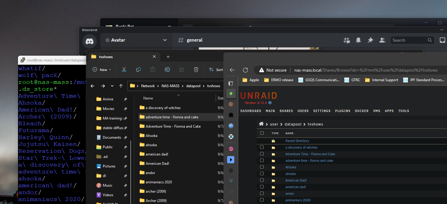

Duplicate folder issue
It looks like Sonarr (I think) is creating duplicate media folders, helpfully with correct capitalization. The original folder structure was all lower case...
I thought I could just CP them together, but SSH only shows the new folders Ashoka vs ashoka for example.
I'm not quite sure how make the existing folder structure play nice...?
The new downloads are going into the new directory's old ones have the legacy data.
Argh filebot won't show the duplicates. So much for easy button.
Edited by Bushibot
