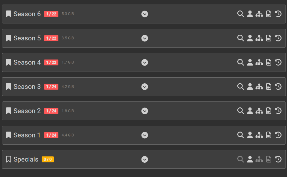

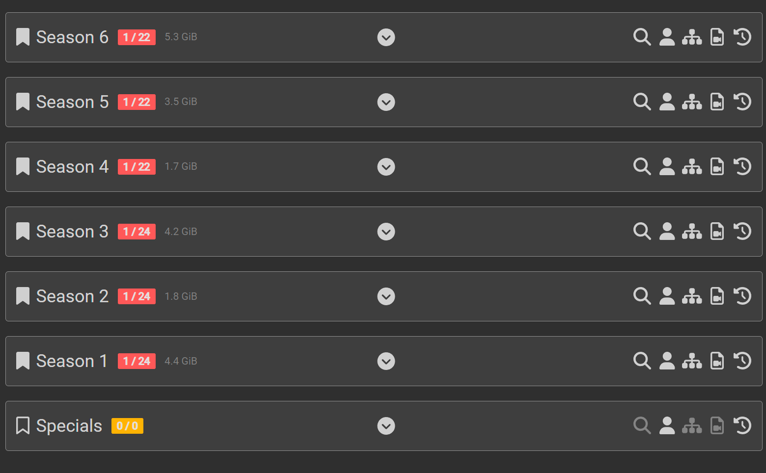

I lost my cache. For some reason reinstalled Sonarr won't add files even if I refresh & scan, nor can it add files that are there after I try reimporting/re-adding a series!image.thumb.png.f407cac70a95561e66f478fecc3b6b4c.png
It does 1 or 2 episodes and some it just did the entire series for no obvious reason (all the below are 100% there)! They all live in the same share top level.image.thumb.png.48014f26e39fe9f0aca0302aefbddfc2.png
I can manually map each episode, but that's it.
Any advice welcome

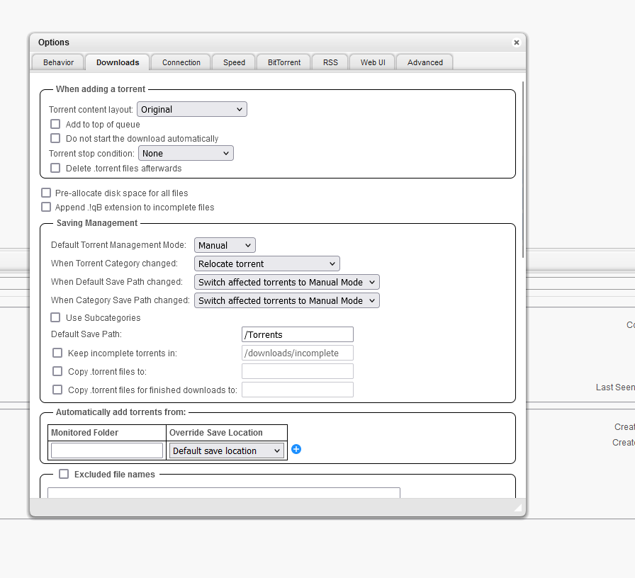

hi, sorry im pretty new for all of this things i have a lil problem
as first image, i tried to put torrents in ¨second photo of Path¨
and third photo how i write in qbittorent, yeah i dont know where to ask
not sure if its releted at all, any help is welcome
Thanks
The host and container paths for qbittorrent and sonarr must be exactly the same. For example mine is /data:/mnt/user/qbitvpn/ IN BOTH DOCKER CONTAINERS. You can then configure qbittorrent to download to /data within the app using sub folders as you desire.
yep, learned a few minutes ago i need to add the paths manually, thanks
