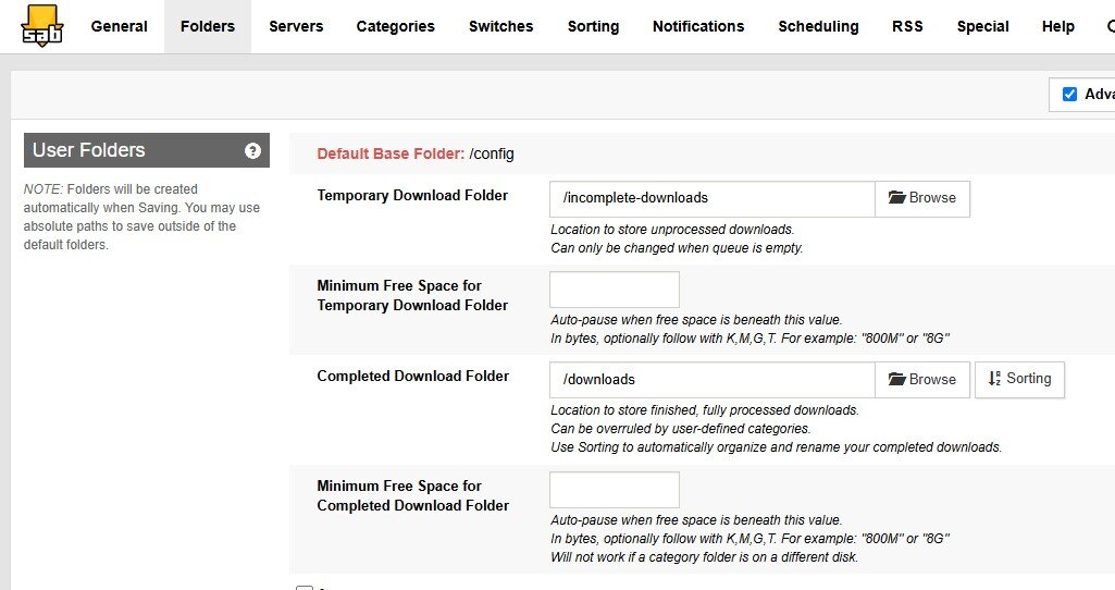

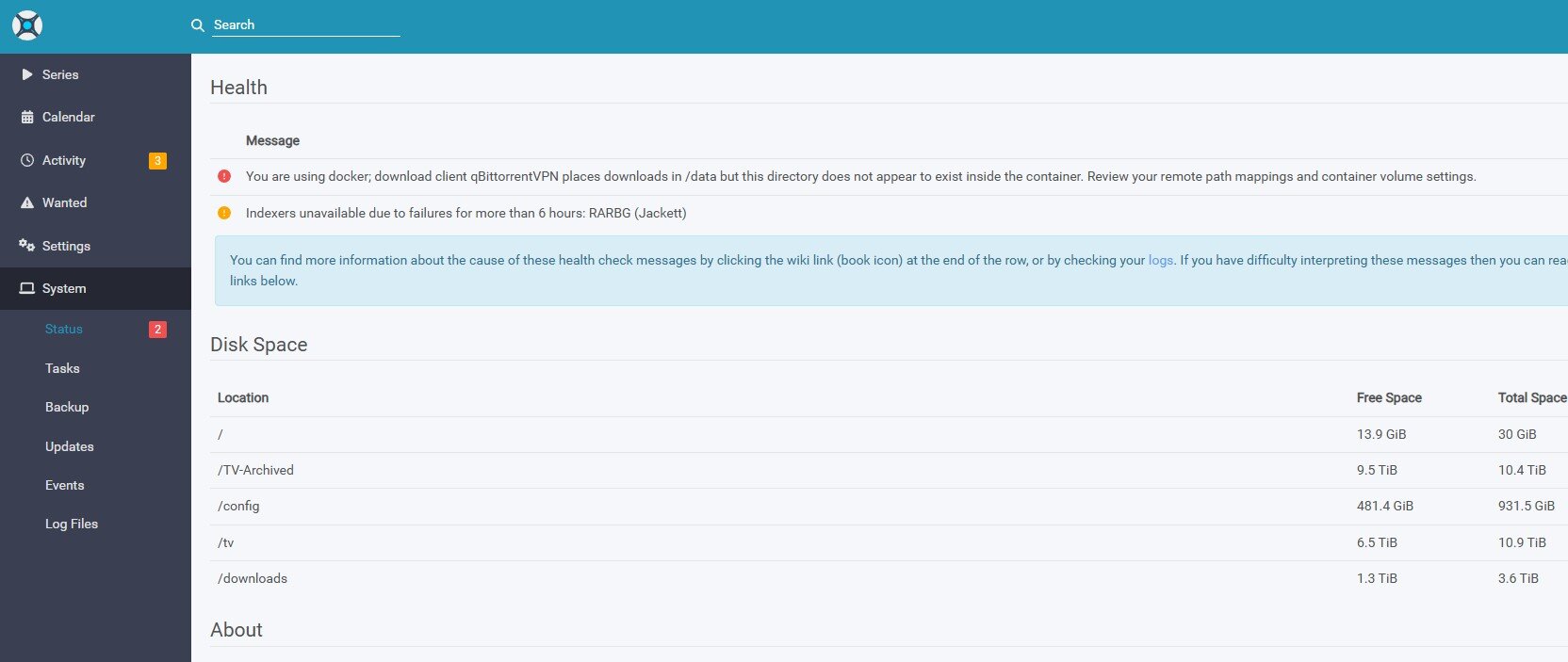

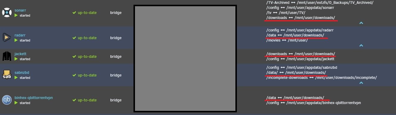

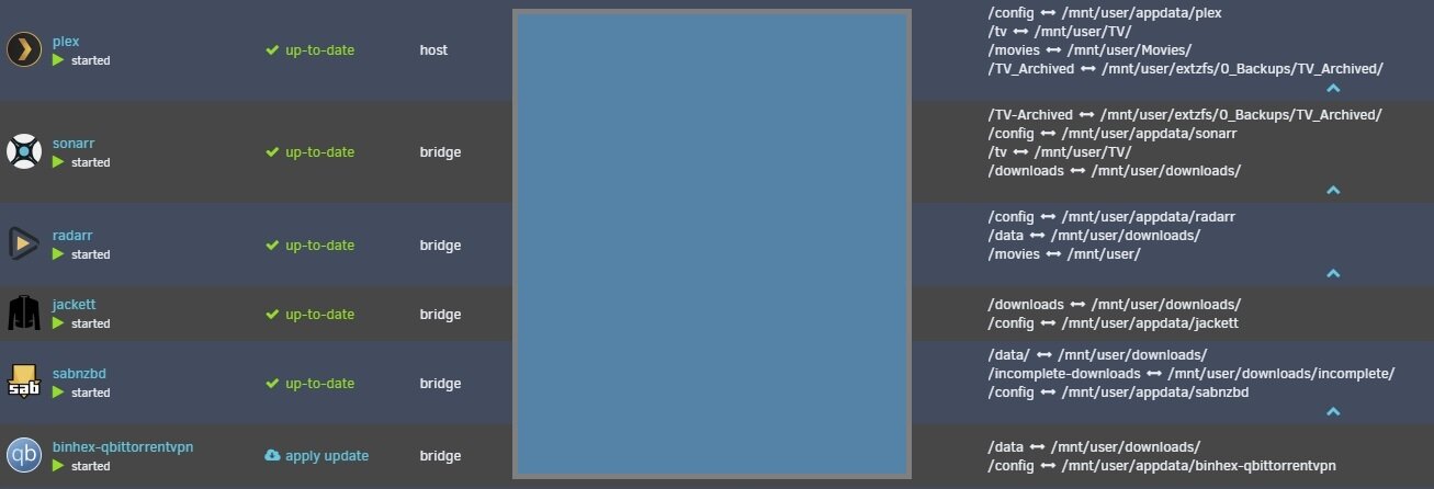

I'm so friggin' lost and confused right now... lol
I had everything working great for almost a year, then I needed to move some older shows to my secondary (external) array.  When I did, Sonarr (obviously) couldn't find those shows any more, and flagged them as missing.  So I thought I was clever, and added an extra path to the container, pointing to the external share, then added that path as a root path.  Well, during all that, I somehow broke something, and not only are my archived shows still showing up as missing, but now none of my *arrs work anymore, nor does SABnzb or qBT!  I went back through the mappings and container settings, but I just can't figure out what I've done wrong.  I know my structure isn't set up ideally, but at this point I think it would be a nightmare to set up "right" (ie using DATA as the "base" for all the shares), so I can't really use TRaSH's guide to help.
I've tried all sorts of different combinations, but they all either throw errors, or fail to import downloads, or both.
My current hot mess shows the following....
containers.thumb.JPG.ae5461be14d36fe40a84c122e4b6ce7f.JPGqBT.thumb.jpg.36d6fbafa39bb8fa255b62b4d753d4f1.jpgSonarr.thumb.jpg.c7da38e72cf23b610ec25d3eb07d225c.jpg
What else would you need to see to rescuse me?SABnzb.thumb.jpg.4d7fa02c15b3caaf096bab0fab4bc803.jpg
What else might you need to see/know in order to rescue me from myself? lol
One of the oddest things is that when downloads complete, they just...vanish.  I have searched all over, and I can't figure out where they're going.  Neither can Sonarr. :)
Edited by Elmojo

Start by edit the configuration template for Sonarr, and change the container path name /downloads to /data.
Radarr, sabnzbd and qbittorrent all have:
/data <--> /mnt/user/downloads/
Sonarr need to have that mapping as well.
And for the vanished downloads I think you need to change the Completed Download Folder in SABnzb from /downloads to /data.

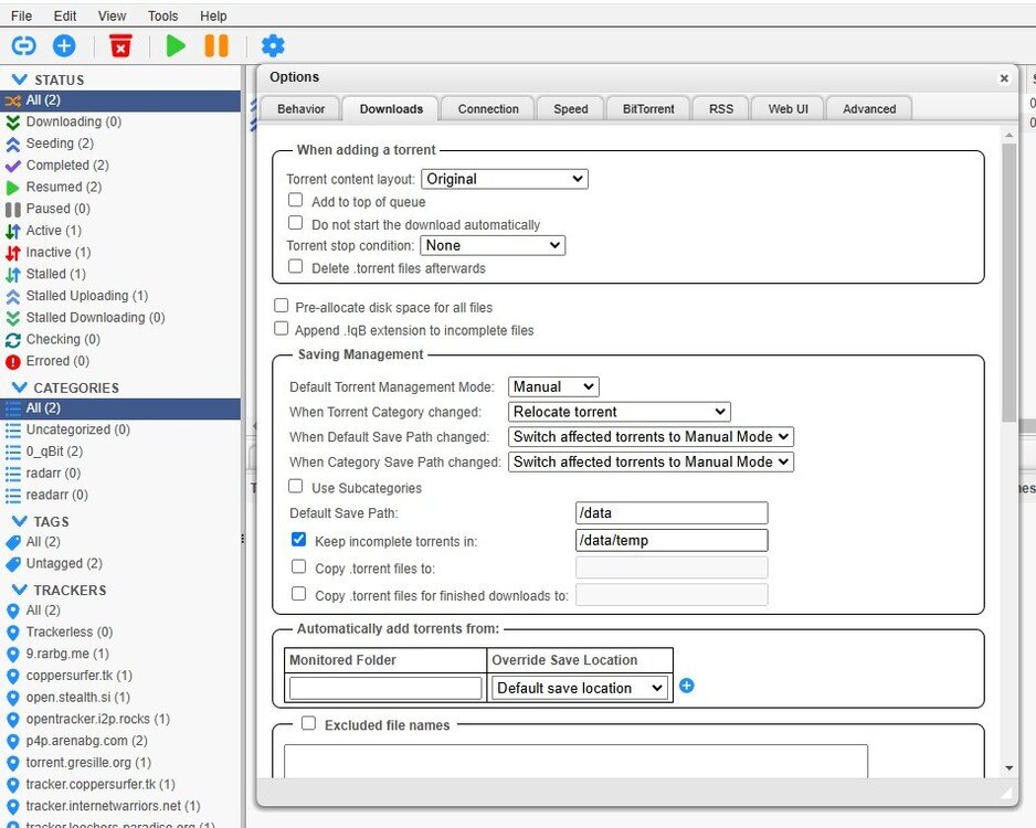

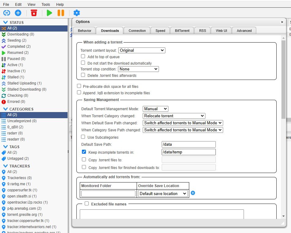

You have downloads set to /data in qBT so downloads in qBT should be found in /mnt/user/downloads.

See Q4, get this sorted first:- https://github.com/binhex/documentation/blob/master/docker/faq/unraid.md
Sorry, I don't follow.  I have no folder on my host system called "/data", to my knowledge.  I know that's the preferred root structure, but as I mentioned, I set mine up before having the benefit of TRaSH's guides or any of the other tutorials that advocate that structure.  At this point, it would be a huge issue to switch over, I think.
17 hours ago, binhex said:
If I'm reading correctly, this is saying basically the same as @Hogwind, right? The problem is, I don't see an option to set some of the parameters the way they're shown in all the examples and guides I read, including Q4.  For example, it says...
WORKING EXAMPLE
sabnzbdvpn
Host path is set to:- /mnt/cache/appdata/data/completed
Container path is set to:- /data
sonarr
My Sab and Sonarr look very different.  My host path isn't "cache/appdata" at all.
For Sonarr, the template doesn't even ask for a /data location, it asks for "Path: /downloads:", which in my case is /mnt/user/downloads/
For Sab it's asking for "Container Path: /data/", and this one I've also always had as /mnt/user/downloads/
I realize I (obviously) have something wrong, I just can't seem to wrap my head around what it is, or why everything is suddenly broken, when it's all been working perfectly up until I tried to add that 2nd path into Sonarr.
If someone is willing to do a little handholding here, and take into account that I struggle with understanding of mappings and paths, then I'd be very grateful. :)
👆 That is what you need to change. Open the Sonarr template and edit that path so that the "Container Path" is /data.
They were EXAMPLES, if your host path is something else then use that, same for container path.
Do as Hogwind suggests, you might as well fix up Jackett, same issue, change container path to /data (currently set to /downloads) or remove it (not required for jackett.

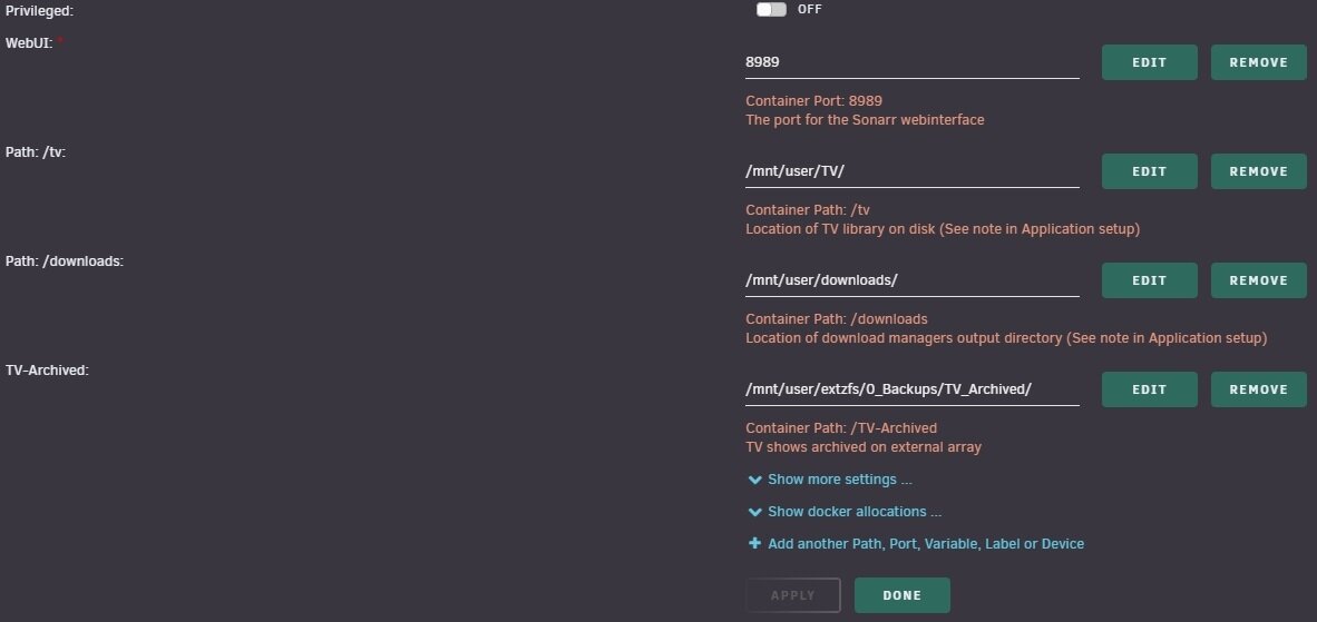

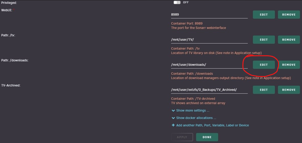

This is where I get lost. My template just doesn't look like that. :/
Mine is like this:Sonarr_template.thumb.JPG.8434516b92b579ddc70450d6c9df3268.JPG
I don't see what else mine could be, other than what I currently have, which is not working.

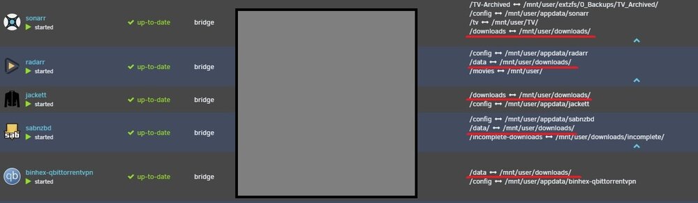

EDIT: I've gone back through all my *arrs and downloaders, and they all use /mnt/user/downloads. It seems I'm being consistent with the path, which is the main thing, right?  I told you I struggled... lol
Edited by Elmojo
added info
And do they also all use /downloads for the container path as well? This would also be required.
Would this be specified in the template or within the WebUI of the app itself?
If in the template, then see the last screenshot above and tell me if that looks correct for the example of Sonarr.  Those are the only options I have.  If you mean within the webUI, then I'm not really sure where that needs to be set, sorry.
It’s in the template. In the one you posted it’s /mnt/user/downloads/ but you have only posted a screenshot of one template. You’ll need to check all of them and be sure they are all an exact match.
I think I did, but I'll check again.  It's confusing, since they don't all use the same nomenclature for the templates.
So where does this come in?  Where would I use the "/downloads" path instead of the full "mnt/user/downloads/"?
Unless I'm missing something (likely!), then this screenshot will confirm that I've set all the paths the same, no?
The host uses the host path /mnt/user/doenloads/. The app in the container is basically sealed in a bubble. It can only see the container paths that you configure. In this case it is /downloads or /data. In your case qbittorrent is telling Radarr (for example) that it has downloaded a torrent to /data/blah/blah/ and Radarr doesn’t have a path that matches that so it can’t find it.
According to your screenshot Radarr, sabnzb and qbittorrent are all using /data. The rest are using /downloads. You’ll need to pick one or the other if you want them to work together.

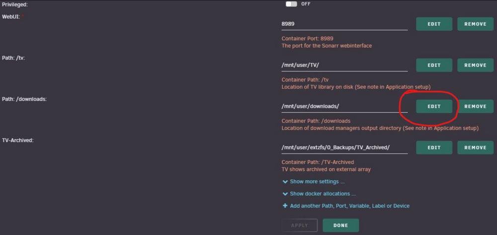

Click the EDIT and change the Container Path: /downloads to /data
So it looks like this:
Well DANG!  In all the time I've been using unraid and dockers, I don't think I've ever clicked the [EDIT] buttons. *facepalm*
Changing those to /data and editing my SABnzb webUI settings to match fixed all the errors, but now I have nested duplicate download folders within my mnt/user/download directory.  This isn't a huge deal, but it's odd.

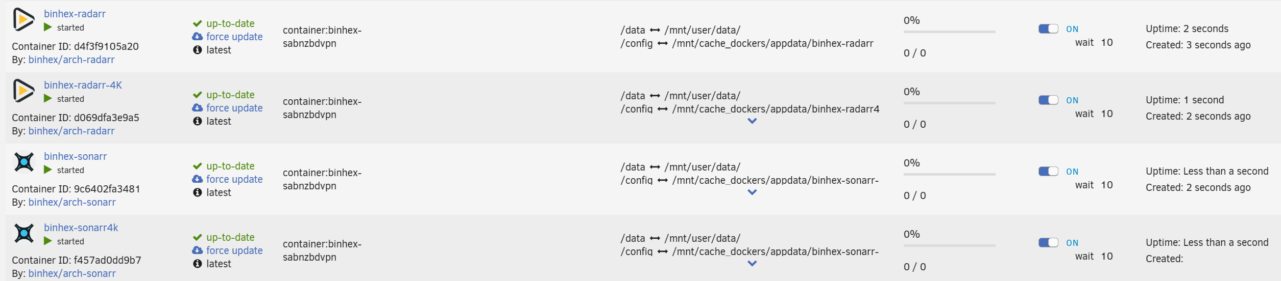

After updating to v4 all of arr's keep rebuilding the container every 3 seconds. I can not view the logs as it automatically closes the log each time the container is rebuilt. If I stop the containers, then restart them, it will work for a few hours but then goes back to constantly rebuilding them. Also noticed it changes the cotainer ID on each rebuildimage.thumb.png.0aa6d759dffd363bcbbdc780a9bb60cb.png
Did you find a fix for this? Mine seems to be in a loop as well.
