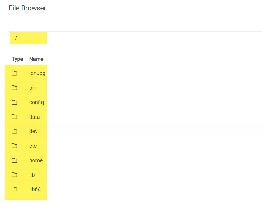

I'm new to UNRAID and just set it up. Not sure if I'm posting in the right area. I installed Sonarr and I keep getting this error below. I know its something to do with the file path but it won't see my TV Shows folder. The screen shot that shows all the folders, even when i click on /mnt nothing shows. Any help would be great.
Error:
You are using docker; download client qBittorrent places downloads in /downloads but this directory does not appear to exist inside the container. Review your remote path mappings and container volume settings.
50 minutes ago, mikede78 said:
Error:
Usually when you see this error it means that the data path in Sonarr and qBittorrent are not exact matches. If you set /data in Sonarr to /mnt/user/Media then you must also set /data in qBittorrent to /mnt/user/Media and use /data as the root of the download location.
