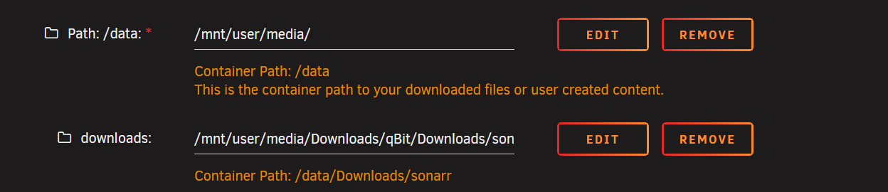

Still have constant error on sonarr saying:
You are using docker; download client SABnzbd places downloads in /data/completed but this directory does not appear to exist inside the container. Review your remote path mappings and container volume settings.
Read everywhere that says to match download client to Sonarr and as far as I know I did that not sure how to make it match more...
Also says use hardlinks but can't since setup seperate shares long ago
so i have /mnt/user/data  a share where all the downloads are pointed
so in SADnzd  the host path /data is pointed to /mnt/user/data
and in Sonarr the host path is pointed to /mnt/user/data
but still getting the error
see Q4:- https://github.com/binhex/documentation/blob/master/docker/faq/unraid.md
pay special attention to 'IMPORTANT' note at the end, as i suspect this is probably the oversight.

For the life of me I cannot get the Hard Linking working with Sonarr (or Radarr for that matter).
I am new to Unraid, probably why!
Downloads to into mnt/user/plex_media/downloads
Media is at mnt/user/plex_media
The tick is ticked in settings for Hardlinks.
The original download is left in downloads and the name corrected file is put correctly into it's folder.

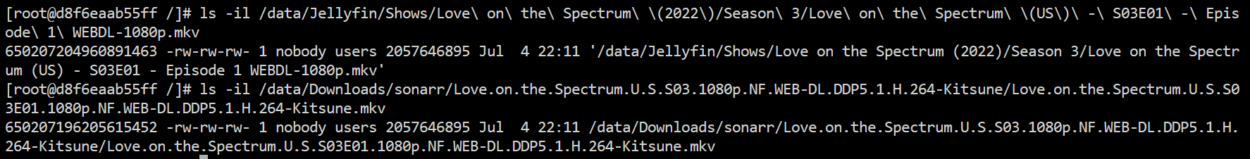

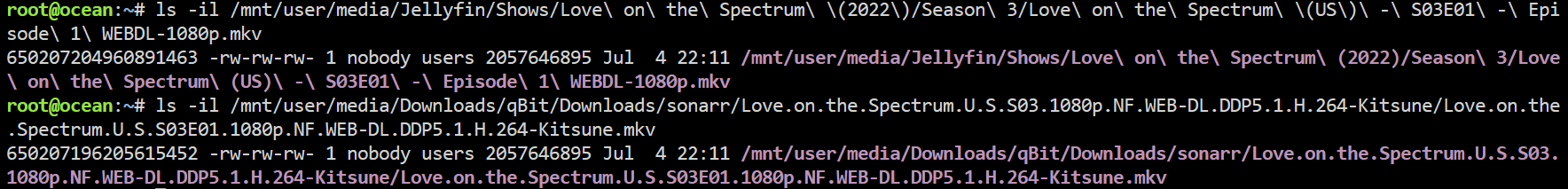

When running a "stat" on the files, the Inode is not the same, and the "Links: " is always 1. 😔

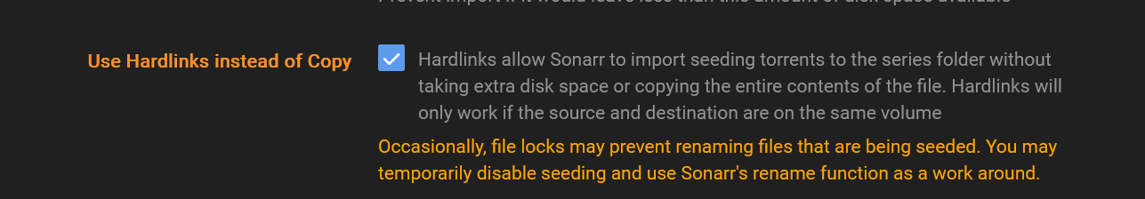

Sonarr is copying all of my episodes instead of hardlinking them. It doesn't seem to be a permissions issue, as all the files and folders are owned by nobody with the same permission and I also paused the sonarr and qbit containers to run a new permissions job on the media share to no avail.
The files on unraid:{08503841-74AC-4C62-99E9-08171B02F6E0}.png
The same files in the sonarr container:
Both files are on the same volume in both unraid and the sonarr container. If you are keen you may have noticed that I am using a nested folder mapping structure in order to not have to shift all of my other mappings and file structure around. I don't know how this could be causing the issue because sonarr sees the files like it expects to, but I'm including it just in case I am missing something. The container creates an empty 'sonarr' folder at /mnt/user/media/Downloads/ that I just leave alone.
And yes, I have the hardlink setting turned on. The note at the bottom, if I understand it correctly, is saying that it possibly would not be able to rename the hardlinked destination files in the root folder because the iloc is locked by qbit, correct? Even in this case, the files would still hardlink correctly, they would just both have the same name in the case you had file renaming turned on in sonarr? Just making sure I understand that note correctly and that it wouldn't be causing the issue either.
The relevant lines in the log file don't appear to show any warnings or errors:
2025-07-05 11:39:51.4|Debug|EpisodeFileMovingService|Attempting to hardlink episode file: /data/Downloads/sonarr/Love.on.the.Spectrum.U.S.S03.1080p.NF.WEB-DL.DDP5.1.H.264-Kitsune/Love.on.the.Spectrum.U.S.S03E01.1080p.NF.WEB-DL.DDP5.1.H.264-Kitsune.mkv to /data/Jellyfin/Shows/Love on the Spectrum (2022)/Season 3/Love on the Spectrum (US) - S03E01 - Episode 1 WEBDL-1080p.mkv
2025-07-05 11:39:51.4|Debug|DiskTransferService|HardLinkOrCopy [/data/Downloads/sonarr/Love.on.the.Spectrum.U.S.S03.1080p.NF.WEB-DL.DDP5.1.H.264-Kitsune/Love.on.the.Spectrum.U.S.S03E01.1080p.NF.WEB-DL.DDP5.1.H.264-Kitsune.mkv] > [/data/Jellyfin/Shows/Love on the Spectrum (2022)/Season 3/Love on the Spectrum (US) - S03E01 - Episode 1 WEBDL-1080p.mkv]
The only other log lines referencing this episode were parsing metadata about the video file and there is nothing else about hardlinking for this or any other file, just these two lines about attempting to hardlink, then calling HardLinkOrCopy.
Thanks in advance.

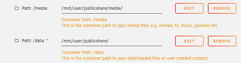

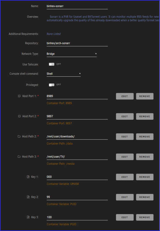

11 hours ago, Optimus Prime said:
I am following this...I finally have Sonarr managing moving my files and the removal of the torrent, but I still have Filecopy instead of hardlinks.
Delete the /media and just have all the structures under the /data link and do the same with your downloaders
https://trash-guides.info/File-and-Folder-Structure/
