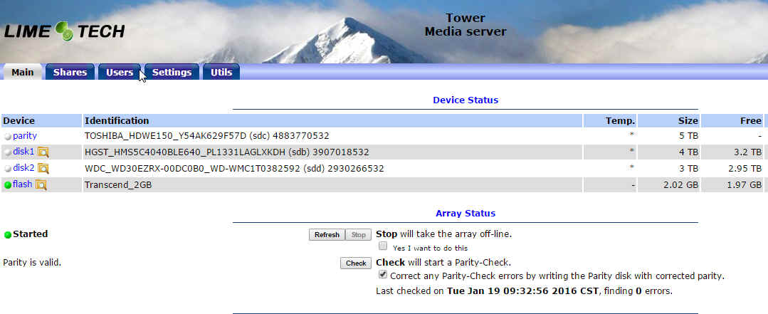

I did stop the array but I didn't see any drop down boxes to select the drive. What is that I am missing? I am attaching the screen shots..

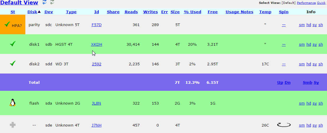

In the UnraidMain (attached) I don't see any drop down box. I did stop the array and I haven't seen any drop-down boxes. In the defaultview (attached), in the bottom of the list, it shows new drive with + sign but I don't know how to add this to array. Any help is appreciated. Thank you guys.
Neither of those screen shots shows the array as stopped.
Stop the array, click an empty slot and take a screen shot of that.

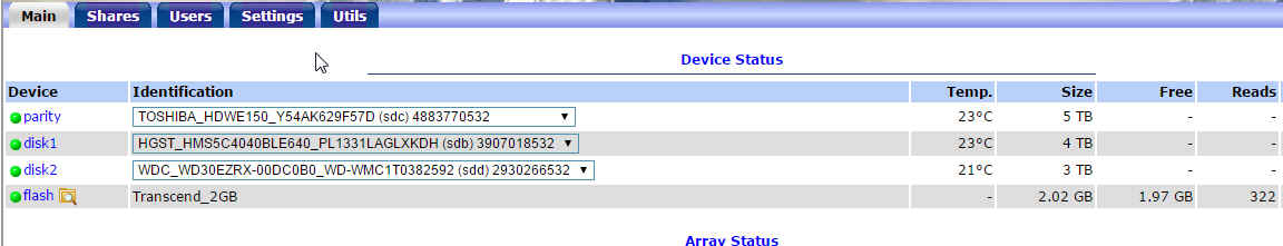

Are you using a paid version? Free only supports 3 devices including parity.
Smart.. I am using the free version that might be the reason I don't see another drop down box for new drive. Please check the attached picture of the unraidMain view. Thank you guys. You guys are the best.
That is the reason, time to buy a license.
Just got the plus version. Thank you and you guys are amazing.
