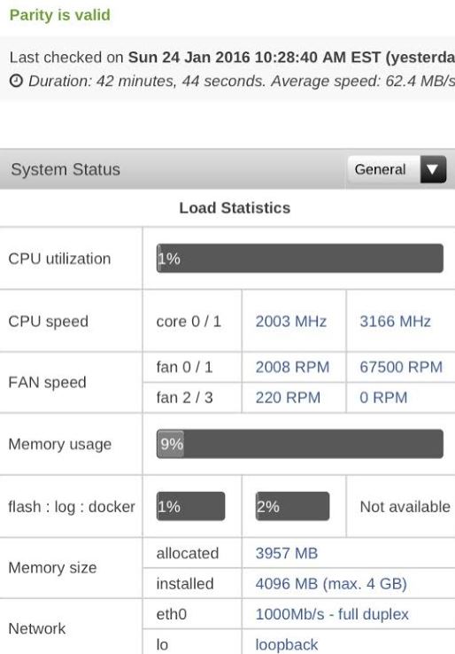

Is unRaid actually connecting at 1000? From "Info" on main menu bar:
Network: eth0: 1000Mb/s - Full Duplex
Yes it says 10000 full duplex. Under that it says lo- loopback.

Post a screen shot. It doesn't seem to be clear what you mean.
Sure thing.  And thanks for the help guys
There's not much can be deduced from that screen shot, other than you've got some very odd fan speeds! What exactly is the problem you're experiencing? I understand that you've done some file copying comparisons between unRAID and Windows but 8 MByte/s is equivalent to 64 Mbit/s, which is more than adequate for Blu-Ray replays. Are you getting freezes/stuttering?

haha.  Yeah, I have an Antec fan with a 3-way speed switch on my fan.  That screen-shot was posted in response to the "lo- loopback" thing that someone wanted to see.
