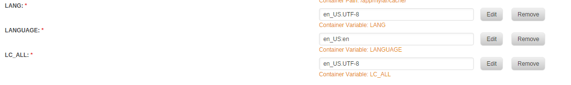

7 hours ago, miko3ed said:
Following some of the info in the github issue I added three variables to the docker container (see attached img) and it fixed the environment allowing mylar to start back up.
Just thought I'd try and help others here :)
Thanks, that fixed it.
Worked for me!  Thanks!!

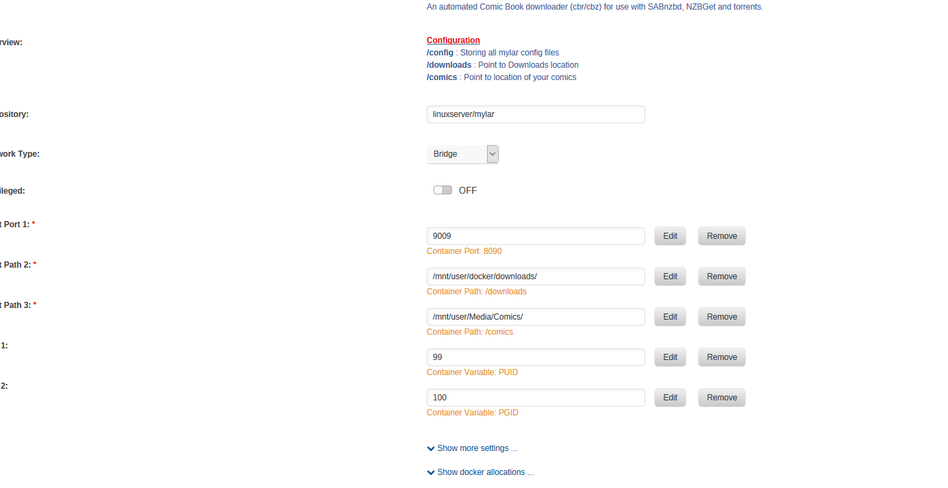

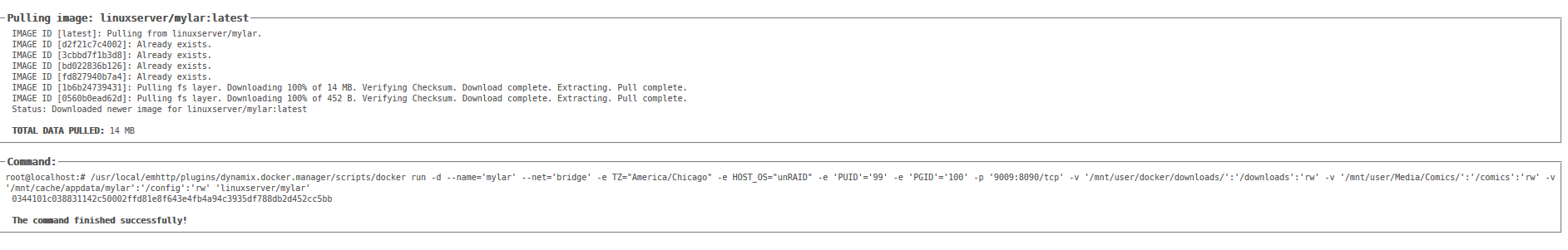

Where does it fail? Post docker run command, the container log and post more details of the error.
Just now, saarg said:
I'm not sure what you are trying to say.
There is no error. When you download from the app store...you set the directories and click install. It says that it installed ok and proceeds to boot the docker. The docker boots but the webpage is inaccessible. When you check the folder, there's nothing in mylar and some files in the scripts folder.
Need to see the Mylar container log to see what is going on.

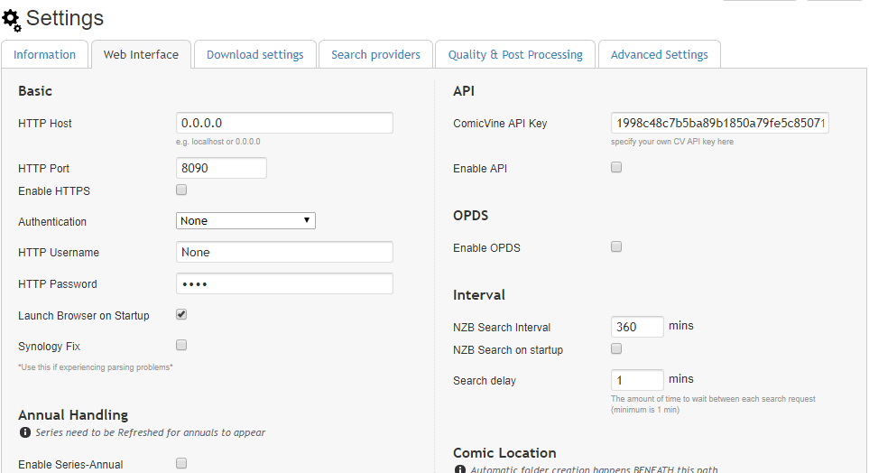

I've tried setting both the host (Mylar and autoProcessComics.cfg) to from 0.0.0.0 to localhost or the ip adres from my server but nothing but the error message changed.
ComicRN: Unable to open URL: <urlopen error [Errno 99] Address not available>
I've redownloaded the PP files from both the docker and the main github and nothing fixes it so I must be missing something.

Screenschots settings
