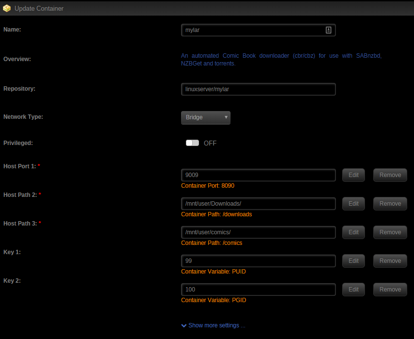

I have not been able to get Mylar to organize downloads. Current settings
Docker:
Downloads -> /mnt/user/Downloads/
Comics -> /mnt/user/comics/

Valhalla:
Might be just the case of the folders:
Downloads DOES NOT equal downloads
Comics DOES NOT equal comics
The capital letter means different folders!
Edited by dstanley
36 minutes ago, dstanley said:
Valhalla:
dstanley, thanks, that makes sense, but before I mess with it, as the only mismatch seems to possibly be downloads/Downloads...
Doesn't the docker take the path from the setting section in the docker.
So the container path is lowercase, and I have lower case in Mylar settings, likewise with /comics.
Also, the comics path seems to work as mylar is creating folders for added comics and the logs show it is finding the path to downloaded comics, jut not triggering the moves from download/completed/comics to /comics.
Thanks

Hey there! I had a question to the group: I have moved over just about every application I had running on separate computers and this is the last one.  I have this up and working happily on unraid and would like to move over the directory from the "old" server. Is there a procedure for copying things over or do I just copy the directories over and call it a day? I guess what I'm worried about is mylar not picking the existing or new existing books up.
Any advice?
