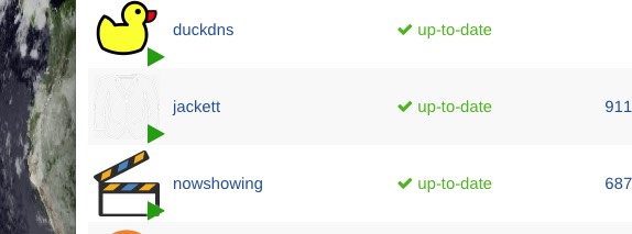

On 4/8/2017 at 7:07 PM, methanoid said:
but this icon works fine with both light AND dark themes...
@methanoid
Not sure that's true. I can't see it at all.
50 minutes ago, wgstarks said:
@methanoid
lol, its about as good as the default is for the Dark theme.. I''ll need to fix it... just needs thicker outline for the Jackett
