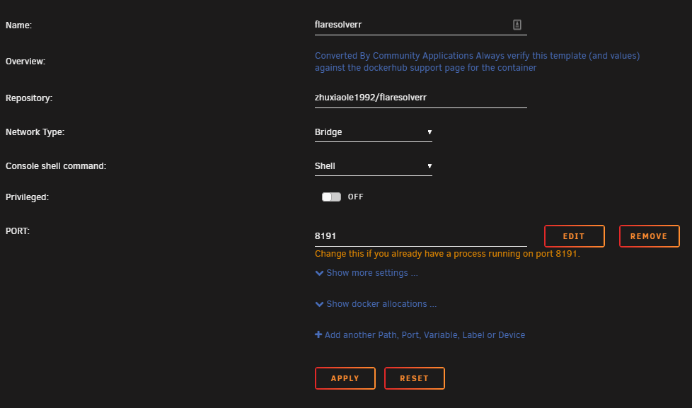

To implement it, it's quite easy:
Go to apps, look for FlareSolverr on Github
I setup it like that:

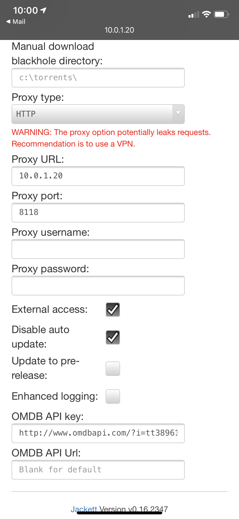

and then in jacket just add it like this:
It works fine for me and should work with other jackett containers.

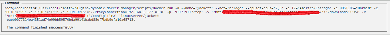

I'm getting the following error after this morning's update.  Any ideas?
Jackett v0.17.159
Option 'ProxyConnection' is unknown.
Edit:
I see in the release notes for this release that the argument was removed.
edce56f36311767f9bff3f1944ea1f0d929ab0e0 core: remove unused cli argument -j (ProxyConnection). resolves #9467 (#10608)
Should I removed this argument from the docker run command and put the proxy configuration in the web gui?  Will this work the same way?
Edited by niwmik

I fixed this on my system, it seems ProxyConnection has been deprecated (as per the logs)
As soon as I removed RUN_OPTS for ProxyConnection my container worked again.
Jackett v0.17.159
EDIT: Didn't see someone else had already pointed this out 😛
Edited by tjb_altf4

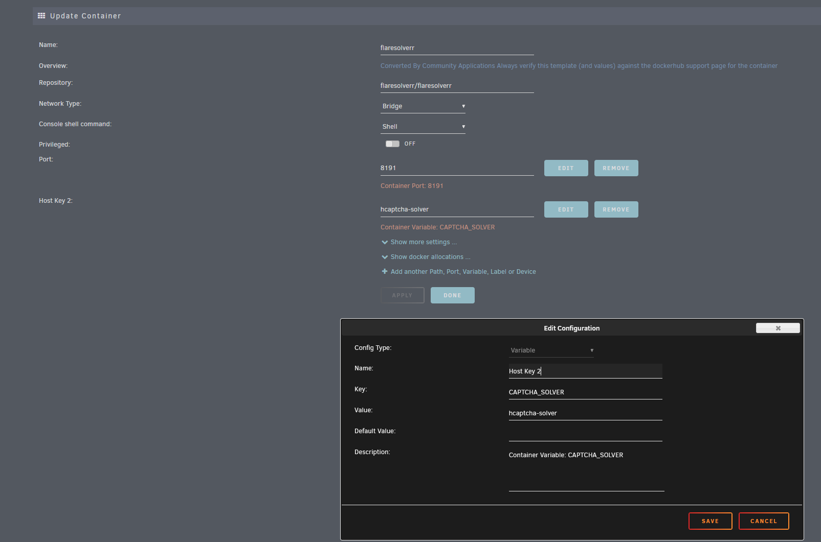

You need to configure a capture solver for flaresolverr.  As per the git page, there are currently 2 which you can use, but don't work all that great.
Edit your flaresolverr Unraid template to look like this:image.thumb.png.829f4bf620866a721c152afd124b28b0.png
Now take note of this line in the flaresolverr github:
NOTE: This solver works picking random images so it will fail in a lot of requests and it's hard to know if it is working or not. In a real use case with Sonarr/Radarr + Jackett it is still useful because those apps make a new request each 15 minutes. Eventually one of the requests is going to work and Jackett saves the cookie forever (until it stops working).
So basically it may or may not work.  But the error message will be gone now and hopefully the hcaptcha-solver will eventually work and let you in.
Edited by 007craft

Mine has been working for a couple of weeks now with everything configured as above. Only problem I had was self-inflicted, where I initially entered the variable value as 'hcaptcha_solver' instead of 'hcaptcha-solver'
