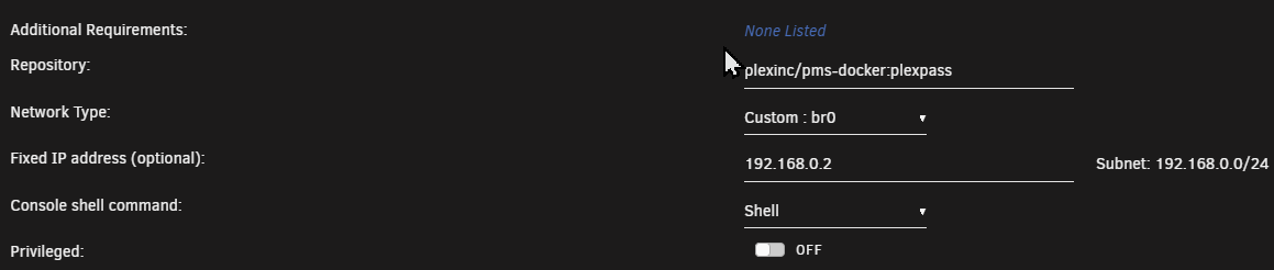

I really want to run a second Plex server to play with XteVe and the Live TV.
Would it be easier to create a VM with a dedicated LAN passthrough?
Or is there an easier way to do this? - So far bridging haven't been possible running in two dockers
Solved by just creating a new Docker and selecting:
My only problem remaining is getting NGINX working it somehow dosen't like the fixed IP using br0?
