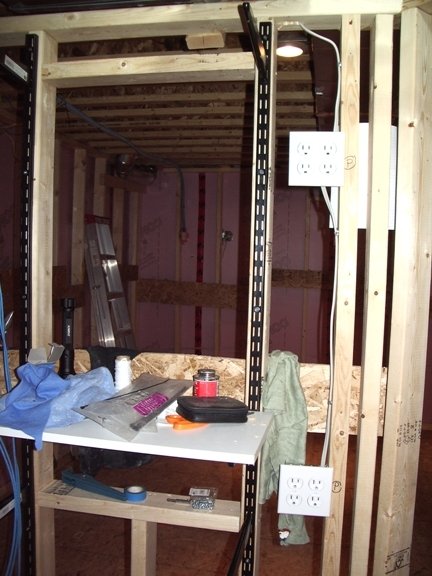

I did this (attached) in my utility room.

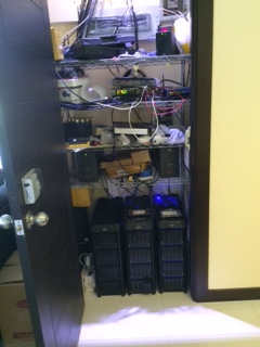

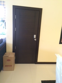

I built an electric cupboard off the living room (it takes up part of a bedroom wardrobe in the room behind it) and it is about 5" deeper than an Antec 1200 case and just under 4 foot wide.

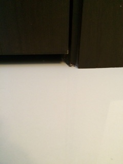

It holds the main circuit breakers for the house, fiber modem, POE gigabit switches for CCTV security, UPS's etc.  At about eye level is a thermostat to turn on an exhaust fan to evacuate hot air into the roof void and the door is deliberately about 1" too short so when the fan cuts in, cool air is drawn in across the servers.  I live in Thailand and it gets pretty hot here.
Through wall racks have several good points. The pretty end can be exposed to a living area if desired while still allowing great access to the messy wiring end, with no rolling or swiveling the rack around to get access.
If you have a modified closet setup, airflow can be much improved, either with a good household exhaust fan (think bathroom fan) or augmented by connecting some of the hvac return air to the inside of the closet, forcing all the air through the rack. If you put a closet type door over the front, you can mount a couple 20x20x1furnace filter racks in the door, so all the circulated air is filtered.
