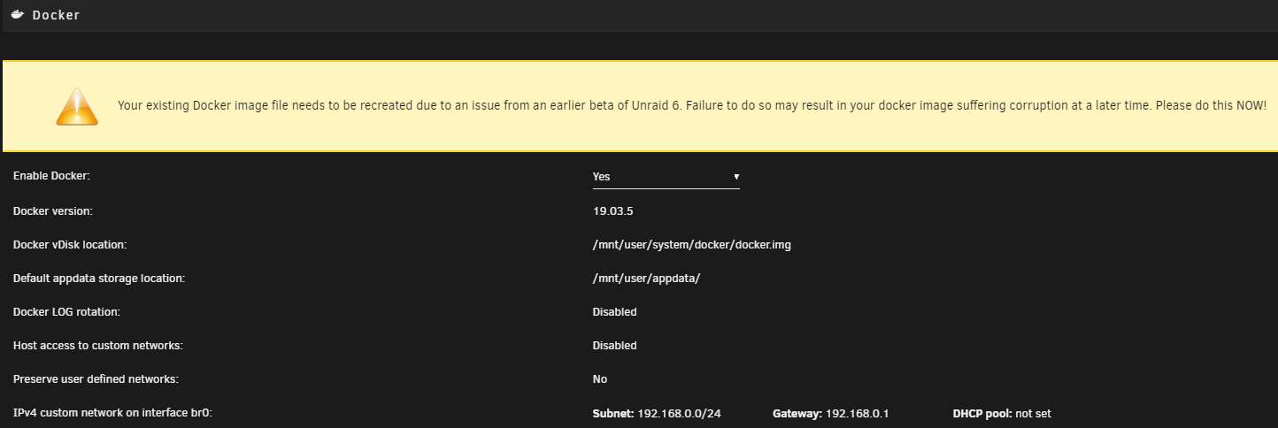

On 8/31/2018 at 5:39 PM, jonathanm said:
Apps tab, show previous apps, check off the ones you want and select install all. No reconfiguration necessary. Only takes a couple clicks and you are done, automated download and set up exactly as they were.
My dockers run perfectly but just noticed this message today:
I have all the dockers in Appdata except Plex and Emby where I have meta data on unassigned devices SSD?
Would this not destroy both Emby and Plex? or would it recreate them with the file paths to the SSD's?
The meta data have been generated over years and I would hate to see it go
Also when recreating the image file is it important to keep the same size as the orig file?
(could I just do a backup of the image file and restore it if things go bad?
Sorry if this i stupid Q's I have read this post but this is not clear to me
Thanks!
Message pops up generally when you move the docker.img.  You can recreate it no problems.  Simply stop the docker service (Settings - Docker), then delete the image, then restart the service
Followed by Apps, Previous Apps, check off whatever you had installed and it'll be the same as before
I had moved my docker.img away from my cache (Replaced it for a bigger cache drive) and after moving it all back I have no warnings anymore! :-)
One thing that worries me, I mistakenly did run a "New Permissions" and included the appdata folder 😞
After a reboot it seems that all dockers are running okay - should I be worried? and what can I do about it? (Appdata permission is not the same)
