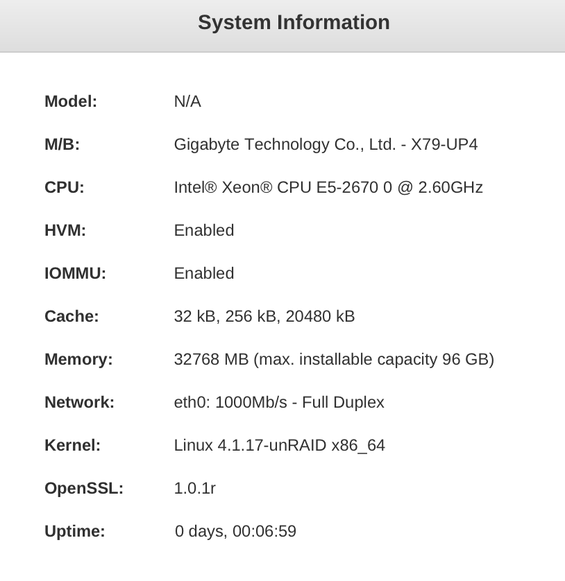

I went the opposite direction of most of you, I went with a X79 board and only one 2670, but I'm very very happy with the upgrade.
All in all I'm in this for under $320:
CPU: $64
Motherboard: $185
CPU Cooler: $55 (Noctua NH-D14, went a little overboard)
GPU: $15 (GT210)
