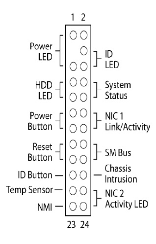

Here is the panel layout of intel server boards.  I hope it gives you some ideas.  I will say intel server boards are known to not run outside of intel server cases.  I dont know why.  I have seen at least 2 instances of the 2600 running in getto modded desktop cases.  I also know they are notorious for being picky on power supplies, even if the board only draws 250 watts peak.

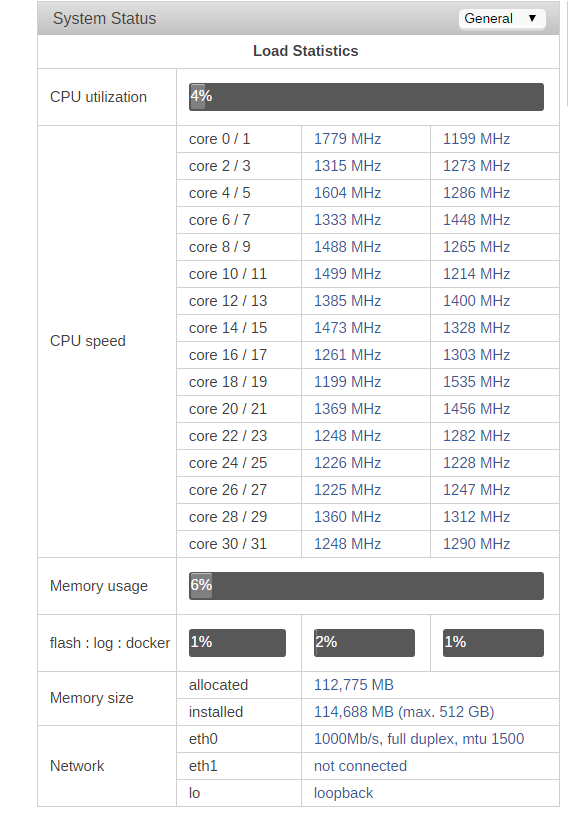

So it idles at 200 watts, and almost all games cant use the 2nd cpu, half the games can use 8 cores, and half can use 16, but zero can get any core past 30% usage.
Overall not bad, but if you live on the coast Thats an extra $100 of free room heating in just 12 hours a day of it being on per year.
I think ill stick with my 35 watt idle baby i3 (4000 crystalmark) for a little while longer :)  Worse case i can pop in a 8500 crystalmark xeon 12XX v3 in it.

Idles at 200w?  Can you elaborate?
Monster video cards?  Wrong PS?
Some have gotten theirs to idle at 70 watts.  What have you got in your server to cause that?
