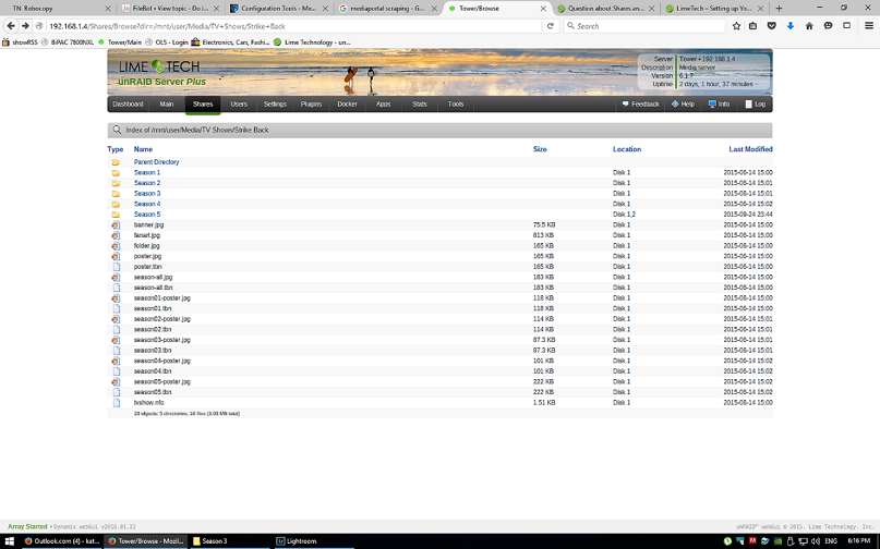

So i found another example. I have attached a screen shot also.
For TV Shows, would split level 3 be better?
Per the screen shot, inside each season is:
Season 5
-S5E01.mkv
-S5E02.mkv
-S5E01.jpg and so on
as you can see, it has split Season 5 across 2 disks - Hence is split 3 better?

Split level 3 would only be better if you want the files for a season to be spread out over multiple drives. I would leave it at 2.
There is no explanation for what you found in the info you have provided.
