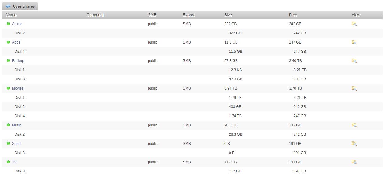

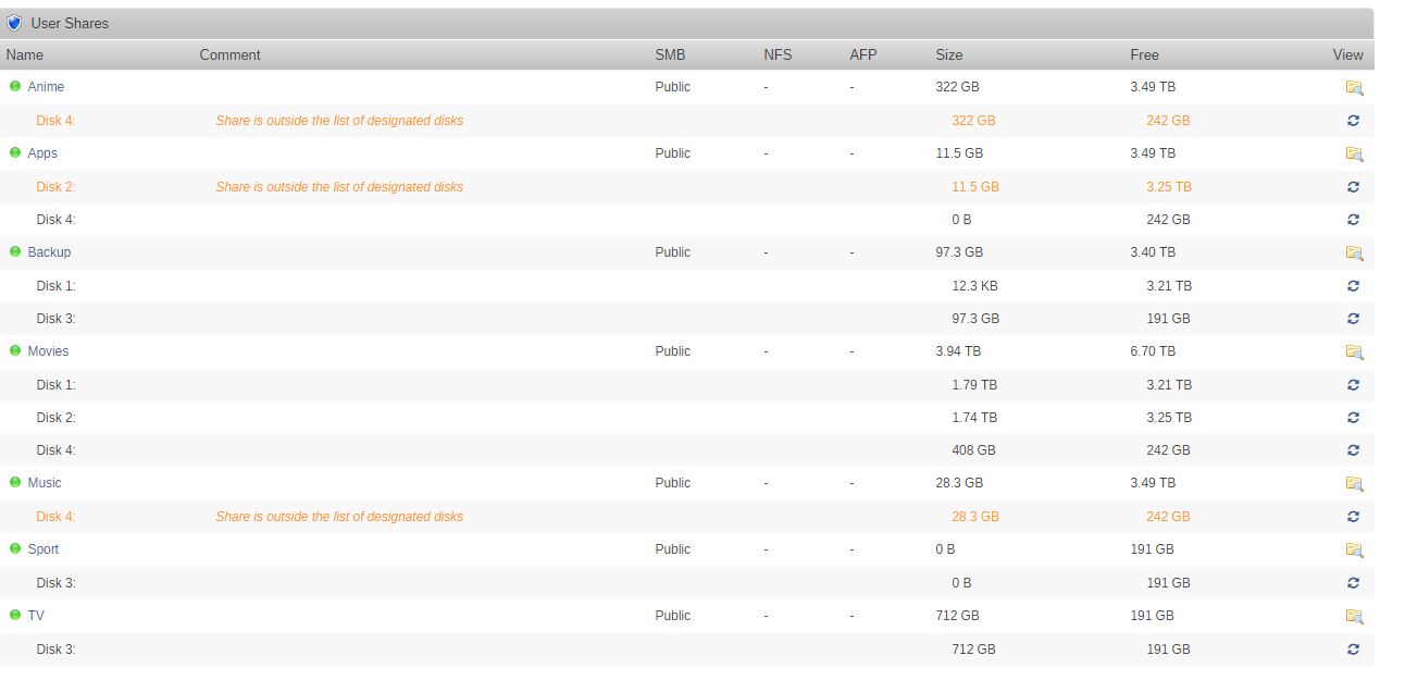

So far so good, first thing I check is that all my disks are in the right slots, they are indeed correct. Then I recheck my shares, not good.

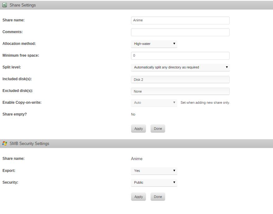

I click on a share and try and correct it, only include the disk that was originally designated for it and it accepts it.  No dice.
I go and browse the server via Explorer in Windows and when I access the correct disks, my files aren't there however they are being shown on the incorrect disk location.
Question 1: How can I correct this?

http://lime-technology.com/wiki/index.php/Upgrading_to_UnRAID_v6#Disks_shares_lost
The disk locations are where the files are actually located.    The easiest thing to do is to amend the share settings to point to where the files actually are.
The alternative is to do a Tool->New Config and assign the disks in the order that would be required to match the current share settings.

I've received several suggestions using the docker and I've found two (I think) posts on how to transition. I'll do that, cheers. I'm just continuing with drive replacements for now and I've replanted my share structure and will move my files around when disk movement is done. Thank you.
