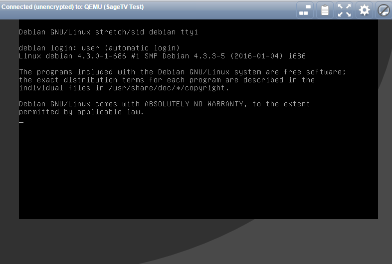

So I have been trying different things...for the gparted .iso case I replaced the ubuntu install .iso with the gparted live cd.iso and changed the boot order accordingly and I am able to boot gparted...however after answering the setup questions, about keyboard, language etc, It gets to video settings and then stops.  Attached is a screenshot of where it ends.  I am using VNC for the graphics...maybe I should try passthrough?
