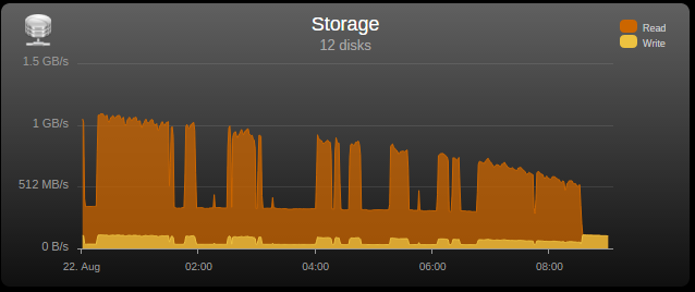

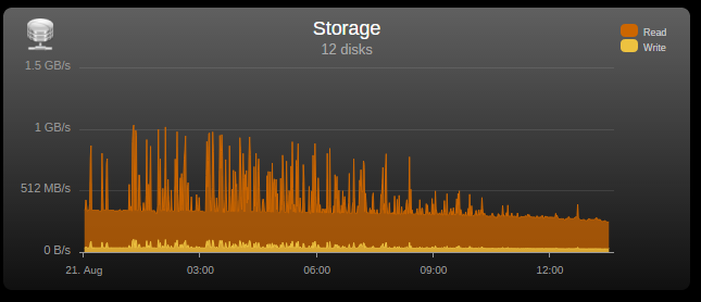

The average speed can vary wildly, these were my last two using these disks:
8:20:46 - 66.6MB/s
18:37:25 - 29.8MB/s
Best way to check for it is let it run for 1 or 2 hours and then use dynamix system stats to look for the variations, two speed examples below, a very bad and a medium one.
I believe there's nothing you can do, but I really wish you could prove me wrong, so it would fix it for me also.
