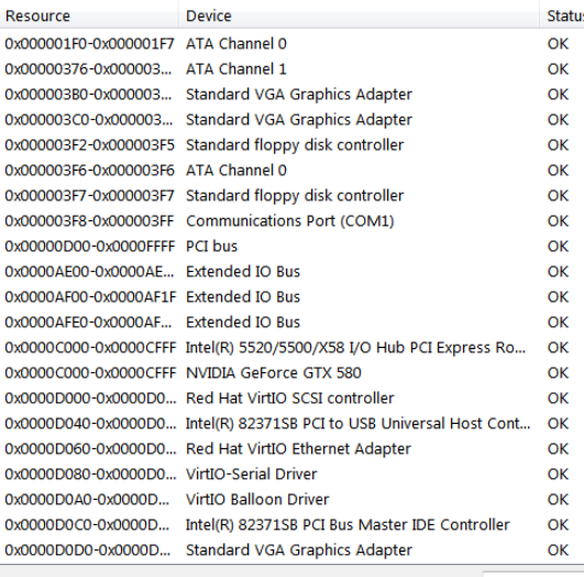

hi, im new to unraid and KVM VM's, ive set up the VM for windows 7 correctly, everything works expect the GPU which is coming up with a conflict in device manager, it is saying two devices are using the same resources as shown below. the config file is below too

if you need any more info please feel free to ask.
thanks
