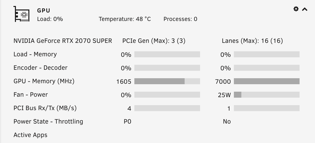

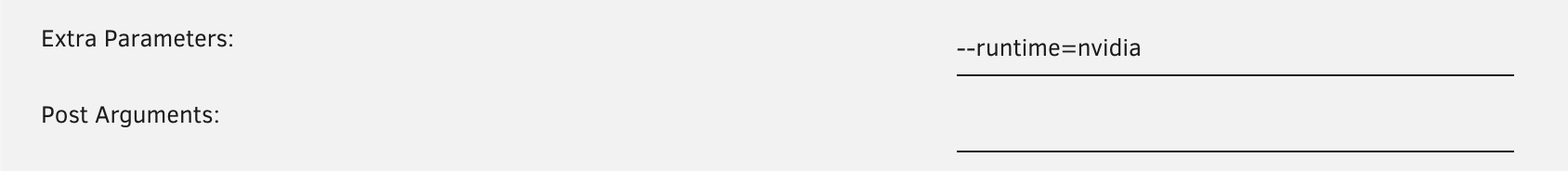

15 hours ago, tjb_altf4 said:
I'm guessing you missed adding  --runtime=nvidia  to extra parameters, as mentioned in the video around 10:00
yes of course I did.
@binhex any idea ? Please... 😢

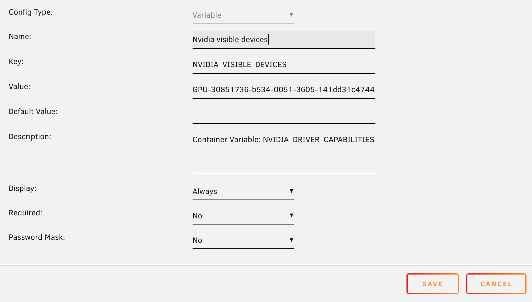

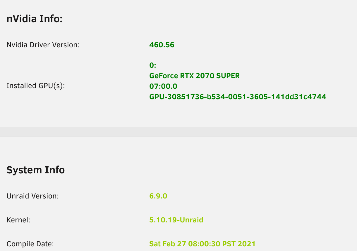

I am getting the same issue as THymon
Added the 3 variables but Emby not showing gpu as transcoding not does it show the GPU if you change hardware transcoding to advance in the menu.
Hardware transcoding doesn't work in this container, reported by many people. Switch to the official one or the linuxserver one and you should be good.
