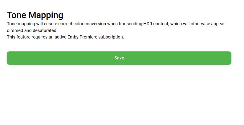

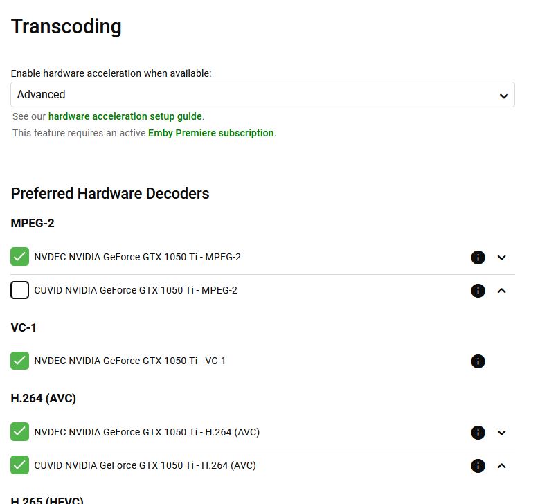

Should I expect HDR tonemapping to work? I have HWA setup, and I am a premier member. But this is all I see under the tonemapping section.
