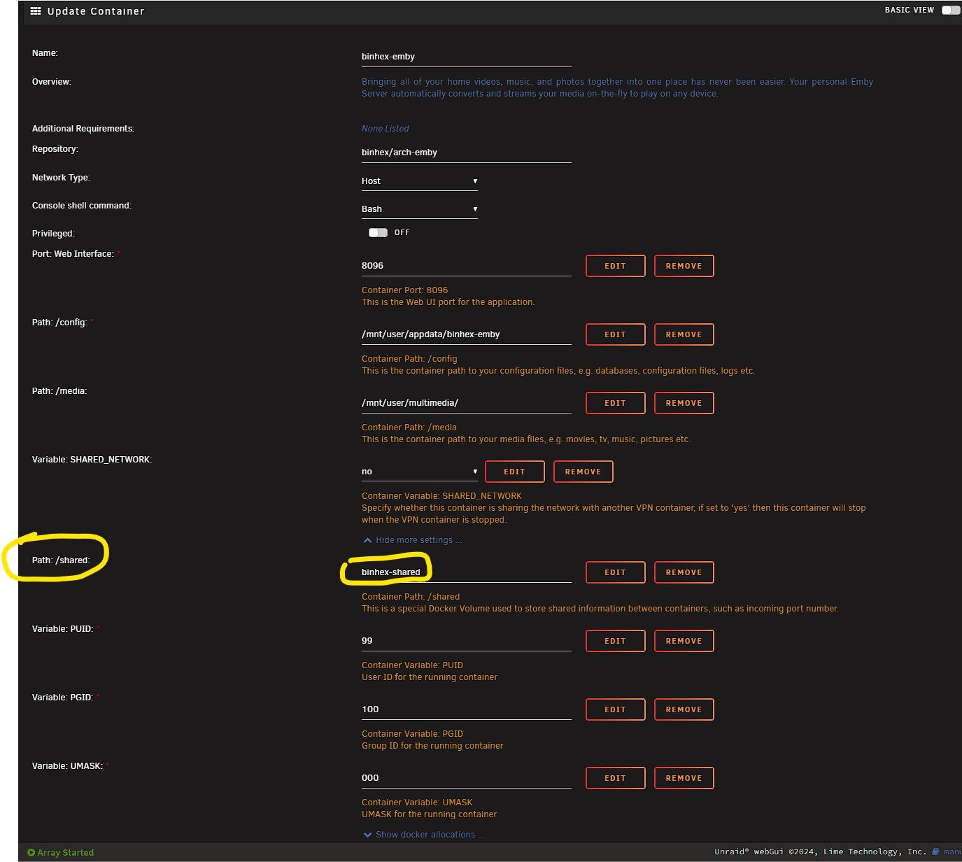

I am new to unraid. Setting up binhex-emby has been quite straight forward. However, can someone explain what is "Path: /shared:" for?
I can see the explanation is "Container Path: /shared... This is a special Docker Volume used to store shared information between containers, such as incoming port number."
  • First, I don't see this path in other docker images, so I don't understand how other docker images will be able to share information with binhex-emby?
  • Second, how does this technically work? Different containers will look into this directory on what ports are already claimed then pick new ports accordingly?
  • Third, if this is for all docker images to share info, I am assuming there is a default directory on unraid to facilitate this sharing already, so what is the default path?
The reason this is bothering me is that the "Appdata Backup" plugin keeps complaining the default value for the path does exist, but I don't want to set a wrong value.
That's because i am still in the process of updating all the templates to include it, and do note that template changes are not pushed out to users, you would need to refresh your template by deleting the container and reinstalling from CA.
Its a docker volume that includes a simple file that contains the assigned incoming port, the end user would then need to work out how to use that port number to configure the application, some apps are harder than others to configure.
It is not a host path, its a docker volume so you will not be able to see it or browse it from your host, its only visible from containers that have the docker volume mounted, if you want to see the contents of the docker volume then drop to the 'console' of a container and do 'ls -al /shared'
That is a bug in that plugin, it looks like it does not support docker volumes and is assuming (incorrectly) that its a docker bind mount and thus is trying to find the host path 'binhex-shared' which does not exist - ignore it.
