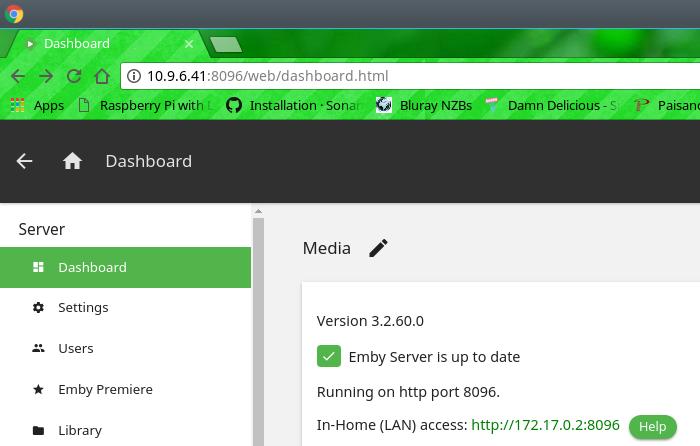

kcmccombs Posted December 26, 2017 Share Posted December 26, 2017 hello i just installed emby and i noticed something about the IP addr the local home ip is different from the actual ip. is this normal before my cli do not see the host so i have to enter the pc ip addr. thanks Quote Link to comment
JonathanM Posted December 26, 2017 Share Posted December 26, 2017 29 minutes ago, kcmccombs said: the local home ip is different from the actual ip Perfectly normal. The IP showing is in fact the IP of the docker container. As you found out, you need to use your unraid IP address and the port you mapped to the docker. 1 Quote Link to comment
kcmccombs Posted December 26, 2017 Share Posted December 26, 2017 4 minutes ago, jonathanm said: Perfectly normal. The IP showing is in fact the IP of the docker container. As you found out, you need to use your unraid IP address and the port you mapped to the docker. thanks for the fast reply Quote Link to comment
