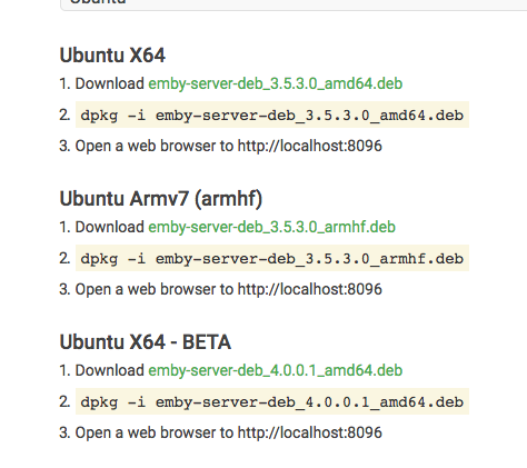

ok that has changed then, i had a look at the downloads page and it was marked as beta, in any case the new image wont be built until arch linux repo has updated, fyi here is the link:-
https://www.archlinux.org/packages/community/any/emby-server/
Looks like its still the case on the emby downloads page, note the BETA next to the download for 4.0.0.1 in the screenshot below:-

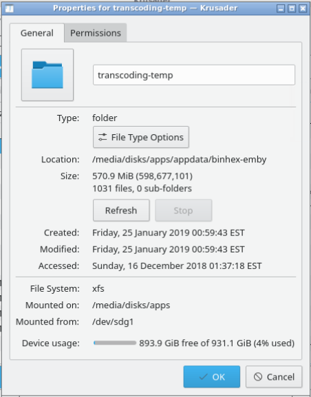

Hey there, quick question: where do files get transcoded to? Is it the appdata folder or the mapped folder in the Template?
Edit: actually I think I was able to answer my own question:
Edited by Coolsaber57
