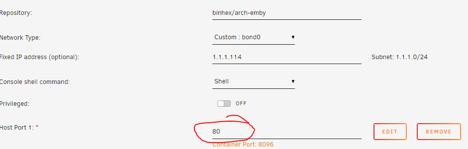

When setting up this container with a unique ip (custom setting) and changing the port to 80, it still only responds on port 8096, i've changed port in docker config:

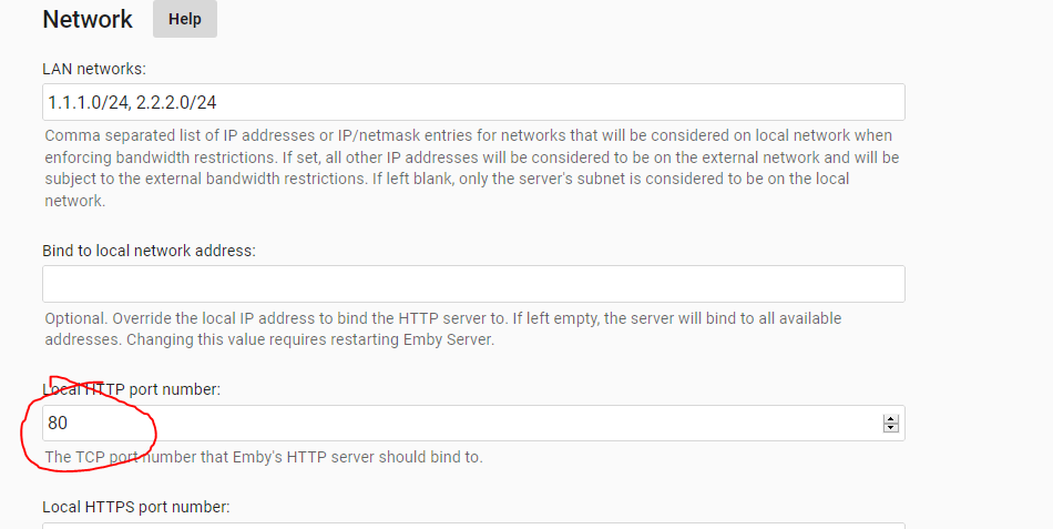

And ive also set port to 80 inside emby:
but for whatever reason the emby server still responds and works fine on 8096, it does not work on port 80.
ideas?
Thanks!
not a wise choice, this will no doubt clash with unraid web ui.
do not do this, you should never change the port for the application, this is hard set and does not need modification, you only change the host side port NOT the container side port.
You missed the part where he said he is not using unraid's IP, he set a different IP for this container.
Which is fine, as long as you know how to fix all the stuff that breaks when you do that. Probably not a good idea to start changing to container specific IP's without a thorough knowledge of docker network behaviour.
I have a pretty complex network, and I have yet to see a need to give any containers their own IP. Much easier to use reverse proxy to give them easily remembered domain addresses than trying to remember which service is on which IP.

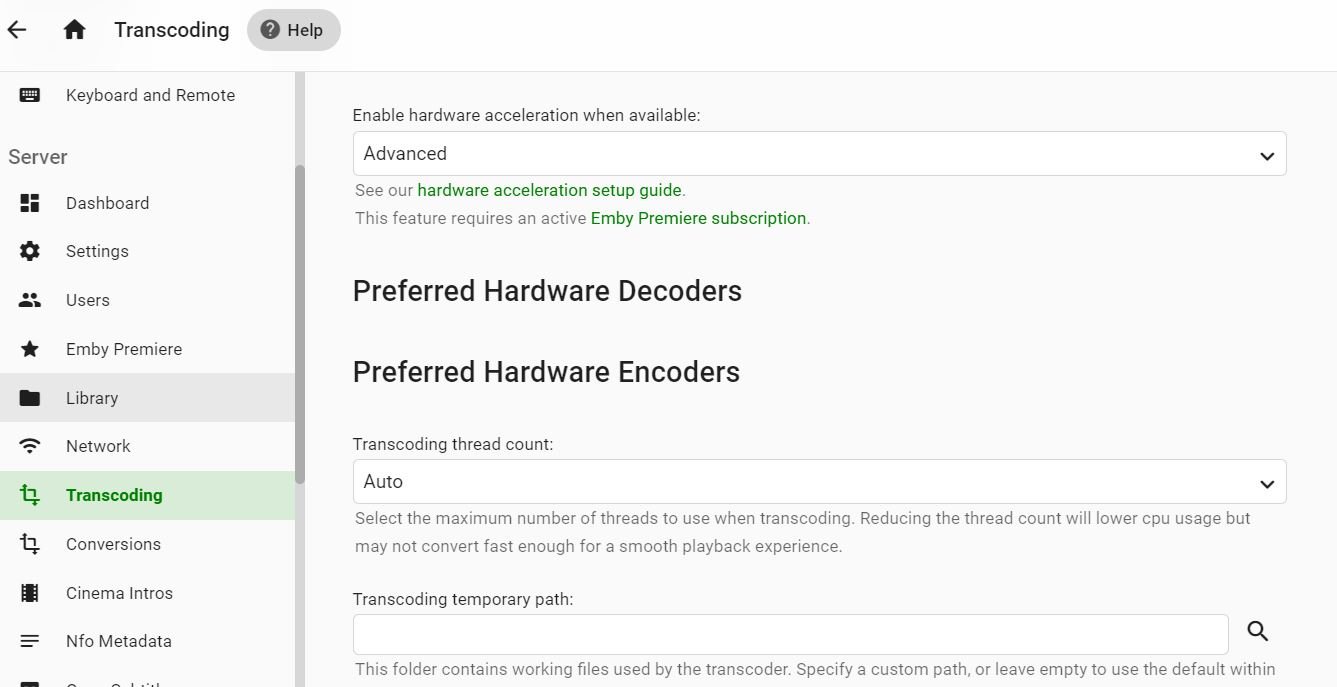

does transoding work now in this container? I just purchased Emby premiere today and tried to set it up with a P2000 but I can't get the card to show up under 4.4.2.0.
Edited by daan_SVK
Are you running the unofficial version of Unraid with nvidia drivers?
yup, basically followed the Spaceivader's video to the letter but transcoding with the binhex container doesn't seem to be working. No errors on the container log either. I just don't see the card at all.

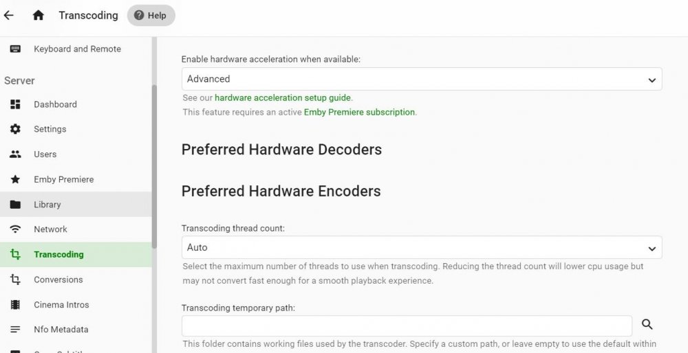

Has this been corrected. I'am having same issue . I even installed a different Emby docker and hardware encoding works on that one.
not to my knowledge. The official docker container works ok but I didnt find a reliable way to migrage the database so I have to start from scratch which is unfortunate as I lost all my user settings and watch statuses and such.
I would love an update from Binhex himself at least
