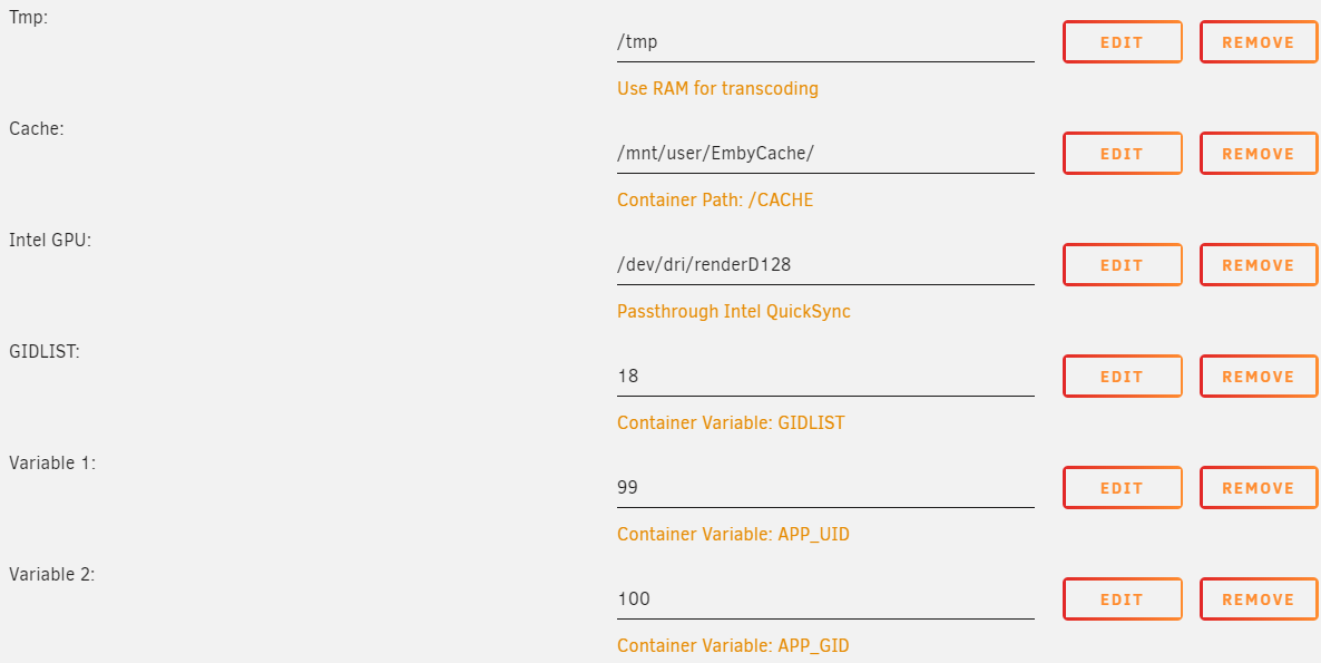

I can't get the hardware transcoding to work right now either.  I just built this server last week, Intel I5-10400 processor and running the latest binhex-emby docker container.  I have done all the steps in this thread and added the variables to the container settings (GIDLIST = 18, /dev/dri/renderD128) and even added their APP_UID and APP_GID after the first two alone didn't work, even though I'm pretty sure those are now replaced with PUID and PGID in the initial container settings.
I installed the intel-gpu-tools container to confirm that my system is finding the GPU correctly and it is.  I have a DisplayPort Headless plug in to make sure the GPU is active and enabled all the appropriate settings in the BIOS for it.
The emby container still isn't finding the GPU:

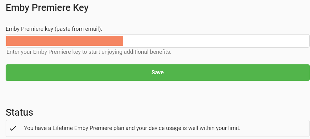

I do have a valid Emby Premiere key in place.
So.... now what? Has something changed in recent releases on what the variable names need to be to find the GPU?

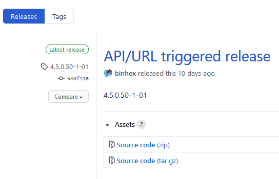

4.5.1.0
1 hour ago, thymon said:
Hello ! :)
New update is coming for this docker ? 😛
4.5.1.0
I was wondering the same. It was released 4 days ago. Here are the fixes in the new version:

I am also looking for the new update. Any news on when or if?
Also was wondering on the update, it shows 4.5 up as part of releases at least.
Don't think anything is too critical in that update either.
Hopefully everything is OK with you @binhex!

3 hours ago, thymon said:
4.5.0.50 ???
Why my Server is on 4.4.3.0 ?
Same, guessing it's an issue with the upstream maintainer not updating package correctly

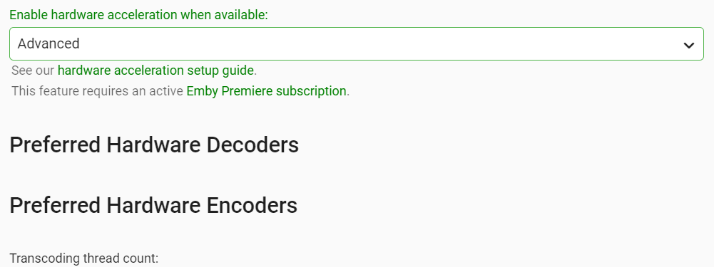

Has anyone been able to enable quick sync with this container? I have an i3-10100 cpu and enabled iGPU in the bios. I'm able to see the iGPU in /dev/dri, pass the /dev/dri device has a parameter for the container, but I can't see the iGPU in the transcoding section in Emby, under Advanced.
I don't think hardware transcoding is working in this container. IIRC there have been lots of people in this thread complaining about it not working. Switch to the official emby container or the linuxserver one.
After many hours of headache, you are my savior. Took me 2 minutes to setup with the linuxserver docker. Thank you, kind man :)
