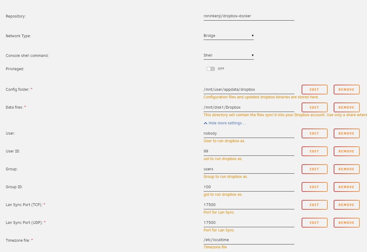

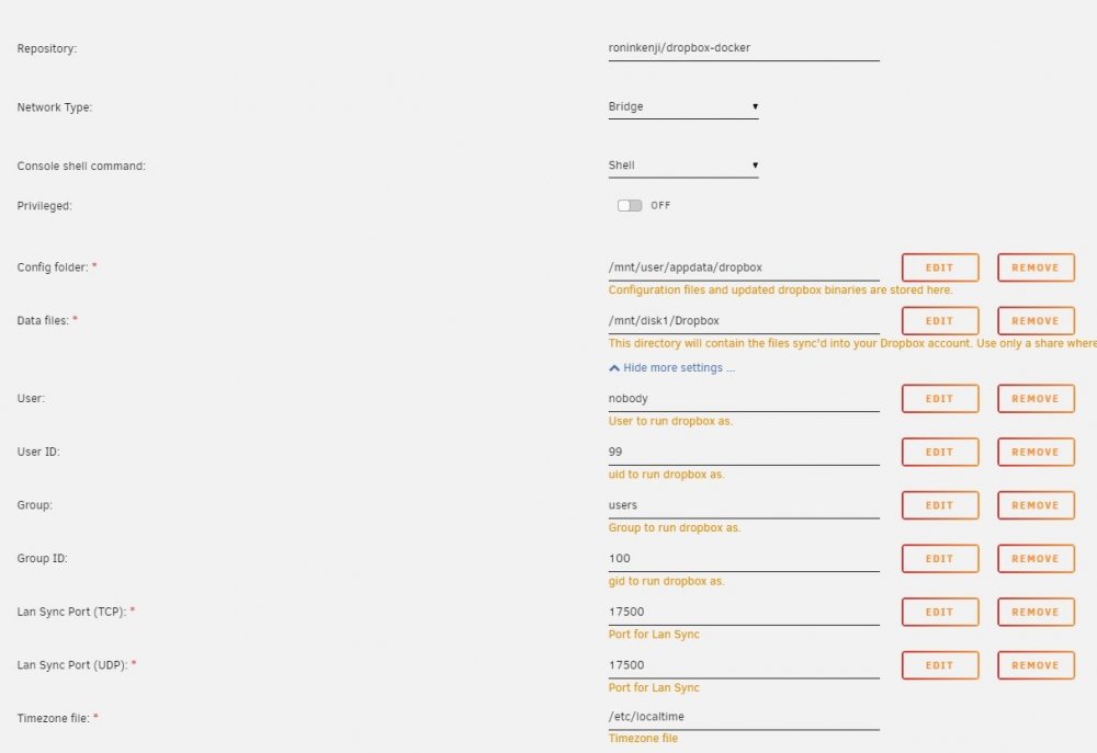

Right, I guess I wasn't clear, but you need to to use a specific disk for the Dropbox share since you don't have a cache drive.
Since you already have a Dropbox user share, it probably is on disk1, and you can confirm from the Web UI Shares Tab, Click on Compute for the Dropbox share and it will return where the share is currently saved to.
Edit the docker to change /mnt/user/Dropbox to whichever disk is used for it ie /mnt/disk1/Dropbox for disk1
Some caveats with this configuration. If you create/edit files over Samba to the Dropbox share, there is the possibility that files might end up on the other disks and would then be not seen by the Dropbox container. You should edit the Dropbox share to limit it to only one disk.
Thanks for your patience. Very helpful and seems to have actually worked :) I'm sure it was working before when not constrained to a single disk but hey ho.
Appreciate it a lot as now I don't need to run a slow VM.

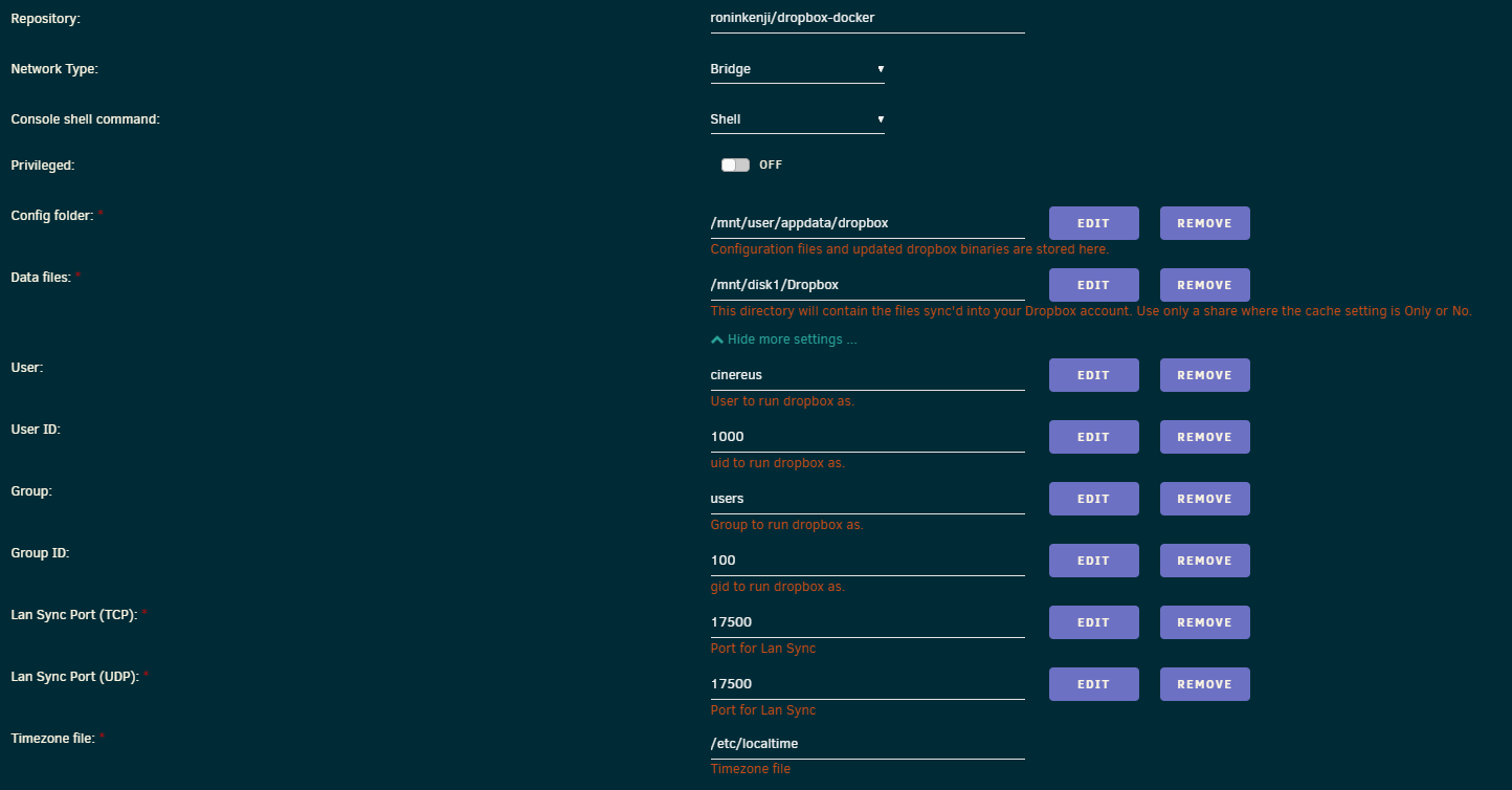

The files in the Dropbox folder are owned by my user account not nobody. But if I use the user account I can't start it either.
sh-4.3# su - cinereus
cinereus@6ee6f0503f8b:~$ dropbox.py filestatus
Dropbox isn't running!
cinereus@6ee6f0503f8b:~$ dropbox.py status
cinereus@6ee6f0503f8b:~$ dropbox.py start
Dropbox is already running!
I think you've misconfigured the container somehow... can you should me the docker configuration again?
It has been working without issue for weeks and I haven't even rebooted the server.
Can you restart the Dropbox container and attach the log? Probably starting from the last dropbox: initializing line
You've done something really wrong.
Please refer to the first page for some details, but in a nutshell, you used the container to run a copy of dropbox client as the container root user, which now places the files inside the container image.
Start over (delete the container, and re add it)
When the container has started up, view the logs of the container (which will show you the link url)
Link your account, and wait a bit as it will now populate the directory for the Data files.
If you ever access the shell to check anything, you'll need to run
su - nobody
before doing anything else, as the dropbox client is running as nobody user instead of the default root.
