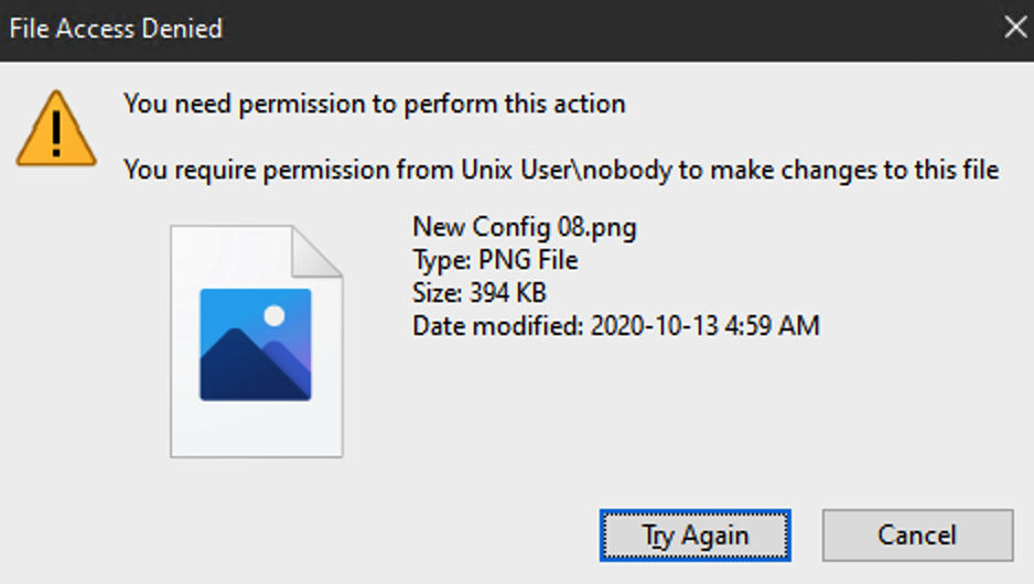

Hi, just installed and got all files sync and updated.  but can only modify files in the Dropbox root folder.  if i go into a directory (example dropbox\my files)  i can read the files but it won't let me modify or create any files.
any help is appreciated
thanks for the great docker!
Running inside Windows 10 VM
Dropbox share is set to "public' in SMB share

UPDATE: just ran 'Docker Safe New Perms" now i have access...
is this normal?
thanks

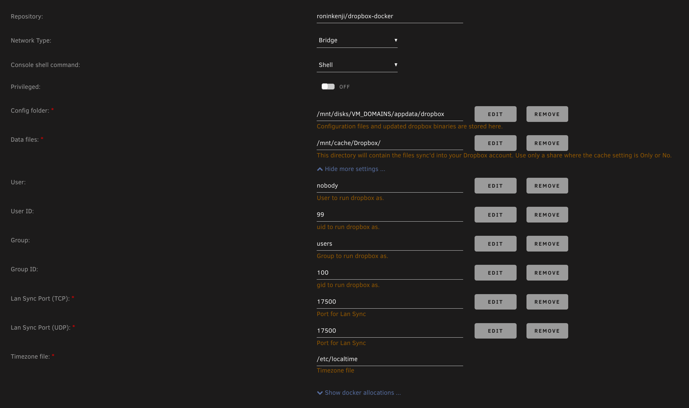

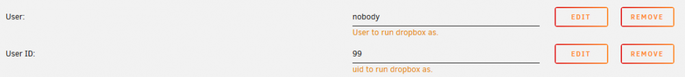

This Docker container will run stuff as the nobody user, hence the error message above regarding permissions. Docker Safe New Perms will work until new files get sync'd or updates are made.
I'm guessing, but are you accessing the Dropbox share in guest mode (ie its set to Public) while you have a user in Unraid that the Windows PC you have is set to use/match? (Windows Credentials in Settings)
If so, you probably want to blow away this container and the appdata/dropbox and Dropbox share/folders (ie really start over)
Then when you reinstall the container, before linking to your account, make sure that the user id to run as is set to the user id of your user (the one windows is using to connect to)
If you don't know your user id, just open a terminal to Unraid and run this
root@MediaStore:~# id username
uid=1000(username) gid=100(users) groups=100(users)
which is usually be 1000.

but what happens when i access dropbox from another PC with another different user name??
Because Dropbox is meant to be run and used by a single user, the container must create files as a single user and any access over Samba/NFS shares must result in the files being owned by the same user or some issues will occur (like being unable to update directories and files modified from other devices)
There is a setting you can apply (just not sure how it will mess things up further for you)
in Settings | Samba | SMB extras I added under the [global] section
force user = nobody
force group = users
this makes it so that all access to my files over Samba will be done as the nobody user (and the group users - but this is usually not important).
Enabling this will probably break any existing share that is Secure, Private or even Public ones - if the files and directories have been created with the existing users you may have defined. (Running either Fix Permissions tools on the affected shares should fix the issue though)
You can turn this on and make some tests on a existing share so you understand what it does though, as reversing it is fairly easy by just removing the lines.
I was suggesting that Unraid enable this out of the box, but there's no way AFAIK to do it and not cause issues with users who do not want to enable this.

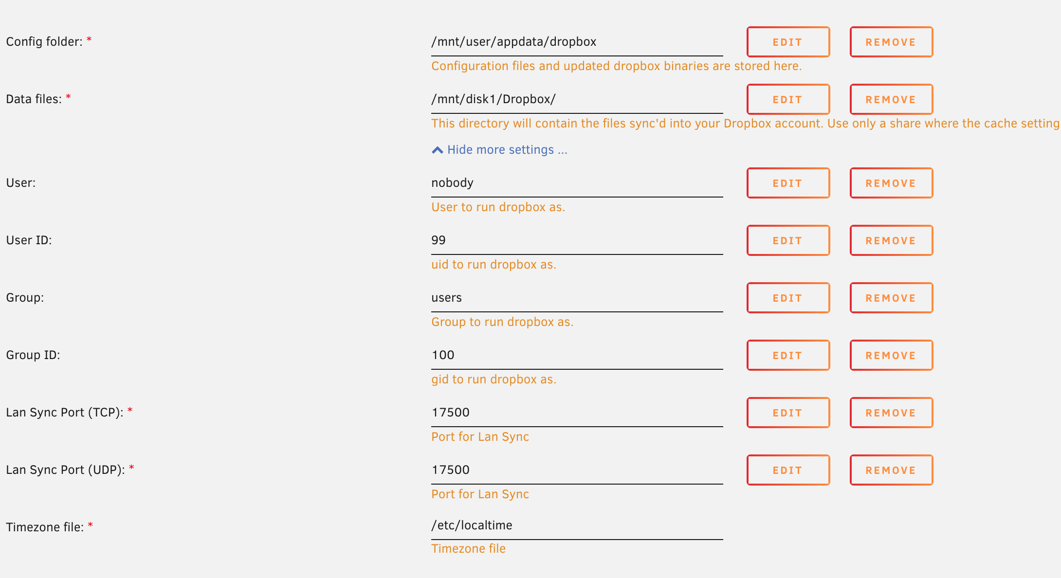

hi ken-ji thanks for the docker image.
could you please summarize
1. what needs to be done so that the synced dropbox data can be shared over SMB ?
2. what needs to be done to allow autostart after unraid restart or array restart?
Edited by theruck
@theruck
for #1, by default the Dropbox data is shared over SMB. the defaults assume you are using Unraid in the default public share mode
If this is not the case (you are using user accounts, set User and User ID to the appropriate user)
refer to this for more details
For #2. Just set the autostart button to on on the Dockers page

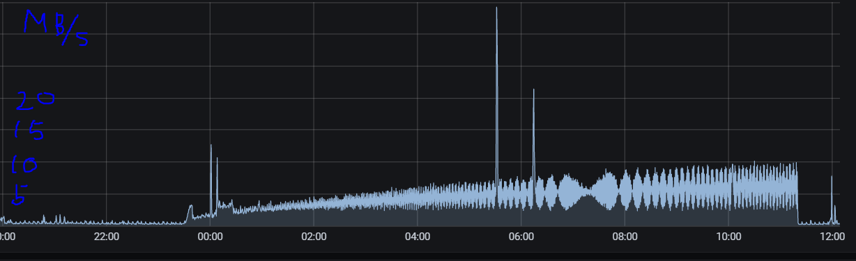

Hi I experienced a problem after starting my dropbox container yesteday, and it ran overnight.
This morning i saw a lot of writes comming from the container, and it has been going on for the whole night, just since i started the container. The writes are increasing every little time. Any idea what is is?
I can say that during this time, it seems that the dropbox container was not linked to my account, though i had set it up once before, working fine.
I attached an image from my grafana-telegraf setup showing the writes to my cache drive.
In this time interval there was no activity on my Dropbox account.
Explanations:
23:30 i manually turned on Dropbox container
11:20 i shutdown the Dropbox Container because i saw all the writes going on.
12:00 i restarted the container and linked it to my account.
After 12:00 i have not seen any unexpected behaviour from the Dropbox Container.
All of this is done on Unraid 6.9.1
Any idea what happend?, it causes about 500GB wear on my new NVME SSD in about 12 hours.
Edited by Struck
Explanations:
After a reboot, this seems to be happening again. and again the container is unlinked from my dropbox account.
It is likely because i am using a basic plan, and have 7 devices connected to it, (max 3 allowed) but that does not explain why this container has excessive writes when unlinked.
Idea: Some write amplification? log file or anything else?
I am not sure about writes, but while it is not connected, it will definitely be writing out the connect to an account message to the docker log for the container.
