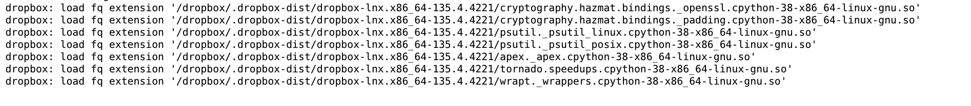

the log only shows this from the creation of the container:
chown: cannot access '/dropbox/.dropbox': No such file or directory,
dropbox: load fq extension '/dropbox/.dropbox-dist/dropbox-lnx.x86_64-126.4.4618/cryptography.hazmat.bindings._openssl.cpython-38-x86_64-linux-gnu.so',
dropbox: load fq extension '/dropbox/.dropbox-dist/dropbox-lnx.x86_64-126.4.4618/cryptography.hazmat.bindings._padding.cpython-38-x86_64-linux-gnu.so',
dropbox: load fq extension '/dropbox/.dropbox-dist/dropbox-lnx.x86_64-126.4.4618/psutil._psutil_linux.cpython-38-x86_64-linux-gnu.so',
dropbox: load fq extension '/dropbox/.dropbox-dist/dropbox-lnx.x86_64-126.4.4618/psutil._psutil_posix.cpython-38-x86_64-linux-gnu.so',
dropbox: load fq extension '/dropbox/.dropbox-dist/dropbox-lnx.x86_64-126.4.4618/apex._apex.cpython-38-x86_64-linux-gnu.so',
dropbox: load fq extension '/dropbox/.dropbox-dist/dropbox-lnx.x86_64-126.4.4618/tornado.speedups.cpython-38-x86_64-linux-gnu.so',
dropbox: load fq extension '/dropbox/.dropbox-dist/dropbox-lnx.x86_64-126.4.4618/wrapt._wrappers.cpython-38-x86_64-linux-gnu.so',
dropbox: load fq extension '/dropbox/.dropbox-dist/dropbox-lnx.x86_64-126.4.4618/PyQt5.QtWidgets.cpython-38-x86_64-linux-gnu.so',
dropbox: load fq extension '/dropbox/.dropbox-dist/dropbox-lnx.x86_64-126.4.4618/PyQt5.QtCore.cpython-38-x86_64-linux-gnu.so',
dropbox: load fq extension '/dropbox/.dropbox-dist/dropbox-lnx.x86_64-126.4.4618/PyQt5.QtGui.cpython-38-x86_64-linux-gnu.so',
This computer isn't linked to any Dropbox account...,
Please visit https://www.dropbox.com/cli_link_nonce?nonce=20044a5727078b85e3cdd9457a105b5e to link this device.,

Any ideas? I never see any of the stuff like this in the logs (copied from other posts here, never see this on my system)-
dropbox: initializing
dropbox: initializing python 3.7.9
dropbox: setting program path '/dropbox/.dropbox-dist/dropbox-lnx.x86_64-109.4.517/dropbox'
dropbox: setting python path '/dropbox/.dropbox-dist/dropbox-lnx.x86_64-109.4.517:/dropbox/.dropbox-dist/dropbox-lnx.x86_64-109.4.517/python-packages.zip'
dropbox: python initialized
dropbox: running dropbox
dropbox: setting args
dropbox: enabling allocator metrics
dropbox: applying overrides
dropbox: running main script
