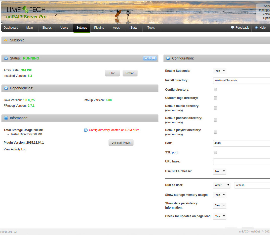

Well I went ahead and installed Subsonic.  That went fine, but I'm not sure what I'm doing setting it up.  I believe I got the ports forwarded correctly on my router, but I'm not sure what's next in the actual Subsonic settings.  My Music share is named Music, so would the path be /Music?  I've also tried creating a user which didn't seem to work.
Is it installed on unRAID, if so is it a plugin or Docker?  Provide as much info as you can so people have an idea of how you are running it and how you have it configured.
I installed it via a plugin from "community applications". The author of the plugin is PhAzE.
Edit: I've attached a screenshot of the config page.  As you can see there are fields on the right that need information entered, but I'm not sure what to put.  Apparently the configuration is running in RAM too because I need to chose a directory.  I have no clue what the directory structure should look like in these settings.  I tried setting the music directory to /Music, but that didn't work.  Also initially the web UI button would launch me in to Subsonic, but that has now stopped working.  So clearly I've messed things up.

Even though I don't use PhAzE plugins,  I can tell you this:  The run as user should probably stay as default (either root or nobody -> whatever it comes up with)
Also, your config isn't persistent and will be lost upon reboots (stored in RAM drive).  (hit the check box for the config folder?)

Lantesh, if you have a cache drive, set the install path for the plugin to a cache-only share, such as /mnt/cache/apps/subsonic.  Make 'apps' cache-only on the GUI shares tab, or prefix the folder with a dot: /mnt/cache/.apps/subsonic.  Setting it cache-only prevents the mover from moving your apps folder to the array.  Set the user as 'nobody'.  This is Linux thing to prevent the program from having administrator privileges.  Once Subsonic is running you can create users within the program.

So tomorrow I'll make some time to work on the configuration.  Thank you for the tips you posted.  I'll utilize them, and see if I can get it going.  Some additional info - I don't have a cache drive, so I'll have to create a share on the array, and set it to that.
This post was the most helpful of all the replies I received.  I actually got everything working now!  I just had to wrap my brain around a few things.
It took me a bit to realize that while the plugin was installed to my flash drive that the program itself was only running in memory.  Once I understood this it made more sense.  First I set up a share called apps, and inside that created a folder named subsonic.  I modeled this after Unevent's instructions listed above.  I don't have a cache drive so I put it on disk1.  I was then able to set the install, and config directories to this path.
The next issue I ran in to was I couldn't figure out how to map the music path to my music share.  I could set a hard path like I did with the install, and config directories, but not a share path.  I'm sure you can do it, but I couldn't figure it out.  So after thinking about it for a bit I reconfigured my music share to exist solely on disk1.  This way I could hard map to it, and when accessing the server remotely I'll only be spinning up one drive.  I'd like to know how to properly list the share path at some point, but for now it isn't relevant anyway as the hard path works.
The next issue I ran in to was accessing Subsonic outside of my local network. I forwarded port 4040 as the instructions indicated, but it simply wasn't working.  I not only forwarded the port from my router, but also from my modem to the router, so this really had me stumped.  I ended up finding the solution on a router support forum where someone having the same problem stated his solution was to put the IP address for his router in the DMZ on his modem.  This worked!  So for some reason my modem would not push the traffic through port 4040 even though I had it set to forward it, but by putting my router IP in the modem's DMZ it opened things up.  I suppose this is less secure, but my router in theory should stop all unwanted incoming requests.  The fact that a port is open at all is a security risk.  I may have to look at alternate methods in the future, but for now I'm just happy that it is working.
