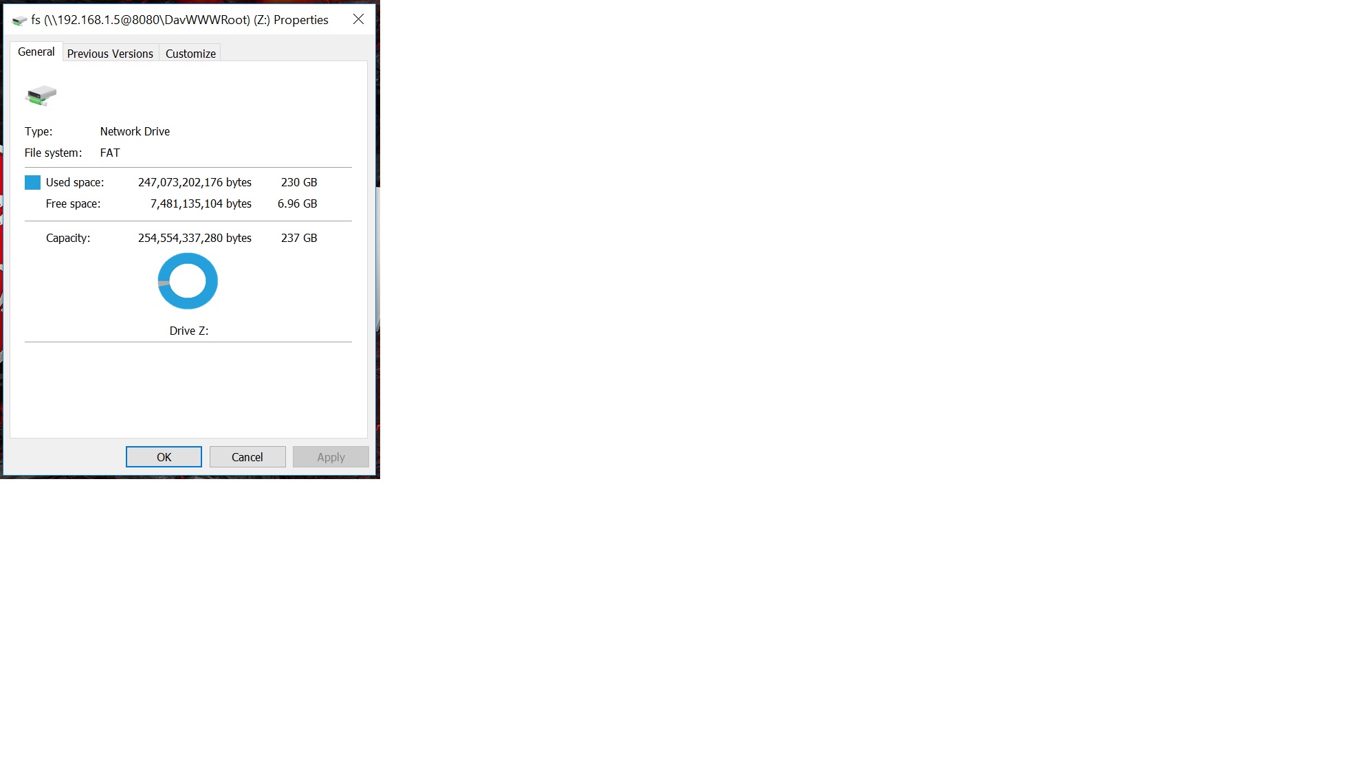

nice program but I can't seem to move bigger files and when I check the space available I get tolled there is only 7GB

Tryed this for the first time today. This works better than moving files into a drive share from my Mac. After I moved 50 files, It reported that additional transfer failed because directory was out of space. So how do I increase the space so I can continue to add files.
