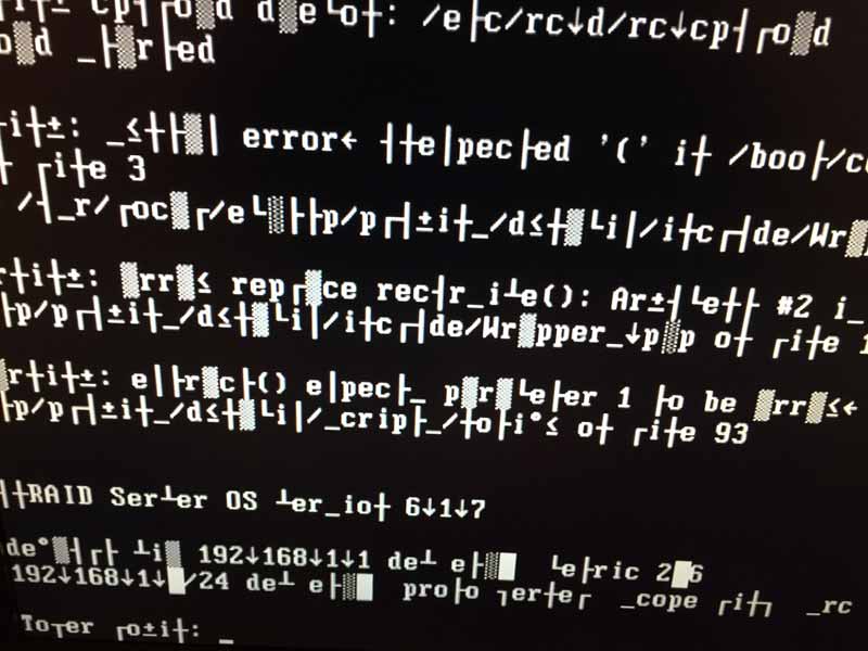

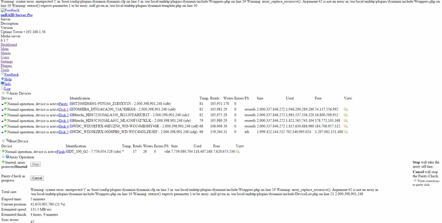

I ran an update from 6.1.6 to 6.1.7 from the web interface. Everything seemed to go fine, when I rebooted the server, it went through it's normal boot process. But at some point along the way, the text starts to glitch out. I attached a screenshot. Furthermore, the web interface doesn't look right either. I've rebooted the server and the same thing happens. The data appears to be fine.

Sounds like bad RAM to me. I think the update was coincidental.
Could it also be corruption of the Flash drive file system?
Console corruption makes me think RAM. I guess maybe if the console fonts are reloaded from the flash at some point in the boot process? Temporarily booting just the USB stick in another box and looking for console corruption would be a good test.
Here's a dumb question, should I have a plugin for dynamix in my Plugins folder? Not sure if that was brought over from my 5.0.x upgrade, but from what I've read Dynamix webGUI is now built into 6.0. The errors shown on the web interface point to "/boot/config/plugins/dynamix/dynamix.cfg" and other Dynamix issues. Maybe it's just a display issue from that? Not sure what the file is suppose to look like, but I attached the corrupt text looking .cfg file.
Or do you think it's still a possible RAM issue?

* I agree with jonathanm, bad RAM is a strong suspect, and when RAM is even remotely suspect, then you don't want to do *anything* else with the machine, until it can be fully trusted.  Using the machine in any way could be causing more stuff to be corrupted, if there's bad RAM.  MemTest is imperative, before anything else.
* That dynamix.cfg has been overwritten with binary garbage, so you don't want it, needs to be deleted.  It will be recreated on the next boot.
* The OS after attempting to load looks severely corrupted, possibly because of the RAM, and possibly because files on the flash drive have been corrupted.  It would be a good idea to manually reinstall unRAID on it, and might as well use the latest - v6.1.8.

Thanks for the tips guys. Here's what I did. I deleted the folders /config/plugins/dynamix and /config/plugins/dynamix.kvm.manger and the web interface immediately turned back to normal. Then I did a reboot on the server, and everything looked correct again (no jumbled up/corrupt looking text). I'm going to run a parity check (it did say the last check found 42 errors!) and continue to monitor things a little closer to make sure it isn't bad RAM. Since my issue only started right after I did the update, I'm wondering if something got corrupt during the update on the Dynamix side of things.
