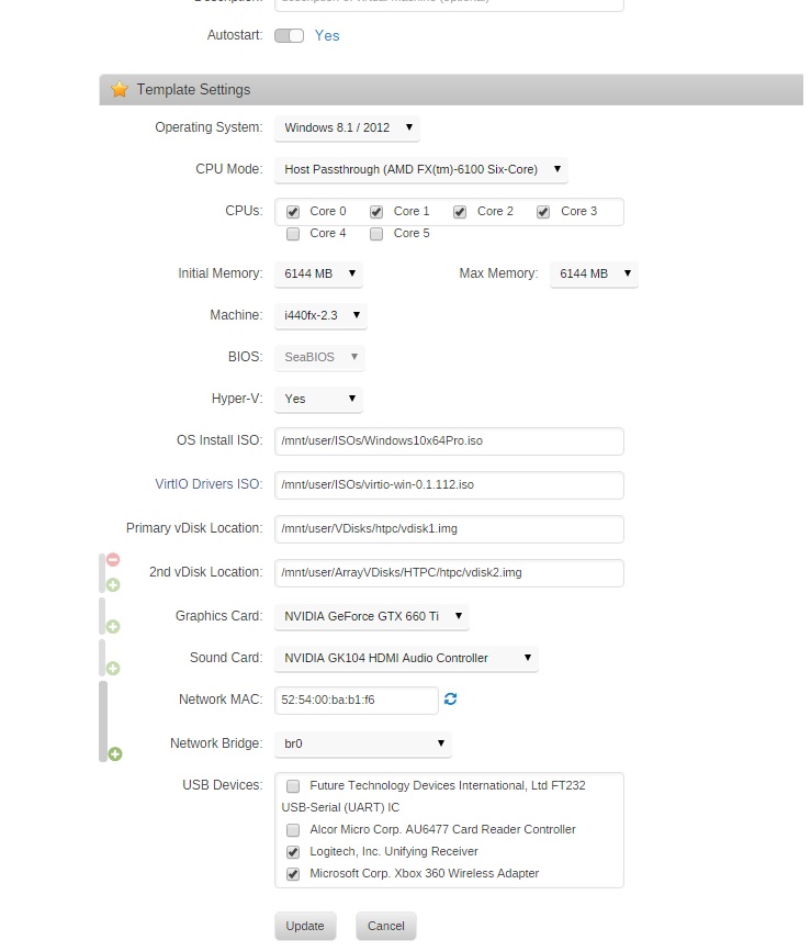

I recently made a windows 10 vm to play games on since my server is connected to my living room tv. I have everything I want added via pass through except for my steam controller. Unraid doesn't even seem to acknowledge its existence, lol. Am I the only one who has run into this problem? I've attached a screenshot of my vm settings.

Does it show up in the devices section in tools? You might have to set it manually rather than using the GUI.

It doesn't show up in the device list. It's as though it doesn't see it at all. I may have to try connecting it via wired connection and go from there.
Best thing you can do is passthrough a whole usb controller. Then anything you plug into it will work plus you will have the benefit of usb hot swap.
Guide is here http://lime-technology.com/forum/index.php?topic=36768.0
I'll look into trying this. I've ran into problems trying to pass through my usb 3.0 expansion card, though that may be more of a driver issue than anything.

If its wireless (I didnt know) then you will have to passthrough the receiver (Blutooth or whatever) and then pair it in the OS. If its bluetooth then it wont show the controller as a unique device.
Ok, so to update. Rather than pass through my entire usb controller, I just passed through a usb 3.0 add-on card I had forgot I had. I ran that into a small hub and now I have everything working great. Thanks for all the help everyone!  ;D
