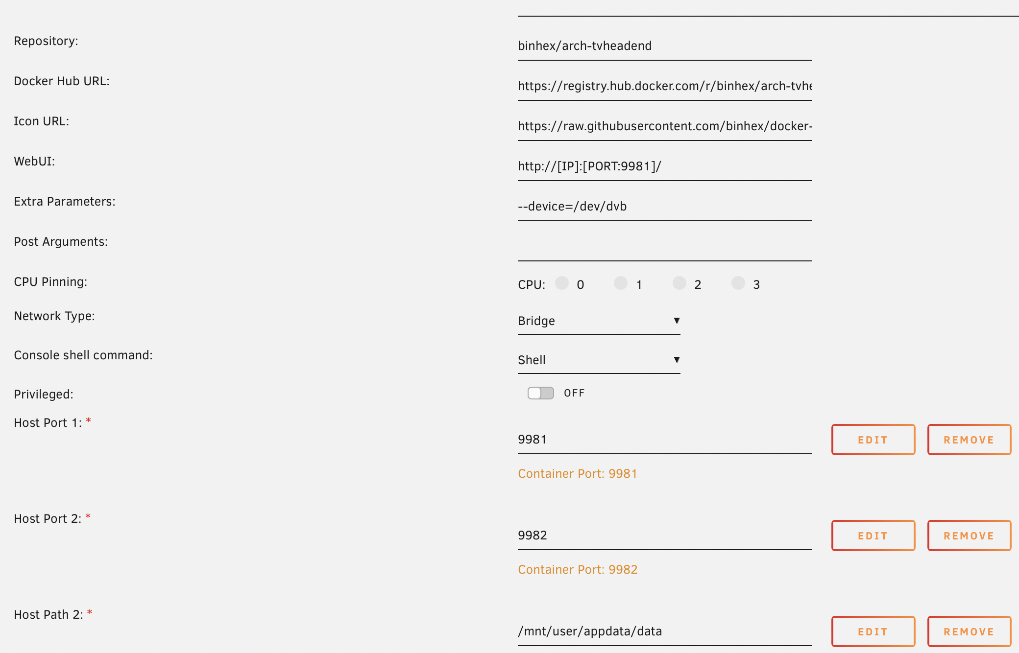

I cannot get the application to start:
docker: Error response from daemon: error gathering device information while adding custom device "/dev/dvb": no such file or directory.
I have no tuner card, I want to get my IPTV stream onboarded in Tvheadend so I can connect Kodi to it.
Not even sure if this is the right way to go about it.
as  you dont use a tuner, remove the extra parameter ...

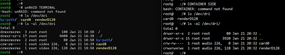

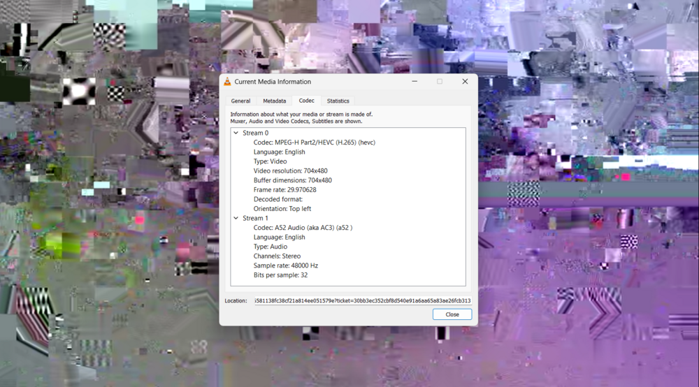

I recently updated hardware from i5-9600T (UHD 630 iGPU) to i7-11700t (UHD 750 iGPU) and also unRAID from 6.12 to 7.2.3.
TVHeadend can no longer record with vaapi intel acceleration. I see with intel_GPU_top that it is using the device, but I only get proper audio with some scrambled color video blocks/blobs. When running 'ls -al /dev/dri' in the container terminal(right), I noticed it doesn't say video(just audio) like it say in the main unRAID terminal (left):
Can someone that has VAAPI transcoding working please run the ls -al /dev/dri and give me the output from the TVHE container console? Any tips appreciated. I did see multiple reports of issues with 10th and 11th gen iGPU but they all seem to be from around 2021 and it seems should be fixed by now.
This is what the video recording looks like:
