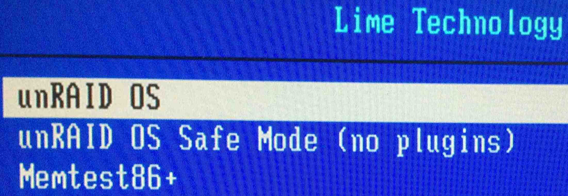

as far as I know yes. I get a screen that ask what to boot, unraid or unraid safe (both are giving the same error).
if I go into the UEFI setup utility of the motherboard I can choose to boot USB with the unraid on it

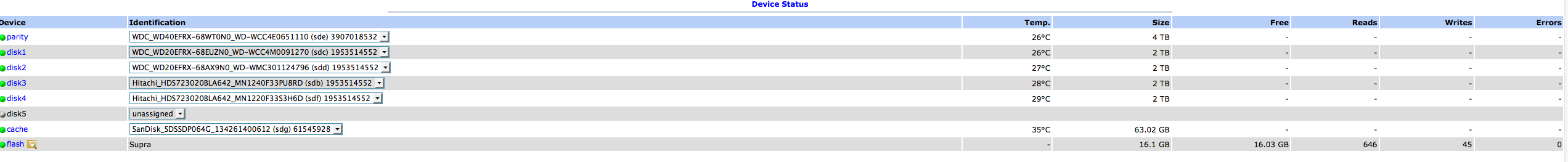

I did a clean install on another USB drive (just to try) and it worked and I can see my drives etc... but because I have 4 drives and a cache I cannot access to them.
So if I transfer my Plus.key file in my new config file I should be good to go ?? Then I re-allocate the drives the way they were before and that's it??
