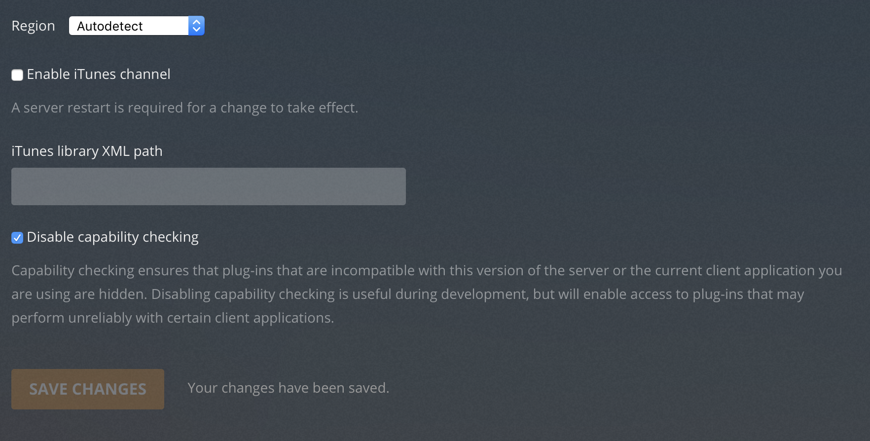

July 28, 20179 yr 25 minutes ago, Hogwind said: I think you need to go the the plex web gui under channels and in webtools fill in your plex username and pass if you haven't done that already. Thanks for your quick response @Hogwind! I should have also mentioned that I checked there too. I also went to Settings > Channels and turned off "Disable capability checking" and still don't see anything named WebTools or similar within Channels. After every attempt restarted the Docker and when that didn't have any effect, rebooted the entire server. Still nothing.

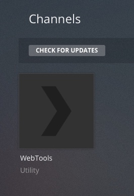

July 29, 20179 yr I have it installed and I can see it but I only have the Plex logo on it not the WebTools logo. I'm thinking it might be a permission issue maybe, any ideas?
July 29, 20179 yr I did like ljm42 in the second post, launched plex gui and there it was under channels. The only difference is that I copied the plugin to a share in unraid and then used krusader to copy it to the plugins folder. I couldn't copy it directly from the windows machine because of permissions. Edited July 29, 20179 yr by Hogwind
July 29, 20179 yr I have it under channels, thats the pic above. It just won't launch. I copied it over without a problem but I still think something is wrong since it's not showing the Webtools logo. Any ideas? Only other thing I can think of is maybe I have something else running on that port, I will check that when I get home Edited July 29, 20179 yr by squirrellydw added something
