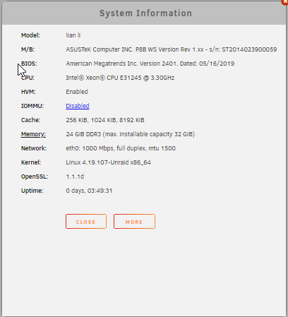

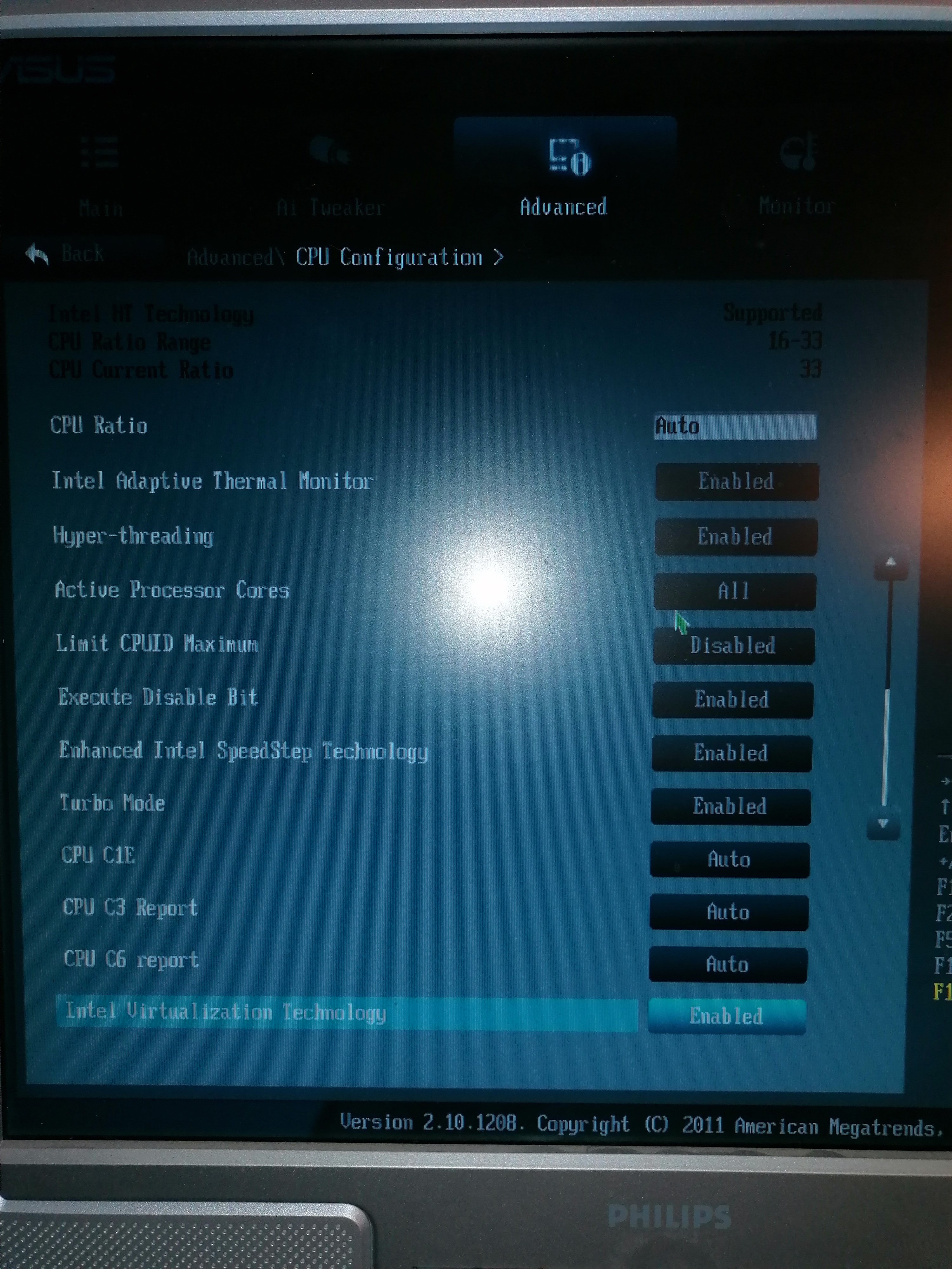

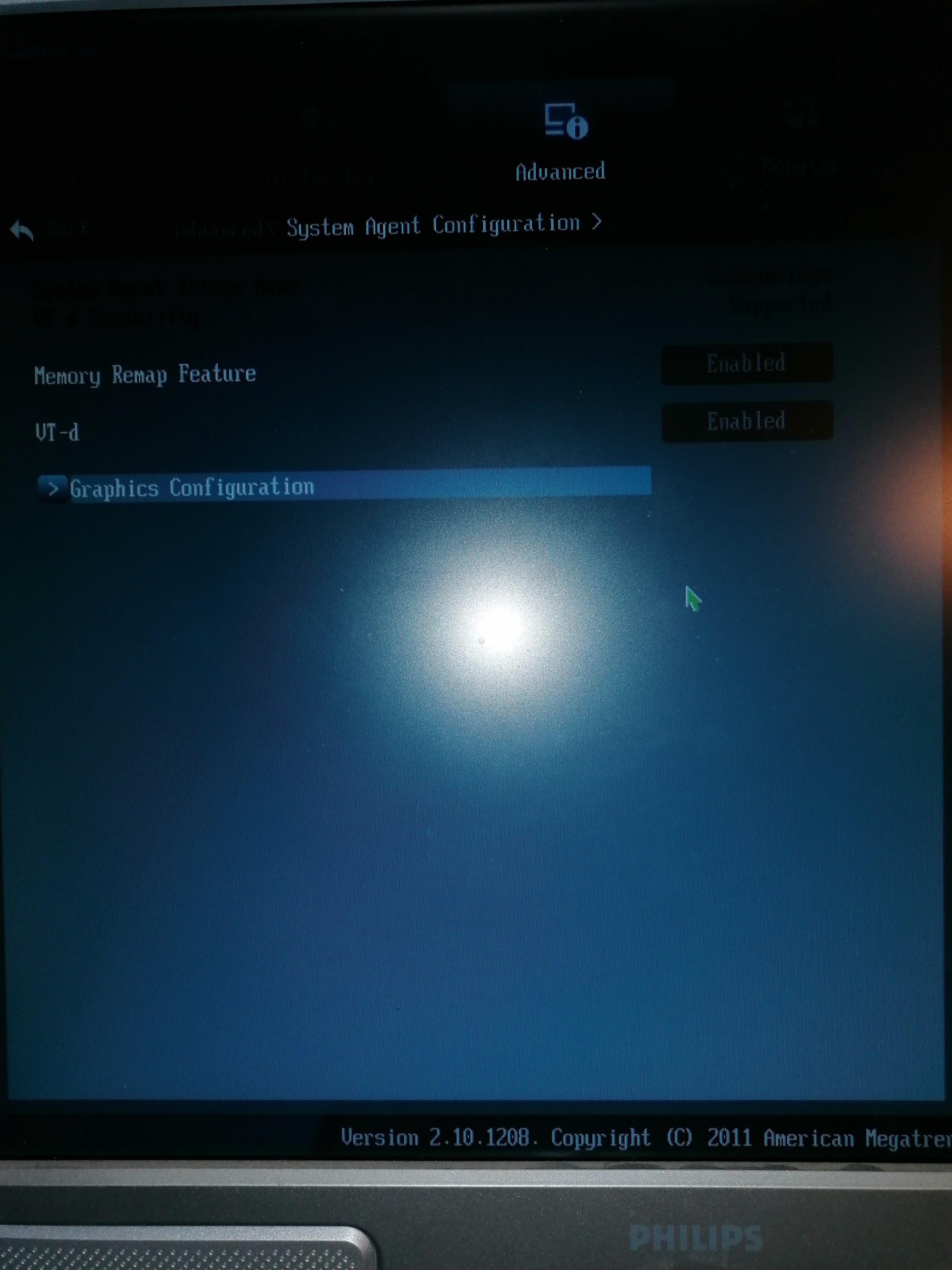

I have a Asus P8BWS motherboard with VT-x & VT-d enabled. Bios version is last one from 2019.
https://www.asus.com/us/supportonly/P8B WS/HelpDesk_BIOS/
CPU is Xeon E3-1245.
https://ark.intel.com/content/www/us/en/ark/products/65729/intel-xeon-processor-e3-1245-v2-8m-cache-3-40-ghz.html
So everything should be fine in order to pass trough PCIe devices, but IOMMU appears disabled in unraid .
Please note that years ago i was able to pass trough devices such as HardDrives to ESXi in RDM mode of vsphere.
Is it something not working as expected in Unraid OS version 6.8.3 for IOMMU support?
Here enclosed some more info for ur support please
any advise welcome
tower-diagnostics-20201122-2226.zip
As far as I know Unraid simply goes by what the BIOS reports for IOMMU.
em... ok so how is it possible that it is stated that IOMMU is disbaled as the VT-d is enabled in BIOS?

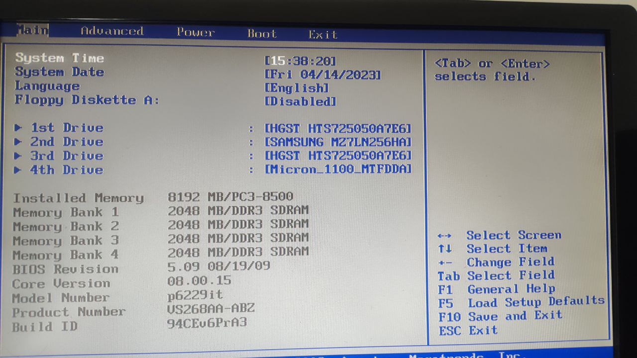

As in the post's title, I'm having the IOMMU always being reported as disabled.
Intel Virtualization Technology is switched on in the BIOS.
I've already tried adding to syslinux.cfg all the following combinations between append and initrd=/bzroot, one at a time. Still no luck.
  • iommu=pt iommu=1
  • iommu=pt
  • iommu=1
  • intel_iommu=on
  • iommu=1 iommu=pt intel_iommu=on
Here are my specs (pasted from unraid):
  • Model: Custom
  • M/B: PEGATRON CORPORATION Eureka3 Version 1.02 - s/n: 101578460001374
  • BIOS: American Megatrends Inc. Version 5.09. Dated: 08/19/2009
  • CPU: Intel® Core™2 Quad CPU Q9300 @ 2.50GHz
  • HVM: Enabled
  • IOMMU: Disabled
  • Cache: 128 KiB, 6 MB
  • Memory: 8 GiB Other (max. installable capacity 8 GiB)
  • Network: bond0: fault-tolerance (active-backup), mtu 1500
  • Kernel: Linux 5.19.17-Unraid x86_64
  • OpenSSL:1.1.1s
  • Uptime: 10 minutes
I attach you the diagnostics ZIP in case someone can help me out.
Thank you in advance!
nas-diagnostics-20230414-1646.zip

Likely to be a second option for VT-d in bios maybe in the advanced options.

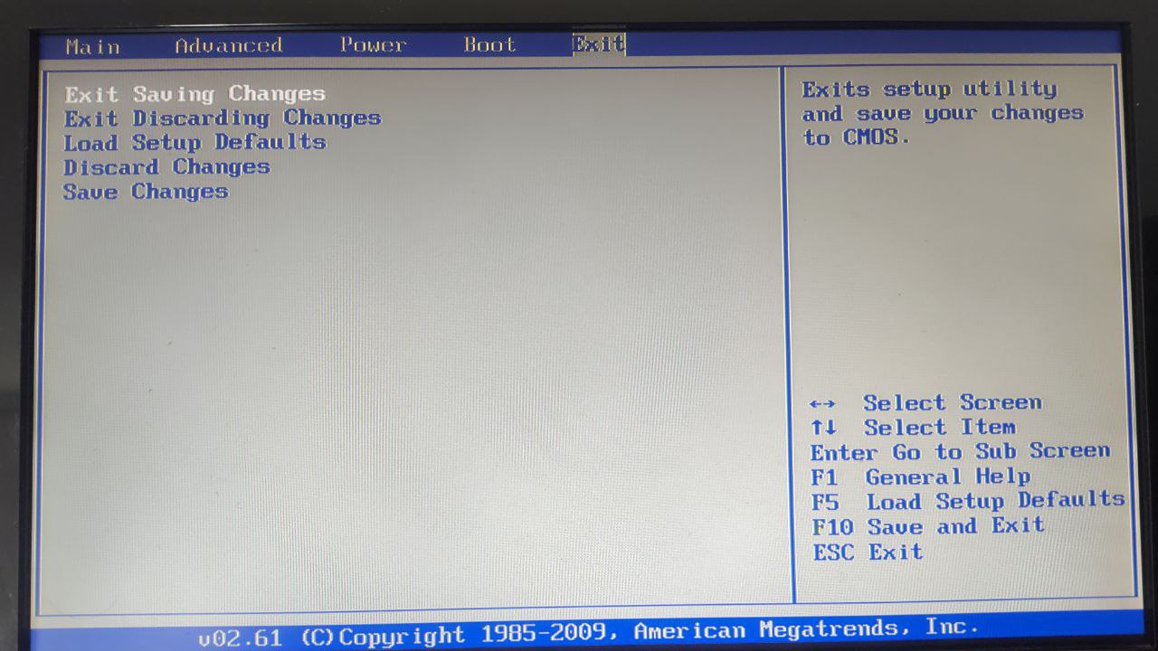

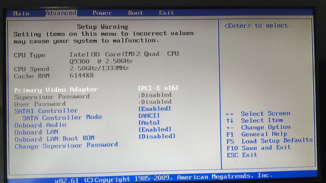

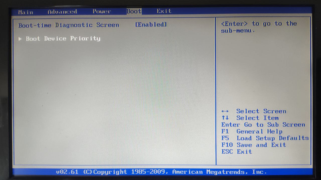

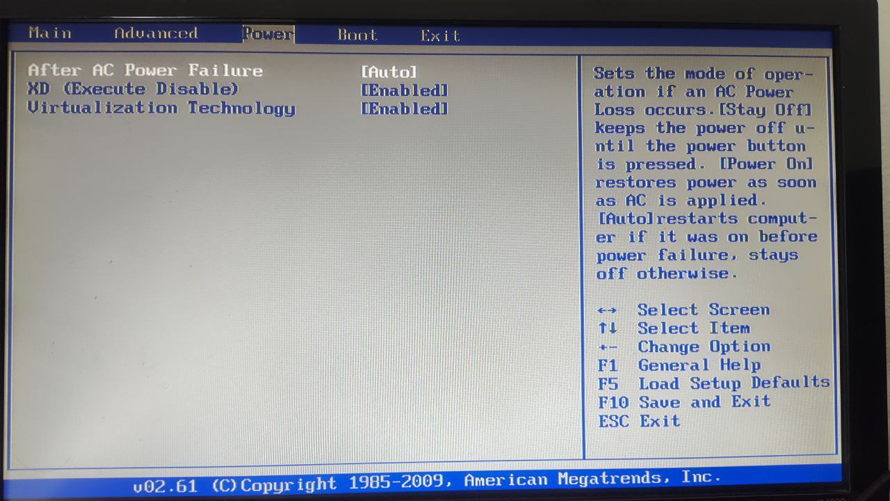

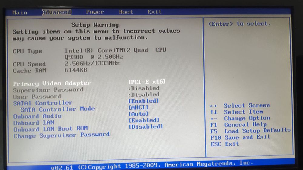

I don't have such option in my BIOS. Here are all my menu screens:
Looks lie the bios does not support Iommu but I cannot find any manuals for board
