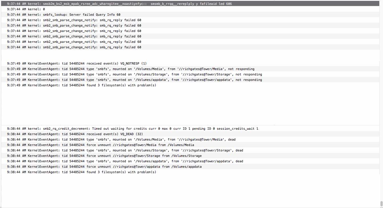

Hi All,
I am running unRAID 6.1.8 and connecting to it via a Mac running El Capitan (10.11.3).  I am using SMB only and am getting "Server Connections Interrupted" messages periodically during file copy operations and then eventually I'll get an error about the file not being able to copy correctly and my mounted drives will dismount.
I checked the console the last time it happened and it showed the following (see attached).
The redacted parts of the screenshot were all related to a CloudKeyChainProxy error I was working on separately and wanted to clear them to make the rest easier to read.  This very well could be a Mac issue, but I thought I would check here and see if anyone has seen anything like this.  I would use AFP, but I need to have access to unRAID via Windows machines and I've noticed that I have some file and folder name issues when I am using both file systems to edit file and folder names.
Any ideas on what I  can check would be greatly appreciated!

Are you using ReiserFS? Are any disks relatively full?
See Need help? Read me first!, you are not giving people much to go on.
I am and yes they are pretty close to being full.  I set them up initially with ReiserFS back when I initially set up unRAID 5.  I have added a couple of new drives with XFS, but don't have enough space to be able to convert the old drives to XFS.  Are there issues with ReiserFS?
ReiserFS is extremely slow on nearly full drives.
