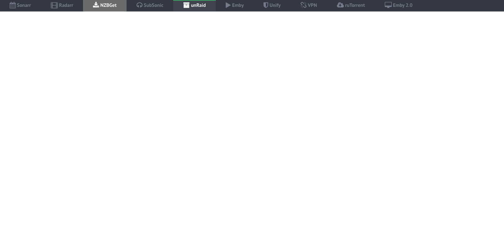

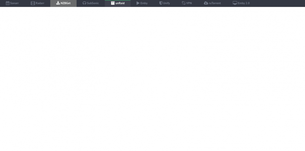

since updating to 6.3.2 I can't get the the unraid dashboard to show in the app anymore. cleared cache and no luck, tried with 2 browsers. having it going to just  http://ipaddress
anyone have any luck with unraid show up?
This is caused by the recent security added in unraid. It's mentioned in the previous page.
Oh sorry, i didn't see it.
Thanks

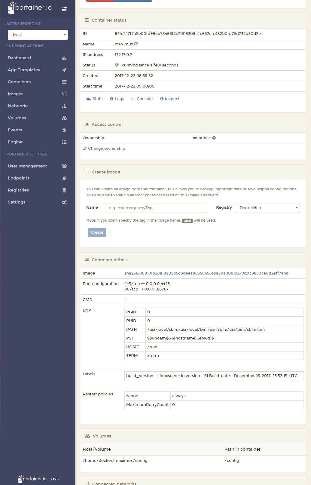

When I install Muximux in docker, I can't connect--keep getting 502 Error with nginx.  I've tried scouring the web, but can't find anything on point.  Can someone help?  I have the same issue with Organizr, whereas HTPC Manager will run (but I don't like it, lol!)
Please post a screenshot of the docker template.
I'm not sure I understand what you're asking--the image is the linuxserver/muximux pull.
I create the container with the following:
docker create \
  --name=muximux \
  --restart always \
  -v /home/docker/muximux/config:/config \
  -e PGID=0 -e PUID=0  \
  -p 6767:80 \
  -p 4443:443 \
linuxserver/muximux
I'm attaching a screenshot of my Portainer screen, which should show variables.  If you're looking for something else, just let me know, sorry if I'm not getting it. (Somewhat noobish, especially to Docker.)
Could it be because my host runs Apache2 instead of Nginx?
