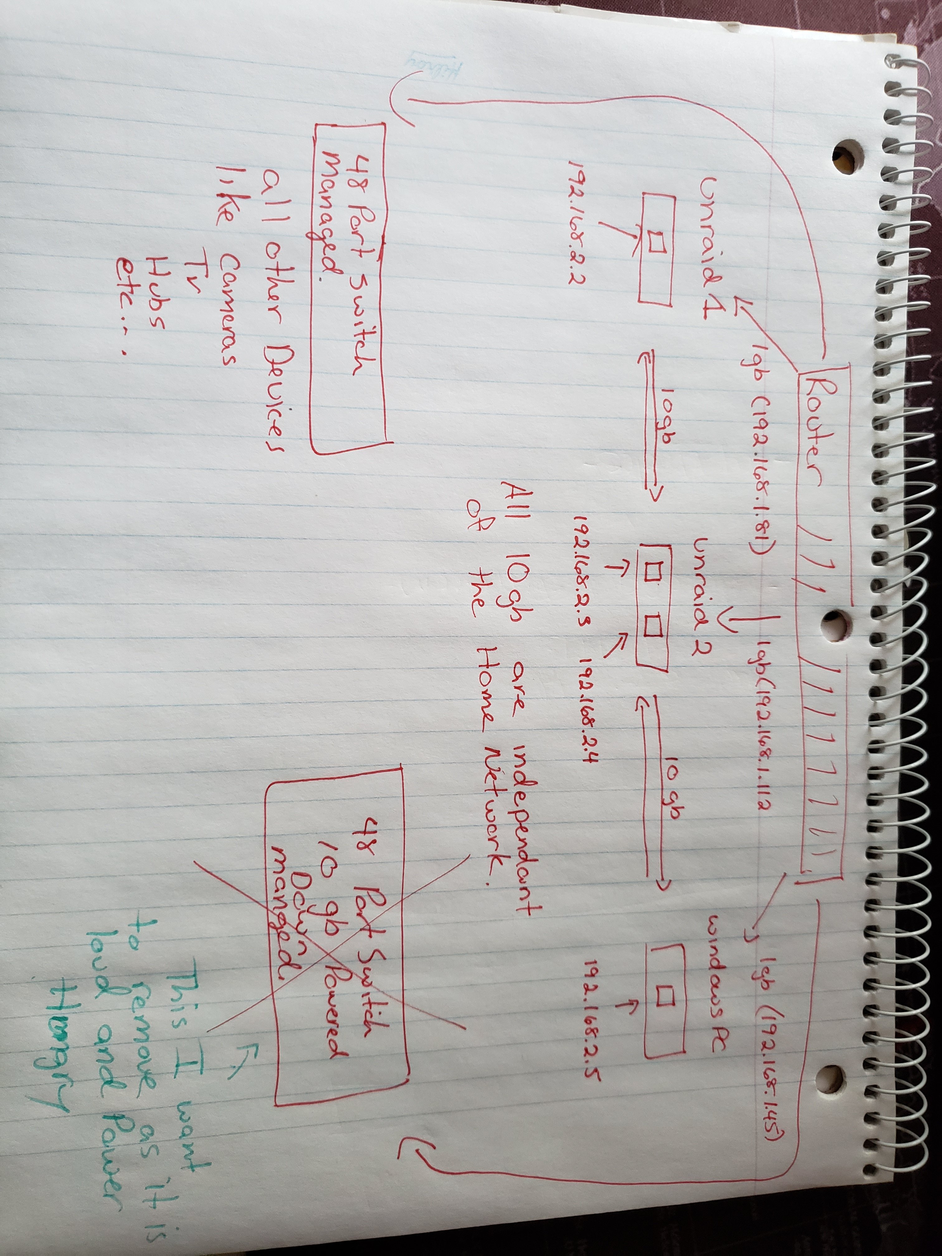

The servers have 2 seperate networks. 1gb is connected to a managed switch and router. 10gb is not. These are direct links, think of it as crossover. Over the 1gb link servers see and can ping each other without issue. The 10gb is direct from port 1 of the 10gb nic in middle server to the 10gb nic on first server. Port 2 on middle server is connected direct to 10gb port on windows machine. Windows to middle server works without issue. However middle server to first server does not. This is where I need a solution. 1gb is 192.168.1.0 255.255.255.0.
10gb is 192.168.2.2, 192.168.2.3, 192.168.2.4, 192.168.2.5 no gateway no subnet direct link.

I am  not a networking Guru but I think you need to provide a couple of more items.  First, is the Diagnostics file   Tools    >>>  Diagnostics    and second, a drawing of your networking which shows pictoritally what you are attempting to describe above.  Be sure that you show all connections, IP addresses, link speed, servers and switches.
hello Frank1940, this is not a diagnostics issue, it is not an issue with the servers or a configuration issue, it is the lack of a configuration that i need to figure out.
my network is setup like this starting from first server and router.
cisco 8port router. port 4 to onboard nic on first server unraid1 ip address is 192.168.1.81 this is the default port for webgui, docker access, truncated vm access using the internal routing in unraid. all my apps and things are router a 172.x.x.x ip. my second server is unraid2 connects to port 6 on my router with ip 192.168.1.112 this is the server that is new. Then windows pc is 192.168.1.45 on port 2 of router. This is all irrelevent as all 3 systems see each other without a problem however 1gb is slow.
unraid1 array 1gb ports                                                                     unraid2 main workstation                                          windows workstation
default 192.168.1.81        192.168.2.2 10gb port           -------->  192.168.2.3 10gb port unraid2 , 192.168.2.4 10gb             ----- >     192.168.2.5 10gb port
docker 192.168.1.82                                                                vm  192.168.1.134                                                                    192.168.1.45 1gb windows ip
docker 192.168.1.83                                                                vm  192.168.1.132
vm       192.168.1.84                                                               default 192.168.1.112
everything with 192.168.1.x is all part of my home network all ip are assigned static
everything with 192.168.2.x is not part of any router/switch. These are straight through to each other unraid 1 has a single mellenox x3 10gb nic with a 25m cable to port 1 on a dual intel x540 10gb nic on unraid2, port 2 goes to windows pc with mellenox x2 10gb port.
windows recognizes unraid2 on 10gb and i can map shares to runaid 2 only(by design) i cannot get unraid 2 to mount a share from unraid 1 through 10gb only 1gb. i would like to use samba or nfs to mount a media share on unraid 1 to unraid 2 for my dockers to access using 10gb. what script,commands,routing or network wizardry can i do to make nfs or samba see the shares using these ip addresses for 10gb

And according the picture attach, Unraid2 have dual port in two 192.168.2.x IP in same subnet, that will be problem. Assume they are a dual port NIC, but this not means they are inter connected. ( As I know, dual port NIC can connect in hand by hand to eliminate extra switch, but this should need some configuration to work ).
You should try setting Unraid1 to Unraid2 in 3rd subnet.

I have done this, just now. had to reboot my server and waiting to try connection. Ive tried to confirm all settings are set correct for smb and nfs sharing as well. i will try now with 192.168.3.2 and 192.168.3.3 for unraid 1 and unraid 2 then 192.168.2.3 and 192.168.2.4 for unraid2 and windows.
Next you could try bridge 2 10G port in Unraid2 in 192.168.2.x
