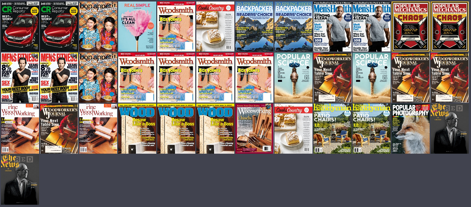

February 28, 201610 yr Application: MagRack Docker Hub: https://hub.docker.com/r/magmpzero/magrack/ GitHub: https://github.com/magmpzero/docker-templates ScreenShot: Overview: I wanted to create a lightweight and simple application to ease the pain of reading magazines that I have downloaded. For that reason, MagRack was born. I normally browse my network share and then download the pdf I want to read. This is a total PITA. I decided to start work on a magazine application that will make it easier for me to read the ones I want. What it does: Scans a directory of your magazines and creates a wall of preview images. You can then click on the cover image and the magazine will open in the default PDF viewer for your device. The magazines are sorted based on newest first. What it doesn't do: It doesn't download anything. This is simply a tool to make reading your magazines less of a pain. I assume you already have automation set up for downloading magazines via RSS. How it works: When the WebUI is hit, it scans all of your magazines and creates a preview image if one doesn't exist. It then sorts based on modified and creates a display wall. For this reason, the first time you load the page, it can take a few minutes depending on the number of magazines you have. How to use it: mount your magazine directory at /mags. MagRack expects to have a subfolder for each magazine. When you hit the http://address:4567/mags it defaults to only show the latest 10 magazines. If you want to show 100, for example, you would use http://address:4567/mags/100 Anyway, I put this little program together overnight and I really enjoy using it so far. Thought I would containerize it and offer it up for others to use.

March 15, 20179 yr I have been using Linuxserver.io docker of LazyLibrarian to automate download and postprocessing of magazines. Once I got the folder options set up right it works great. If you need more info on how I set this up, let me know. I wouldn't waste any time duplicating the automation already in LazyLibrarian. The viewing part was what I was having trouble with. I couldn't get Calibre configured to work really well with magazines. I love Calibre for books but not magazines. So far in my testing, Magrack has been awesome for magazines. It makes viewing them so easy. My main suggestion is change it so it shows each cover accurately. Right now if I have 3 issues of a magazine, they all get the same cover, and its not necessarily the newest one. Also a way to sort them would be nice. (Name, Issue Date, Date Added) If not that, then do what mgworek said and only show the newest cover for a magazine and then once you select it, it shows each issue for that specific magazine. Thanks for the work you are putting into it! Edit: Just noticed this is almost a year old but hoping development is still happening Edited March 15, 20179 yr by boyer411
March 27, 20179 yr On 15/03/2017 at 7:41 PM, boyer411 said: My main suggestion is change it so it shows each cover accurately. Right now if I have 3 issues of a magazine, they all get the same cover, and its not necessarily the newest one. Also a way to sort them would be nice. (Name, Issue Date, Date Added) If not that, then do what mgworek said and only show the newest cover for a magazine and then once you select it, it shows each issue for that specific magazine. I think this is because you have a sub-folder with a magazine title and then sub-sub-folders with each issue. If you have a sub-folder per magazine issue then it will display the cover for each one correctly. i.e. /magazines/customPC/issue1 - displays 1 cover for all versions /magazines/customPC-issue1 - displays correct cover EDIT: i'm not sure if this is the authors intent for the folders organisation, just how I have noticed it will work in order to display the correct images. Edited March 27, 20179 yr by Ashe correction
March 28, 20179 yr Hmmm. Inside my magazine folder I have a folder for each actual magazine title. No sub folders for each issue. I see a cover for each magazine title but not a new cover for each monthly issue. my folder structure is: /magazines/Wired/aprilissue.pdf /magazines/Wired/mayissue.pdf see attached...

March 30, 20179 yr So I figured out what I needed to do to get each issue to display properly. Each issue needs its own folder under the Magazine top folder. That's the only way to get the program to autocreate a thumbnail for each issue. So for me it looks like. /magazines/Wired_2017-04/2017-04 - Wired.pdf /magazines/Wired_2017-03/2017-04 - Wired.pdf The biggest downside is that it will end up being a huge number of folders with no real folder structure. but the thumbnails all show up properly so i'm happy. I was also able to change Lazy Librarian to auto create my folders this way.
March 30, 20179 yr So I figured out what I needed to do to get each issue to display properly. Each issue needs its own folder under the Magazine top folder. That's the only way to get the program to autocreate a thumbnail for each issue. So for me it looks like. /magazines/Wired_2017-04/2017-04 - Wired.pdf /magazines/Wired_2017-03/2017-04 - Wired.pdf The biggest downside is that it will end up being a huge number of folders with no real folder structure. but the thumbnails all show up properly so i'm happy. I was also able to change Lazy Librarian to auto create my folders this way.Yes that's it. Works great then but a bit annoying for folder organisation !
