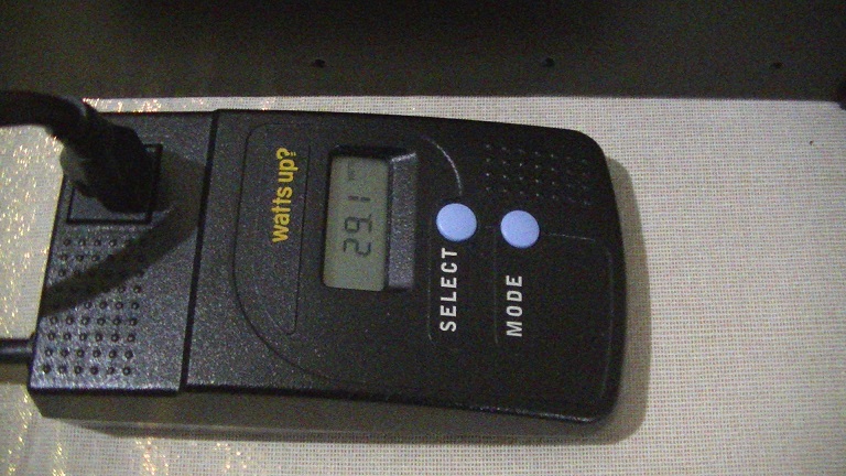

Power Consumption:
  idle (all drives spun down): 29.1 watts
  reading (only one drive spun up): 35.0 watts
  writing (only two drives spun up): 46.5 watts
  all drives spun up: 58.2 watts

Wattmeter showing idle power consumption.

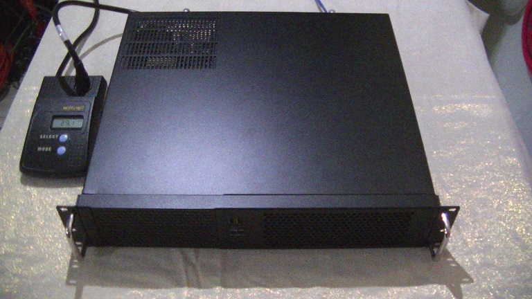

Top-front picture of server (and wattmeter).

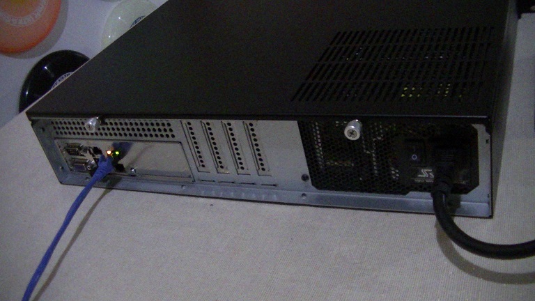

Rear view of server.

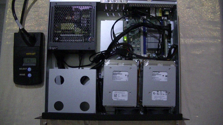

Inside of server.

EDIT: the wattmeter is now showing 29.0 watts, with the occasional dip to 28.9 watts.

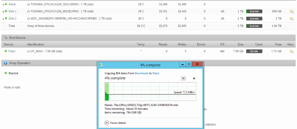

When writing a large file, like 20-30GB what do the write speeds start at and finish at? I always try to increase my write speeds but eventually gave in and without a cache drive writing to the array is as good as it's going to get. Here's my results when doing a 31GB write to the array. I also like your system. Must be very quiet.
I have 64GB of memory and the copy slows down around %23. But I do have a couple VM's running at all times as well. I know there was extensive speed testing on the Seagate Archive drives. Are you able to perform a speedtest.sh?
Thanks.
My write speeds started and stopped right at full GbE speeds (~112 Mb/s), on the 18GiB file I used to confirm that my "RAM cache" idea was working (previously it had dropped to ~60 Mb/s early into the copy, as you report).
Haven't heard of speedtest.sh, and a search didn't reveal anything.
I'll get you a screenshot of a 20GiB file write later tonight.  Probably 30Gib would just push past my dirty_ratio.
I suspect you haven't increased your dirty_ratio past the 20% that it comes at stock.  I'm using 75%.
This curve wasn't nearly as flat as the one I got for the 18GiB write, but it should serve the desired purpose.
That's a 24GiB write, getting 60% through at pretty close to maximum GbE speed, then it starts to waver, not really sure what that's about, but it's definitely not due to running out of cache before the end of the write.

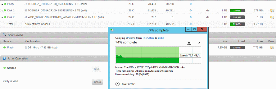

I just wrote a 39GiB file to the server and captured the progress.  There is a fair bit of "wavering" starting at 10% into the copy, but the speeds still stay well above disk-write speeds (including parity overhead) until 90% into the copy, where it finally drops to the mid-40MB/s range.

Very nice. Thanks for performing a test. So the average max speed of one of those Archive drives without a cache drive writing to the array would be 40-60MB/sec. Agree? I'm wondering if you had a faster parity drive - not the inexpensive Seagate model - you maybe would see beginning write speeds at 110MB/sec?
I used that MD WRITE command and got 111MB/sec for the entire 31GB file copy.
For that write, the target drive was nearly full.  So the mid-40MB/s range represents the lowest speeds these drives can be written to (including parity overhead).  I had estimated 50MB/s in my initial post, so I wasn't too far off.  That estimate was based on seeing ~60MB/s when writing to a 5/8 full drive.  I still estimate ~80MB/s for a nearly-empty drive, although I don't have one installed to test.  So just using very round numbers, averaging a low of 40MB/s with a high of 80MB/s will yield 60MB/s; that's my current best-guess "round number" on an average write speed with these drives.
In my experience the parity overhead creates *at least* a 2x reduction in write speed.  So to get 110MB/s of "actual" disk writing speed (not counting any caching benefit), you'd need at least 220MB/s native write speed for the drives involved . . . not just the parity drive but the target data drive as well.  I suppose a 7200RPM version of the these drives could hit that, at least on the outer cylinders, but I doubt that the inner cylinders could be written with that kind of speed: 7200RPM is about 22% more than 5900RPM, so "all other things being equal", having observed numbers just over 200MB/s during parity check/syncs, that's around 244MB/s when sped up to 7200RPM.  Again "in my experience", the inner tracks take a 2x hit on speed compared to the outer tracks, so that's 122MB/s, divided again by two for the parity overhead is something more like 60MB/s.
Note that I do see ~112MB/s at the start of my writes, and for "sufficiently small" files (limit seems to be around the mid-30GB mark), that speed persists throughout the copy (notwithstanding the wavering that occasionally drops it into the 80-90MB/s range), due to the large amount of memory I've made available for cache (24GiB).
