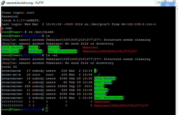

Good afternoon,
I rebooted my server this afternoon, and after it came up, I decided to create a user share called "UnbalanceTest".  I went through the usual steps of creating the share, noticed that it was visible in the webgui and then went on to start my VM.  Unraid gave the warning that my image file was missing...so I went to main and noticed that my cache drive was unassigned.  I have had the issue in the past where assigning drives in chrome resulted in the changes not being saved, so I opened firefox, stopped the array and assigned the cache drive, I then noticed that my user shares were missing.  I started and stopped several times to see if they would be read from the disks and return and they did not...so I telneted into the console and browsed to the /mnt/user share and typed ls and I got an error saying that the file structure needs cleaning.  So, I shut unraid down, pulled the flash drive and did a chkdsk and no errors were found.  I then restarted and looked at the syslog and see the errors regarding corruption on disk5.  I am attaching the first syslog (don't have full diagnostics..I am thankful for the syslog generated by powerdown).
I also browsed to disk5 and typed ls -al and I can see a folder named "Unbalanc" in red letters (please note that this does not match my first sentence in this post)...there was also a second folder named "Unbalanc\033\004\210\377\377
Any suggestions on how to proceed?
Thanks,
Dan
Added screenshot of ls -al of disk5

You don't say what command you actually ran. It checked the filesystem and says what it would have done to fix it, so you need to run it again with the appropriate flag set to allow it to effect the repairs.
I ran with the -v option.
Here is the output of the actual repair:

Once the repair completed I stopped the array and restarted it normally  (i.e. not in maint mode).
User Shares returned and it looks like I am allset.
Coincidentally, in the lost+found directory all the missing files from running unbalance to move files from disk7 (now removed from my system) to disk5 are all here.  So there must have been some corruption issue on disk 5 that caused issues with unbalance.
Thanks to all that helped!
Dan
