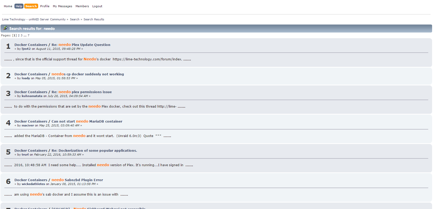

I cant revise my opinion, I see your screen shot looks lice and clear. heres mine
That's a screenshot of the forum.  Mine is a screenshot of the Unraid webui with the Community Application plugin installed.  When you click on a docker container to read the description it gives you a link to the support thread.  :-\

The screenshot was an attempt to show you how a search will not help me find the specific location to post in this situation.
